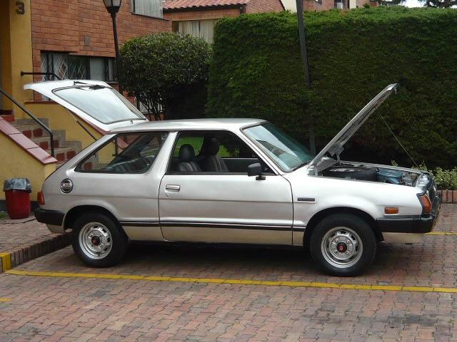

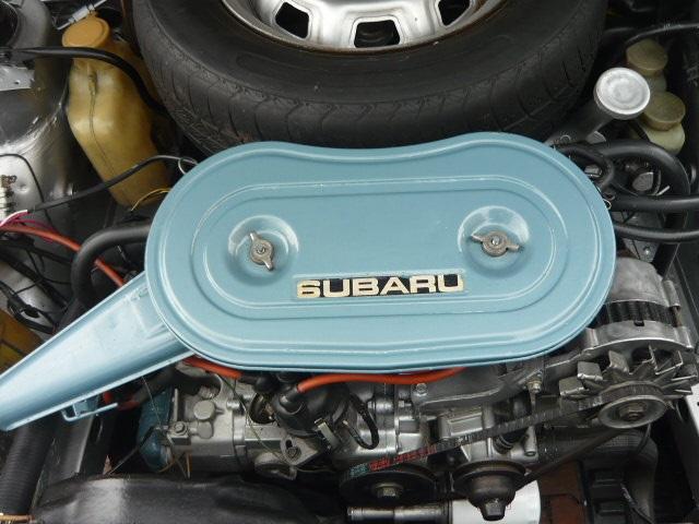

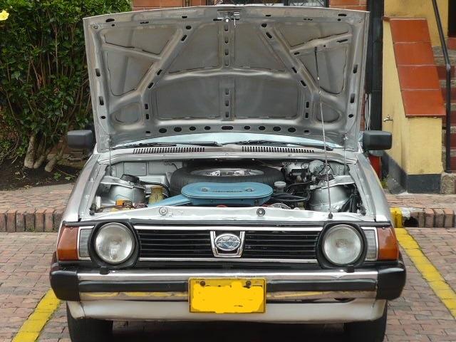

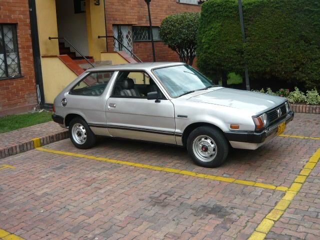

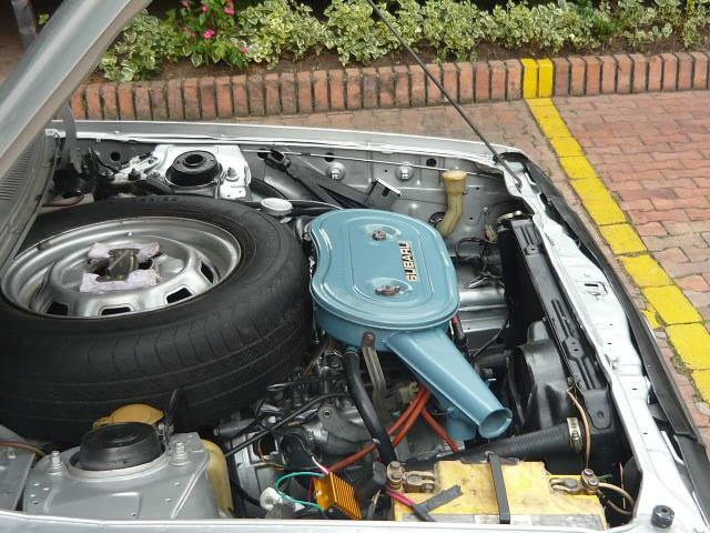

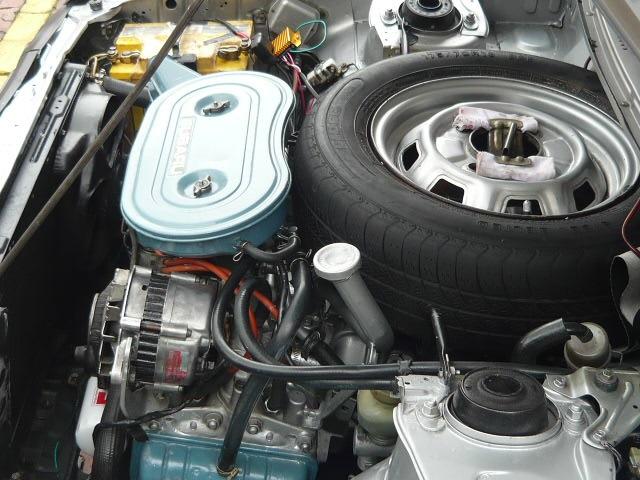

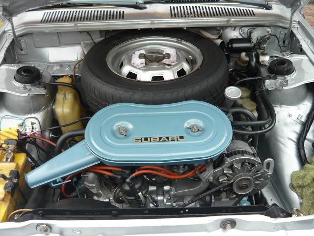

Hi...... sorry to keep mentioning this.  But pleas keep in mind.   I had a Generation II 1986 GL  2WD 1.6 EA 71 which was considered a '84 crossover and a Generation II '89 DL 1.6 EA71 with the round headlights.  After doing a little research yesterday was a '80 crossover.  These were U.S.A models.  Very strange.   So anything is possible.  I currently have a Generation II dual carb model! Which looked like my '89 model.
