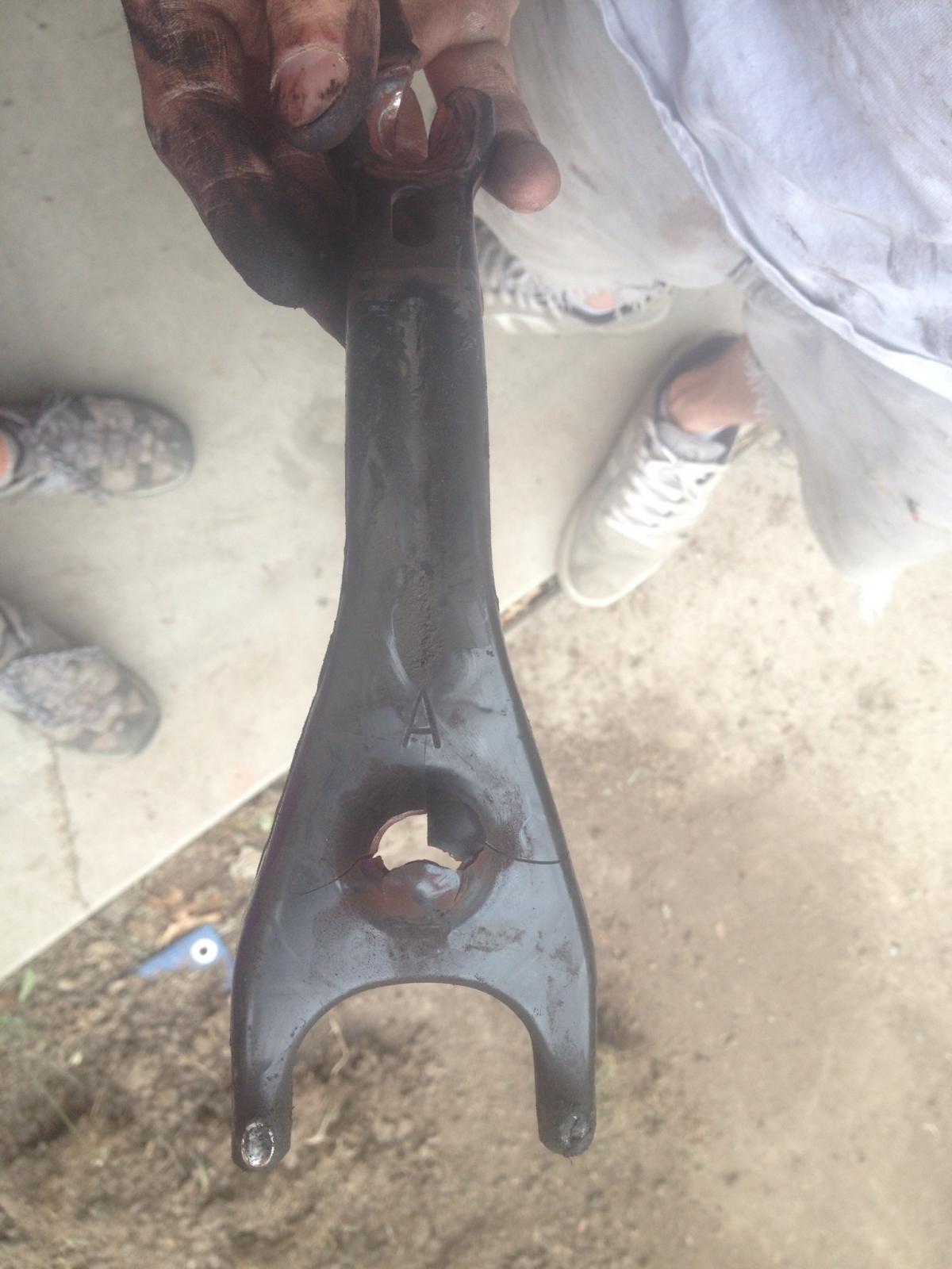

Without disassembly, it's impossible to tell, but I suspect that there's an issue with the clutch fork (there's a pivot ball inside the bellhousing which the clutch fork pivots on... the metal actually wears through and the fork can bend... which would explain your temporary reprieve when you tightened the cable.) Could also be the throwout/release bearing, or a faulty pressure plate. You'll probably have to separate the engine and trans and inspect everything carefully. (Or just do a complete clutch kit, fork and cable....)

I would guess the release lever (fork) is cracked and is not pushing the release lever far enough to release the pressure plate.

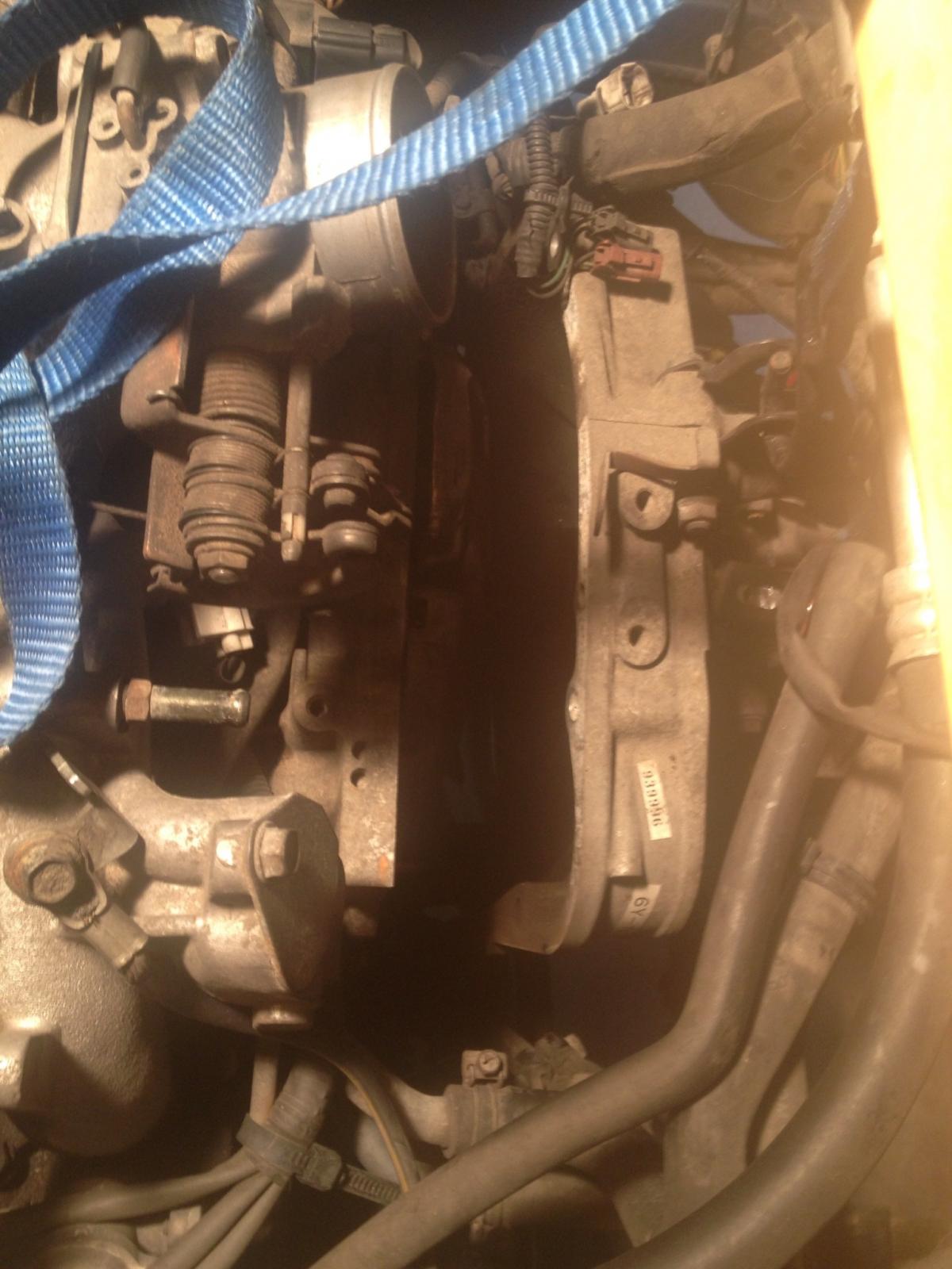

How far apart will I have to separate the engine and transmission in order to replace the fork? Can it be done without pulling the front axels?

Possible but hard.  With the long studs, it's possible to pull the drive shaft remove all of the bolts and nuts holding the trans to the engine and frame and then slide it back.  Your are now working in a 2 - 3 inch gap.  If it drops down off the studs, it will hit the cross member of drop all the way to the ground.
Better just to pull the engine or trans I think.

Posted 15 June 2013 - 12:03 AM
It can be, just use a ratchet strap or come-a-long to hold the front of the trans up. You'll still need to unhook shift linkage, exhaust hanger, rear driveshaft. You'll be almost to the point of removing the transmission anyway.
I did the clutch in my '99 forester not all that long ago and went the route of pulling the trans, without actually pulling the trans.  That is, I went through all the steps, but instead of actually droping it, I did as Fairtax suggests and suspended it with some tiedowns which helped a lot and made things go back together much easier,

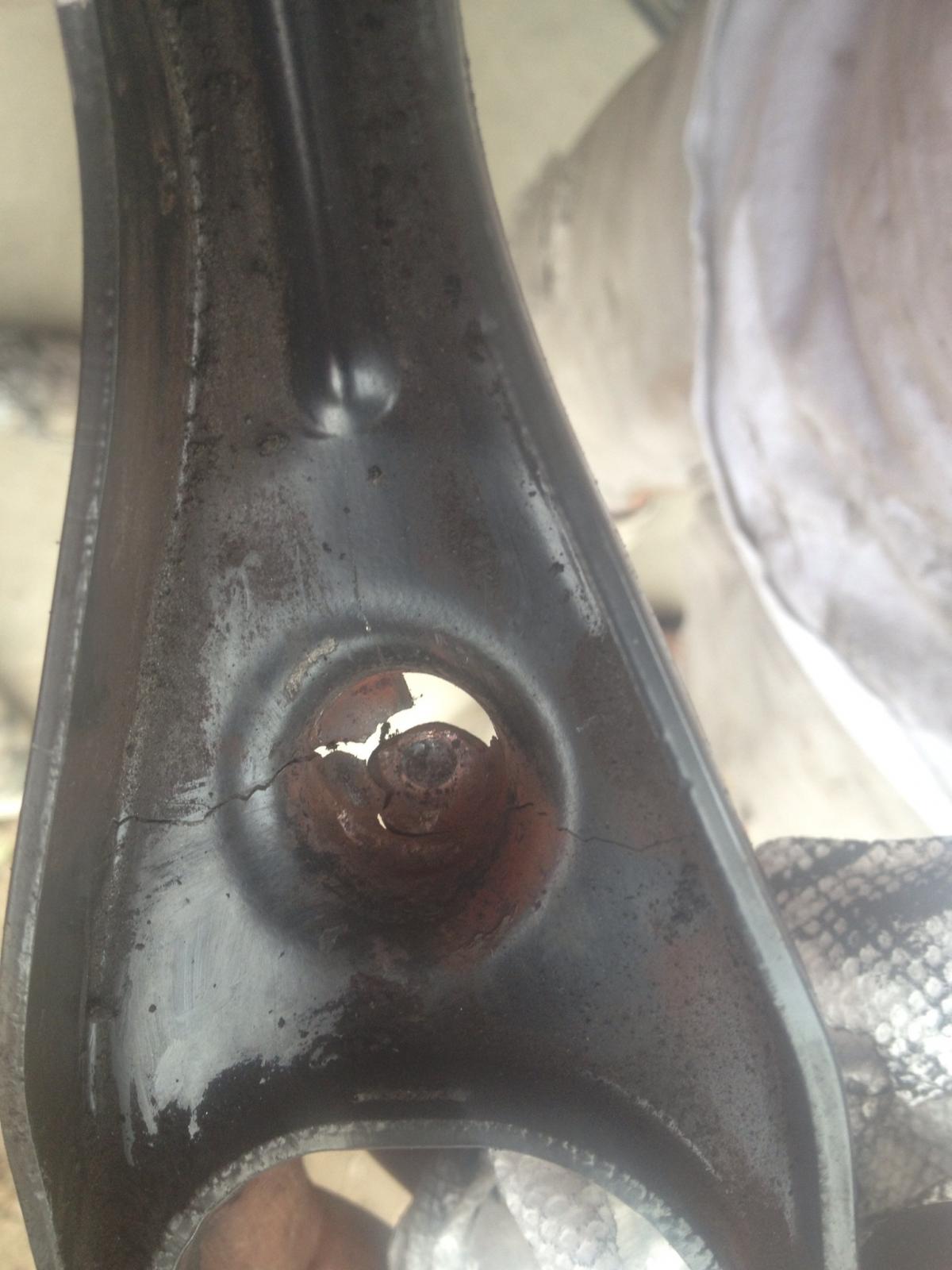

#9 OldBlue97
OldBlue97
    Newbie
  • Pip
  • 3 posts
  • Westminster, CO
Posted 16 June 2013 - 08:53 PM
Project complete! Thank you everyone for the help. As you can see from the pictures it was absolutely the clutch fork. Everything is back in working order and running great!
