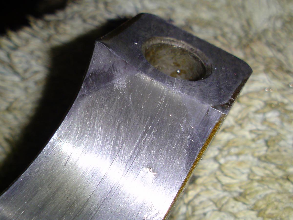

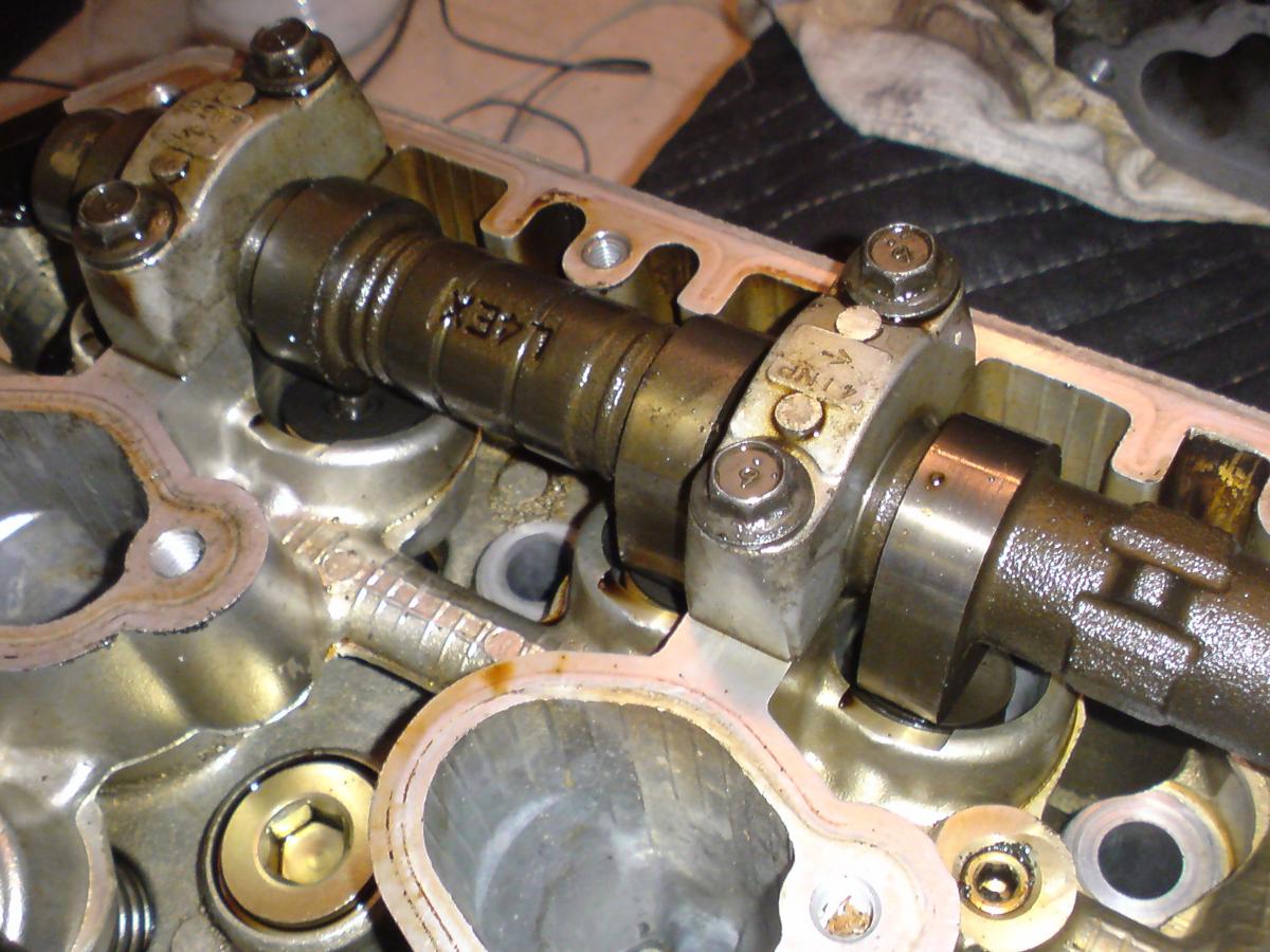

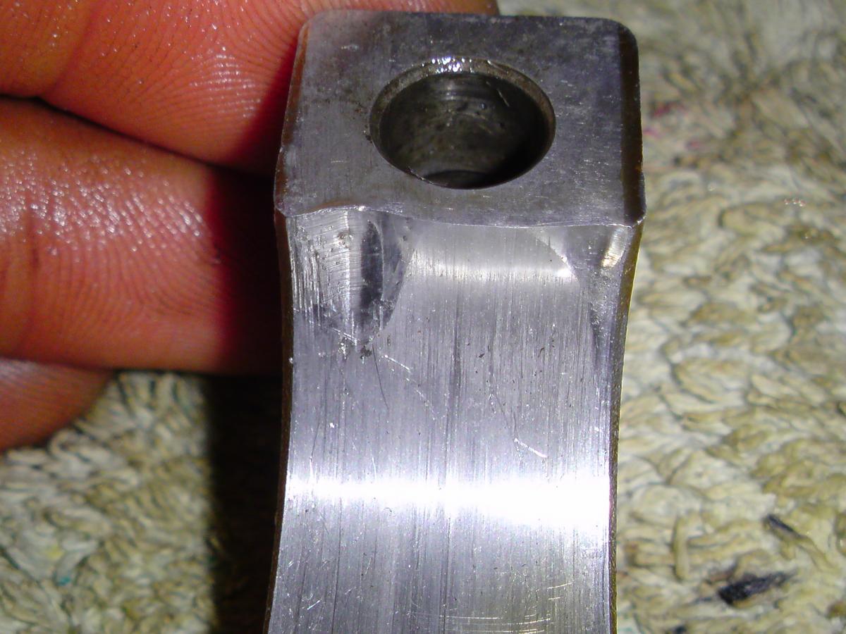

So no one ever says but what bad could come from this? This one I have here on the stuck one is so badly messed up it seems it would do more harm then good then just using another cap off another car. Looks like something happened to it when they took the heads off.

The caps are machined on the head. Using another cap is a crap shoot because the machined bore may be off center of bore on your head. You might need to try several caps to find one that the center lines up correctly.
Oh yeah, the bad that would come from it...
The cap being off center would leave insufficient clearance for oil on one side, and excessive clearance on the other side, so basically there would be a step in the bearing bore. That would dig into the cam as it is spinning, assuming there is enough clearance for it to spin at all. The excessive clearance would also bleed out oil pressure meaning the other side of the cam bearings would starve for oil, overheat, and seize.

I noticed that just turning the cam in my hand with the cam cap in the other one side got more oil then the other and in the end it just flicked the oil out because of the way the current cam cap is. it's worth a try anyways
I'm not getting another set of heads.. I already spent $215 for this and it's missing a bunch of stuff inside...

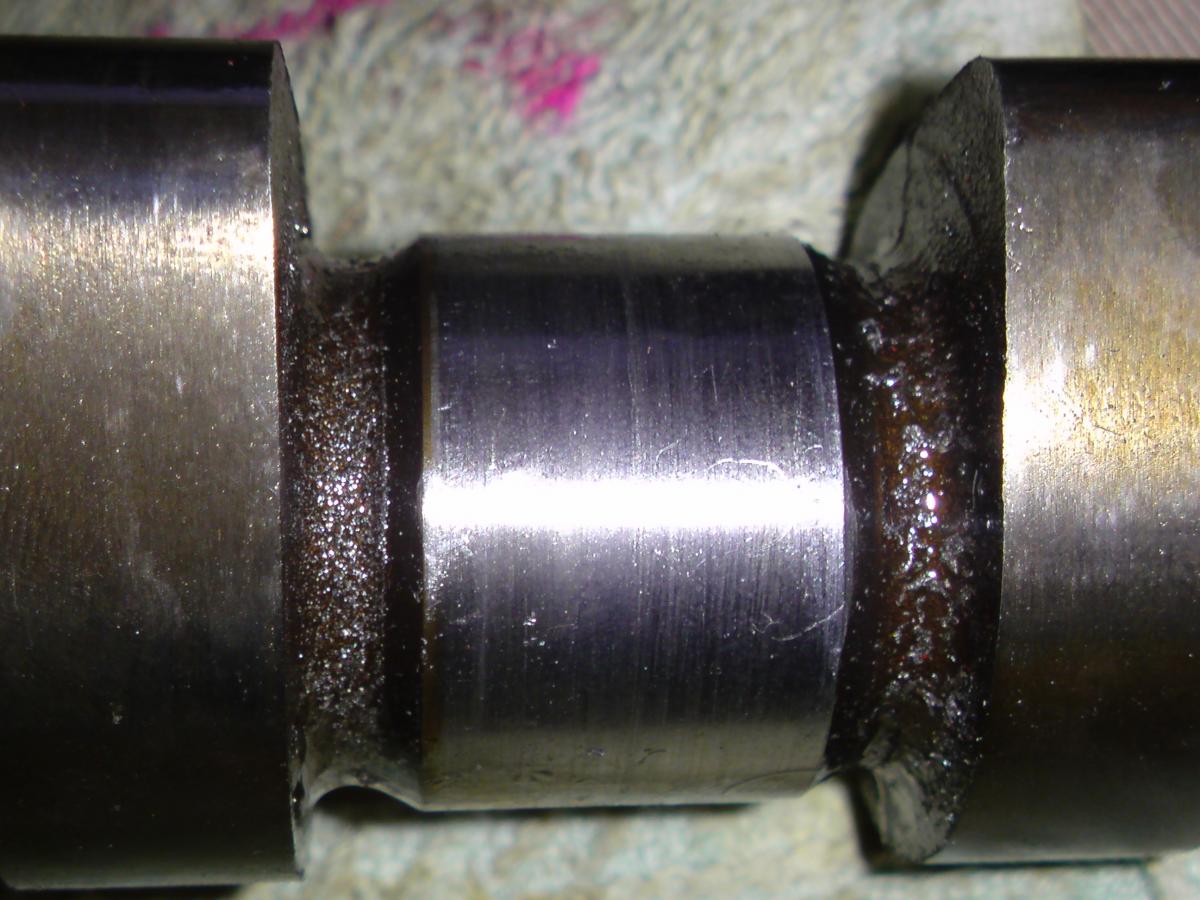

Hmmm what the hell.. I don't remember my cams looking like this when I did my HG's
