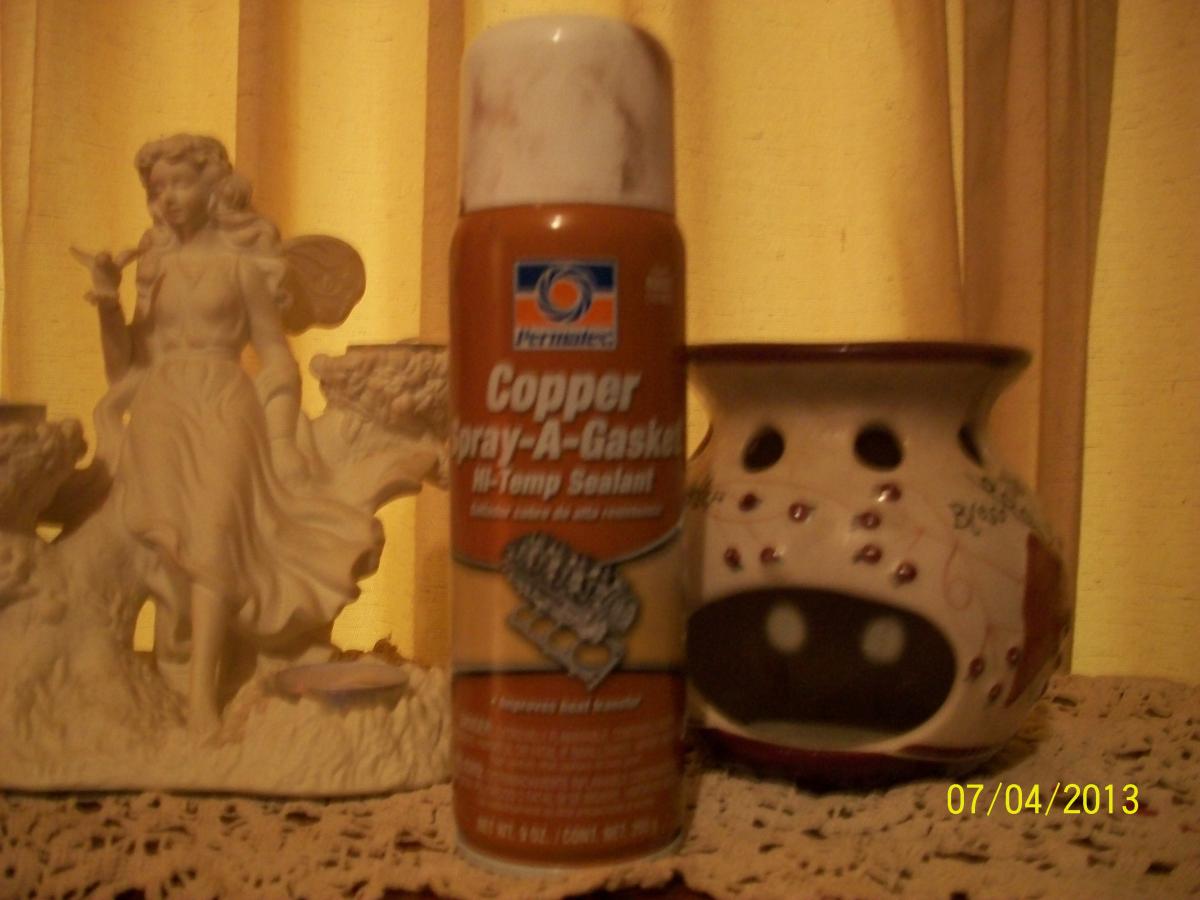

This is what I used.

That is RTV silicone. Just in a convenient spray can.
Some engines that type of sealer is helpful. On Subarus it is not helpful, and it causes failure of the head gasket.

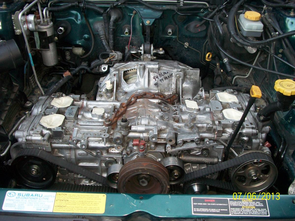

Here's a question for you. I got it in (finally) and as you can see I placed masking tape over the openings to keep nuts and bolts and stuff out. I put a 22mm socket and ratchet on the front crankshaft bolt and turned it over (clockwise of course) several times and I'm observing the masking tape puffing upward on the various intake ports (convexing) and then sucking downward (concave) as the pistons travel up and down in their perspective bores. Is the convexing normal (upward pressure of air) or is the engine out of time? :huh:

which marks did you use to time the engine?

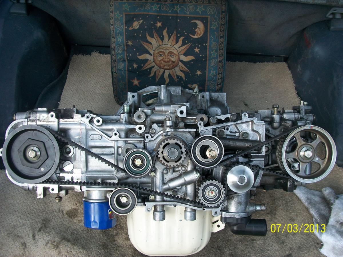

Posted 07 July 2013 - 02:11 PM
There's a pic of it back on #34.

Posted 07 July 2013 - 02:42 PM
it's a little difficult to tell 100% but it looks like the triangle on the outer side of the timing cog is pointed at 3 o'clock, if it is then cyl 1 is not at tdc like it should be. I noticed that problem with my Haynes manual timing instructions when I was rotating a short block yesterday after putting pistons in it.

So where else can the triangle point? Correct me if I'm wrong but I believe my timing is dead on.

Posted 07 July 2013 - 03:22 PM
it's the triangle on the timing gear that needs to point at the notch on the oil pump from what I saw yesterday, it's been a while since I've actually timed an ej but it's easy to be confused by some of the manuals on the market
I'm going by the vids on Utube showing timing belt replacement on the EJ22.

Timing is not set at TDC because the cams are loaded and it is very difficult to keep them in proper position.
Timing is done with the crank 90 degrees off TDC and the cams 45 degrees off. This sets the cams in a position which they will stay without needing a special tool to hold them. It also sets the pistons at half stroke, which helps avoid piston to valve interference.
The pushing up of the tape on the intake ports is normal due to the timing of the closing of the intake valves. The valves are still slightly open as the piston begins to move up on the compression stroke. When the engine is running this overlap improves efficiency by allowing more time for air to enter the cylinder.
