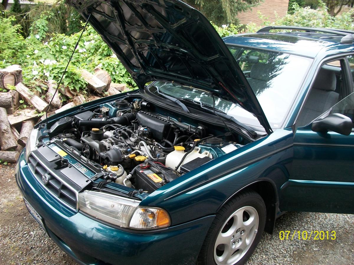

Posted 10 July 2013 - 10:08 AM
I adjusted the two intake lifters on #3 back to .020 and it fixed the tappet noise. I put a new filter and fresh oil in it and I must say it sounds as good as a new car. I checked Kelley Blue Book and they value it at around 3,800 in "fair" condition. I am a little concerned (in its present state) with only the four out of eight bellhousing bolts holding the engine to the transmission. I'm not going to the dragraces or offroading though so it should be o.k. It is still an interference engine? Correct?

Posted 10 July 2013 - 12:45 PM
Subaru used 4 bolts in the bellhousing for every engine they made since like the late 60's. It will be fine.
The question of interference with phase 2 heads on a phase1 2.2 block has come up a few times and as far as I know there hasn't been any solid evidence that it is not interference. The pistons in that block have reliefs for the valves, but the reliefs were designed for the valves in the phase1 heads. The phase2 2.2 heads increased valve angle from 15 to... I wanna say 20 or 22 degrees. Which makes it so the head can be shorter (overall height off of the deck) but it also increases the depth (down into the cylinder) of the edge of the valve when its open.
I would just assume it to be interference just to be on the safe side. Unless you want to pull the heads and clay the pistons to determine valve height above the piston.
