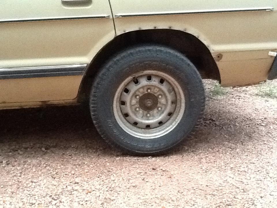

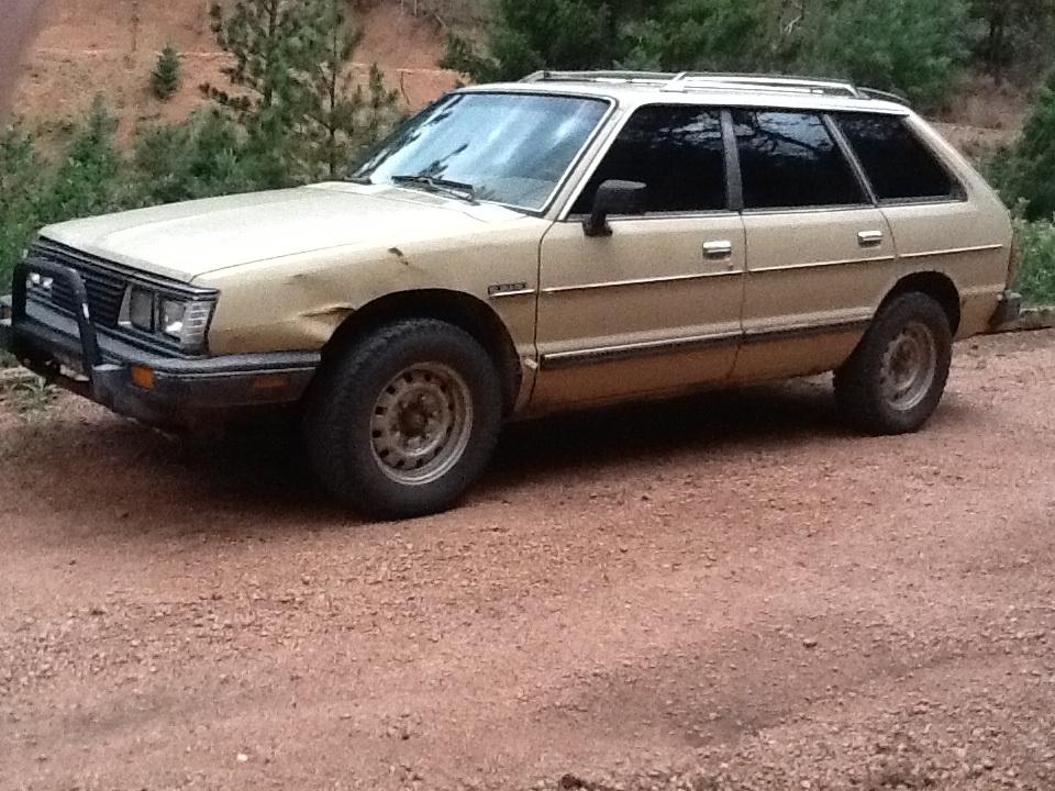

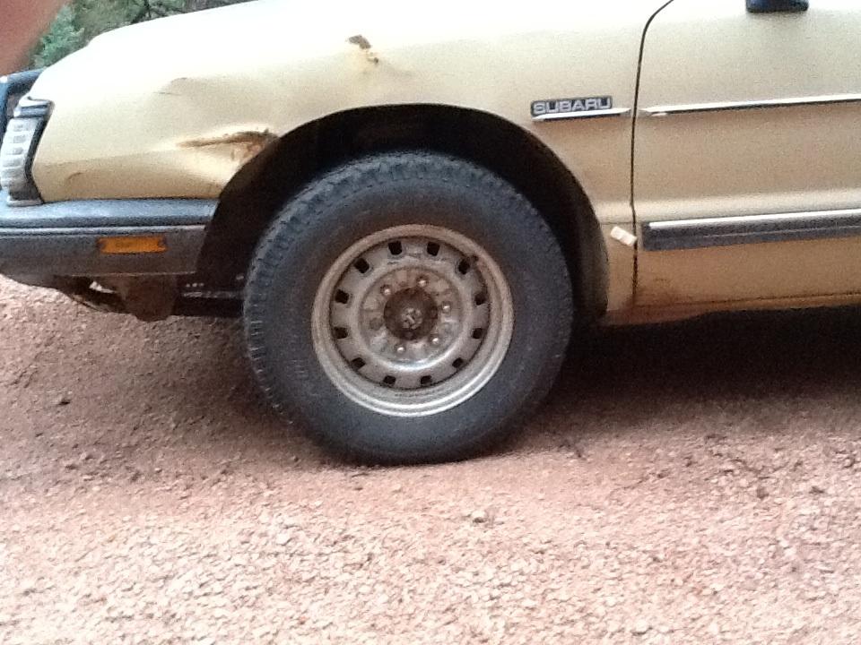

On my 84GL Im currently running 195x75-14s (25") with no lift. I cut quite a bit out of the fenders...3" in front, and 1.5" in the rear, cuz im using isuzu wheels which have a lot less offset, plus I like to be able to use tire chains so i needed a bit more room. Doesnt ever rub, even when I say, " hold my beer and watch this!"
Once these tires are toasted, im going to put on 215x75-14 and i dont anticipate any rub then either. post-25891-0-15760000-1373249833_thumb.jpgpost-25891-0-11338800-1373249858_thumb.jpgpost-25891-0-36192200-1373249915_thumb.jpg
