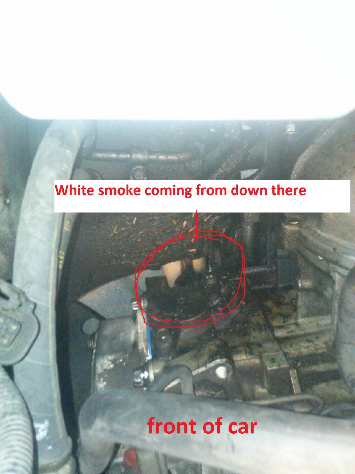

Hi there, I've only owned my Subaru (92 legacy L-EJ22) since the end of April and I love it! But now its sad  :(
Had a small oil leak which I figured was the valve cover gaskets. In the process of changing them I made a VERY dumb mistake and loosened my head bolts inadvertently. I tightened them back up to spec, went ahead and did the valve gaskets, plugs and wires, and changed the oil.
I now have smoke (steam?) coming up from under the passenger side head and A LOT of white smoke coming out of the exhaust. Didn't see any bubbling in the reservoir but I might have just missed it.
I have the gut feeling that I need to do the head gaskets and wanted some input.

White smoke from where? Tail pipe or under the hood?
Its common for oil to run down the bottom of the head and drip onto the Y pipe when changing valve cover gaskets. Once the engine is started and the pipes get hot the oil burns off and makes lots of white smoke.
You must have been pretty determined if you loosened the head bolts. Those are breaker bar territory with a 14mm 12 point socket. Did you loosen all 6? How far did you loosen them?

It comes from the tailpipe and under the hood.
I was determined,the haynes manual illustration showed 6 bolts to the valve covers so when I saw the 6 bolts in the car...........
All the bolts on the passenger side were completely (hand loose) loosened and the left and middle top on the driver side I had barely broke loose.

Just noticed the picture you added. That brown rusty looking thing down under the engine is the right half of the Y pipe. Basically the exhaust manifold on these cars. Some smoke from that area is normal after changing valve cover gaskets.
You really might just want to let the engine warm up and see if the smoke clears before pulling the heads off. If the smoke doesn't go away its because its still leaking and then you would want to look more seriously into head gasket replacement.

Oil burning off of the manifold or pipes should be a light grey color, which often looks white.
Black is diesel, kerosene, lamp oil, etc.
