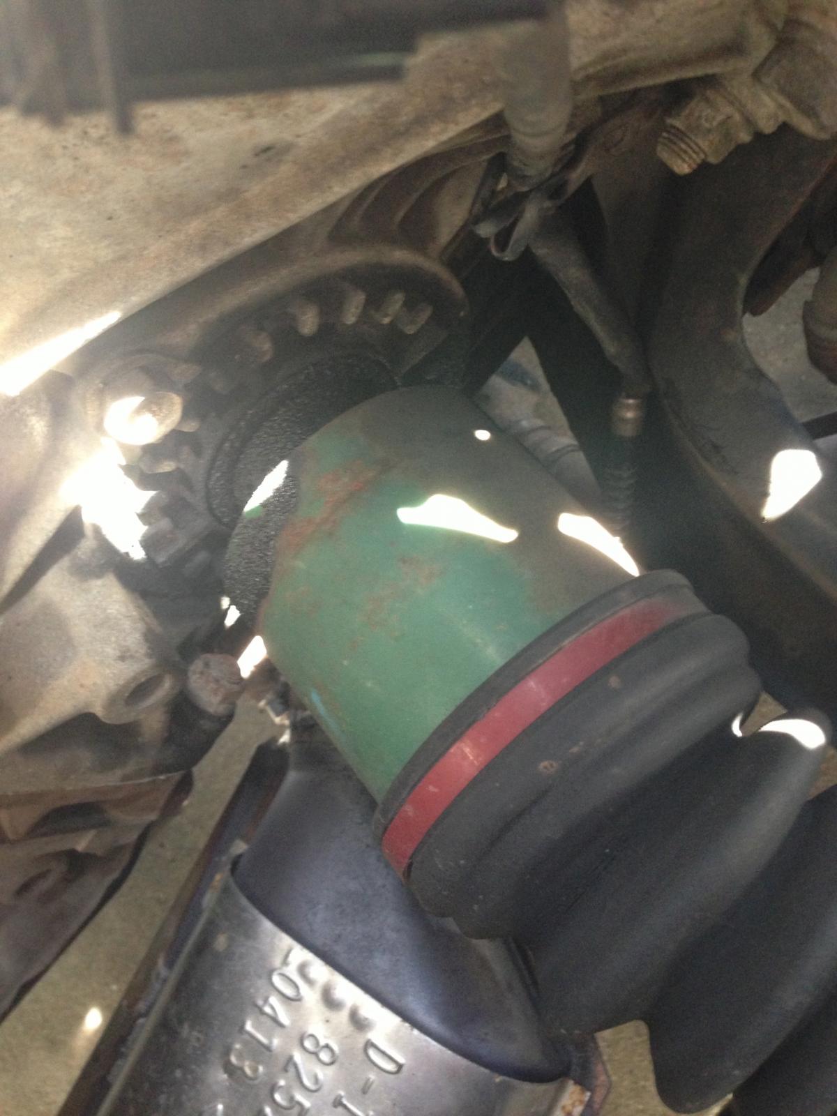

spychar Posted July 14, 2013 Share Posted July 14, 2013 Hey guys, don't know much about my engine but my check engine light is on, and down around the catalytic converter i see this... and it doesn't look good. I've got a 2002 Impreza 2.5 TS sport wagon. Any help would be most appreciated. Quote Link to comment Share on other sites More sharing options...
987687 Posted July 14, 2013 Share Posted July 14, 2013 Leaky axle seal isn't gonna harm anything. Looks like an automatic, make sure your front diff isn't low on oil. Check what the code is, otherwise it's a complete guessing game. Quote Link to comment Share on other sites More sharing options...

987687 Posted July 14, 2013 Share Posted July 14, 2013 (edited) Well what you have pictured there is a front cat, and p0420 is the rear cat. I think the code description is something like "cat system below efficiency." Sometimes it's caused by a bad rear cat, often it's caused by a bad rear o2 sensor. Usually it has nothing to do with the front cat, at least, that's not the correct place to start. I'd start by changing out the rear o2 sensor. Edited July 14, 2013 by 987687 1 Quote Link to comment Share on other sites More sharing options...
