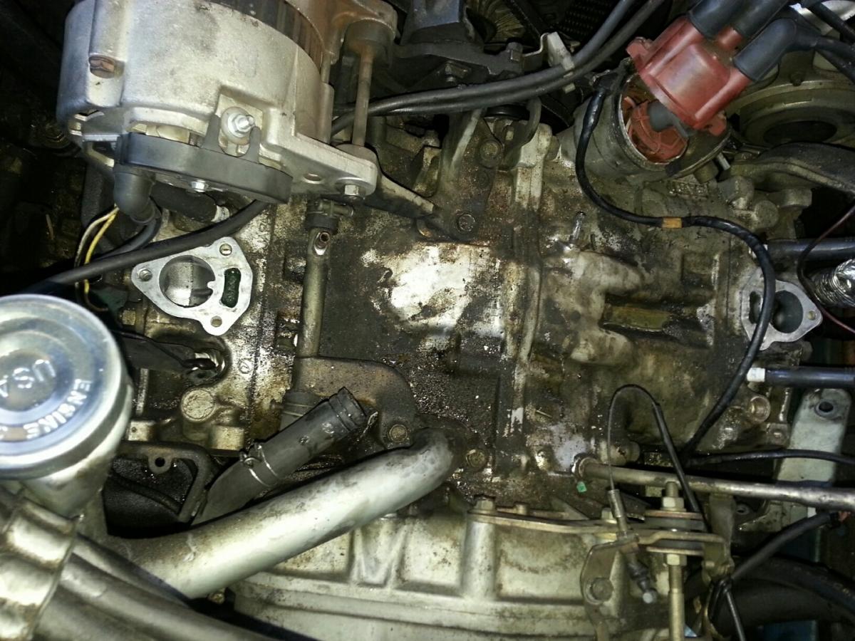

Here is a photo

He told me that this water port was plugged and that he unplugged it (photo attached). I do not know what this port is, but maybe the heater??? If it was a plugged heater port that would possibly explain why the heater never worked.
Or could this have something to do with a hydrolock???

That little tube is a vent tube to allow air to escape from the top of the engine's coolant jackets.  The tube connects to a  little hose that goes up to the thermostat housing.  Although it would make doing a proper coolant fill difficult/impossible if it were in fact plugged, it is unlikely to be involved in any of the problems.
Lots of speculation going on.  It would be nice to find out if the engine actually seized (ring/bearing surfaces stuck together) or if the engine merely inhaled liquid that it could not compress.  Was the engine actually running when it stopped, or did they shut off the engine and then couldn't get it to crank?
There is a gasket on the carb-to-manifold surface that also has coolant against it.  If this gasket had a problem, or if they used the wrong gasket, you could get coolant ingestion from there.
