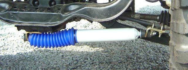

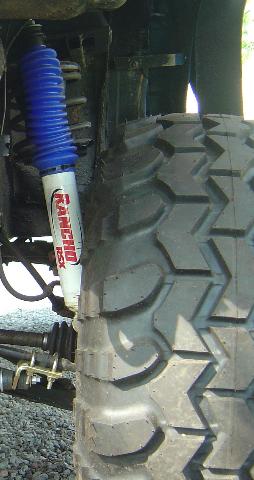

subarubrat Posted April 21, 2004 Share Posted April 21, 2004 I got it mounted, it was made for a Toyota and it adapted over just fine. I had to drill 3 holes on the crossmember but that was it. I also added blue boots to the shocks. Quote Link to comment Share on other sites More sharing options...
Adam N.D.J. Posted April 21, 2004 Share Posted April 21, 2004 Looks good, I was actually thinking that over today for mine. Do you have manual steering or power? Cause I've got manual, and going down the road at freeway speeds, every little hole and pebble in the road feels monsterous! Quote Link to comment Share on other sites More sharing options...
subarubrat Posted April 21, 2004 Author Share Posted April 21, 2004 Manual bro. It was easy to mount, just make sure you call Rancho and ask for a second tie rod bracket. It causes very little drag on the steering. Quote Link to comment Share on other sites More sharing options...
the_bard Posted April 21, 2004 Share Posted April 21, 2004 I assume it dampens the steering for non-powered steering systems? Quote Link to comment Share on other sites More sharing options...
subarubrat Posted April 21, 2004 Author Share Posted April 21, 2004 It works on power steering as well. Quote Link to comment Share on other sites More sharing options...
