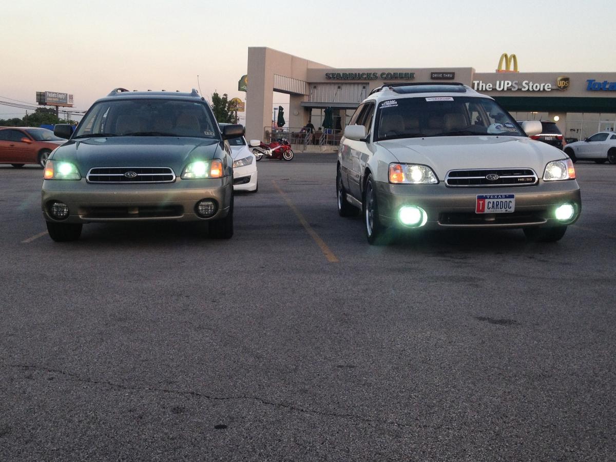

Posted 19 July 2013 - 07:15 PM
To make it easy, I'll just post a link to the complete mod list.  The only thing missing at this point in time from the list is the single bulb Legacy headlights with projectors I worked up.  I haven't had time to swap out the 410cc for the DeatschWerks 650cc either.  I already have a ROM ready based on the latency and flow report.
http://sl-i.net/FORU...=329804#p329804
Here's the build:  http://www.subaruout...leeper-vdc.html
Attached File  IMG_1026.JPG   159.37K   24 downloads
