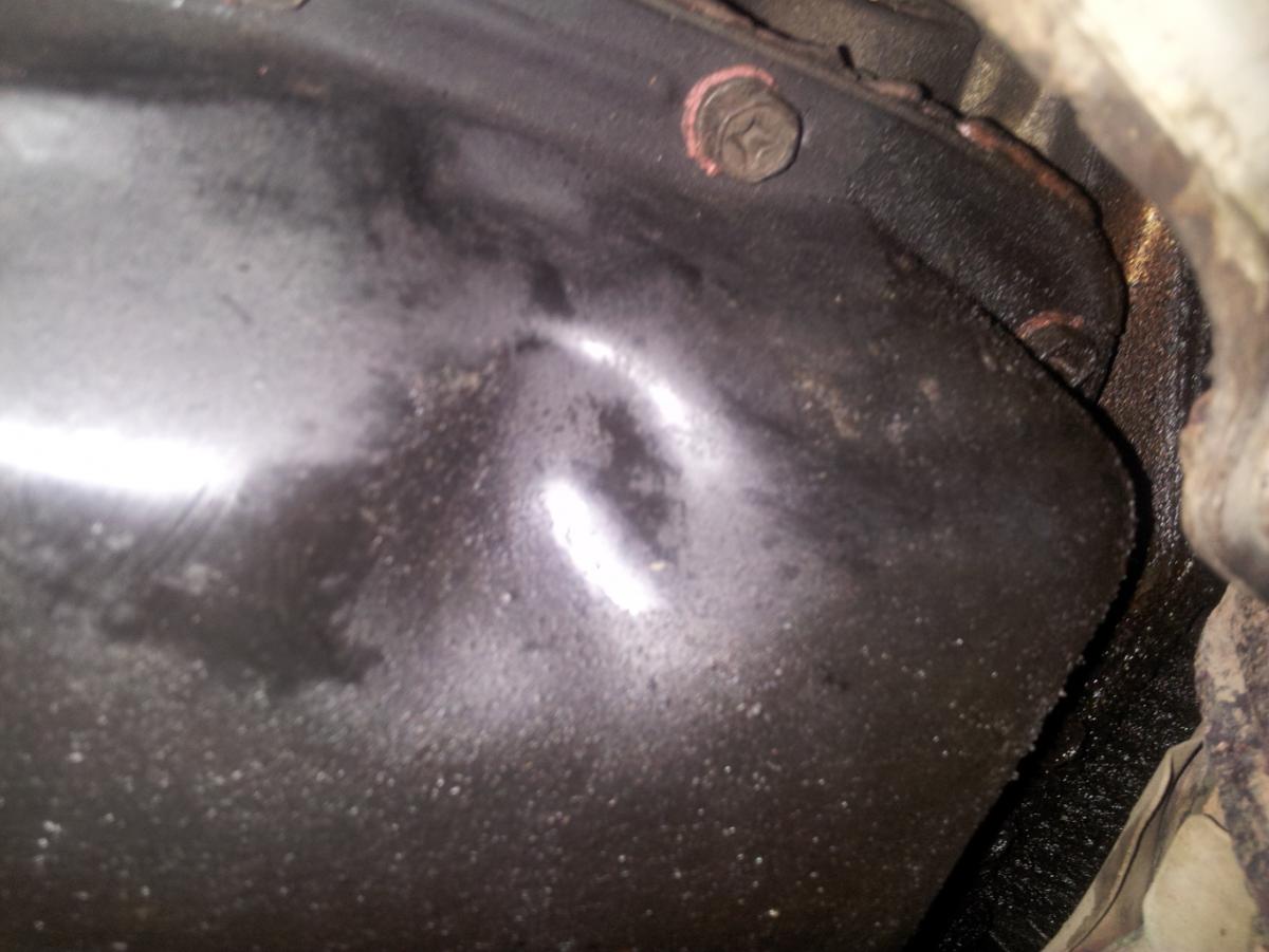

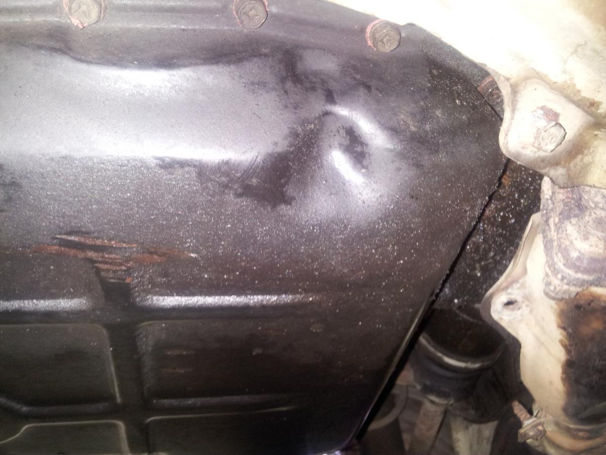

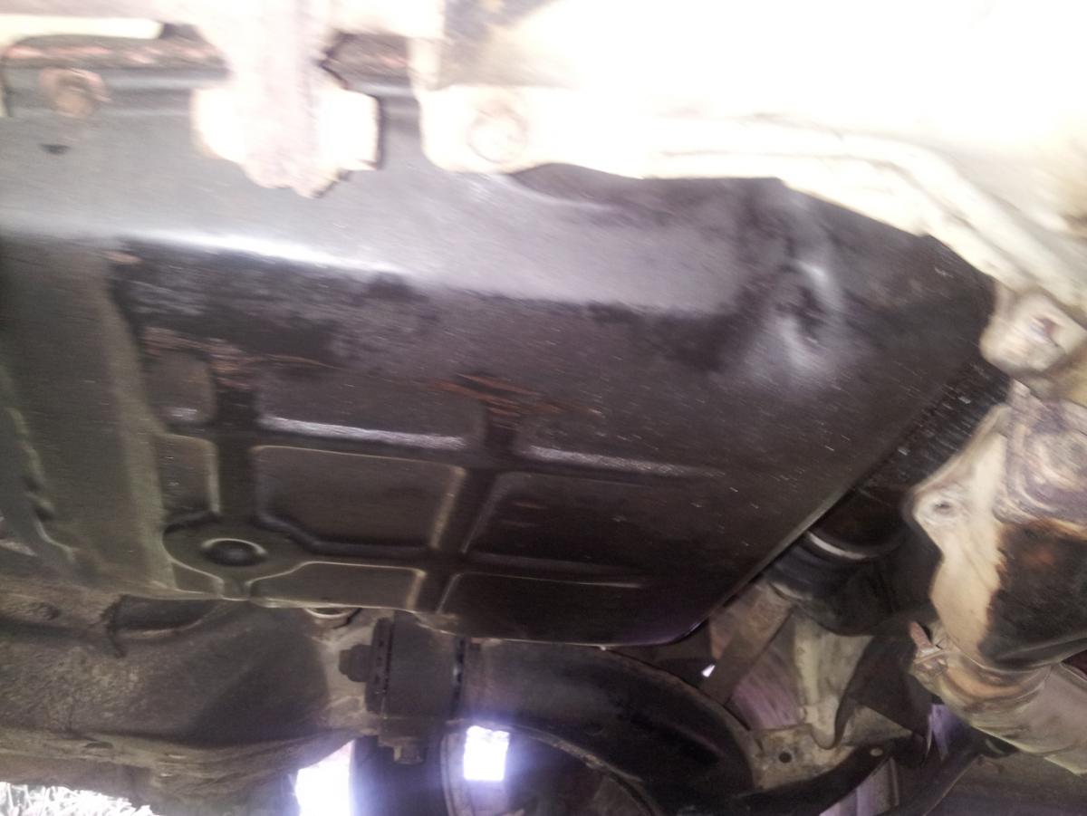

#4 evoixmr
evoixmr
    Newbie
  • Pip
  • 3 posts
  • Chesterfield VA
Posted 27 July 2013 - 06:01 PM
Should I be concern about these dent?
