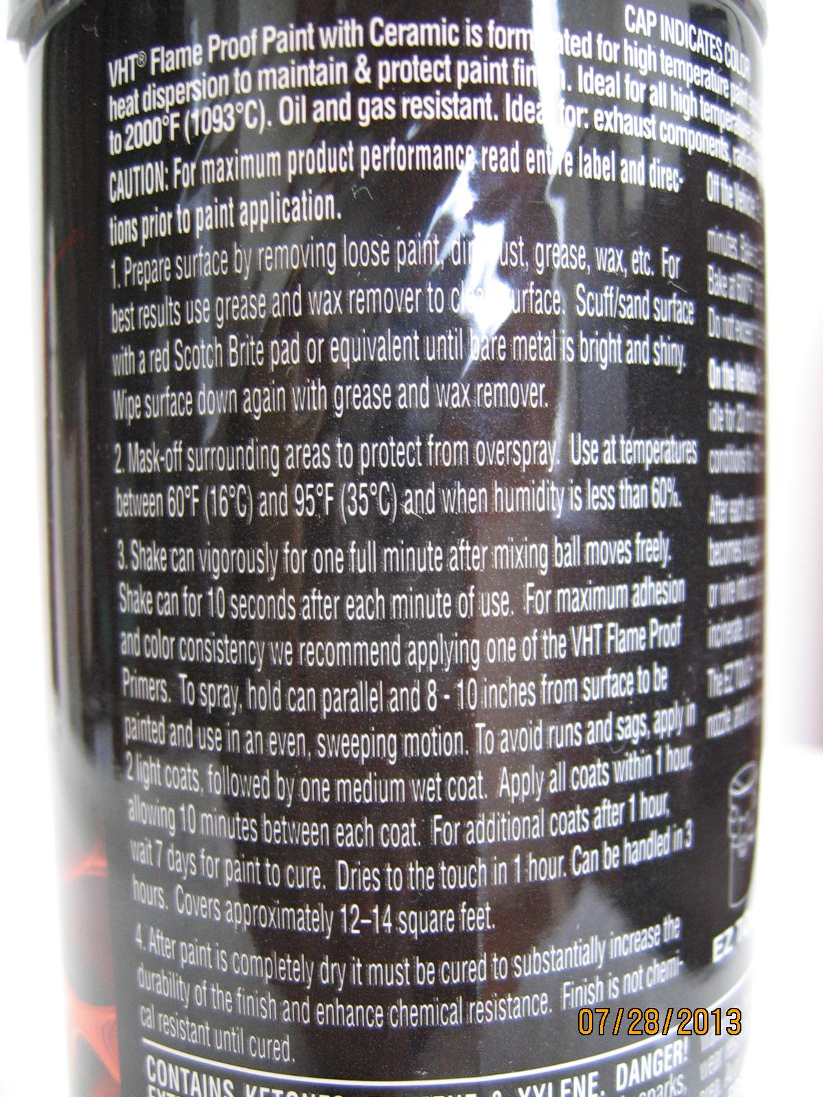

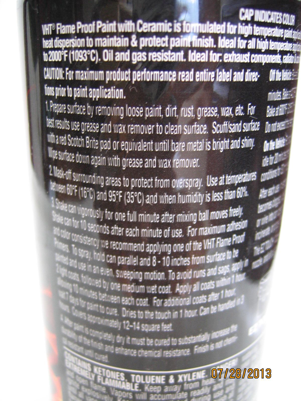

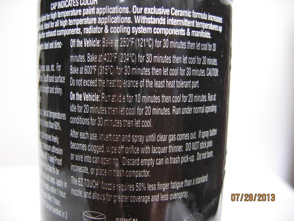

I have experience with VHT spray paint on a 2009 Toyota. I put on 2 light coats of VHT primer first, then another 2 light coats of VHT flat aluminum paint. Followed by a curing process by driving the car according to the instrucdtions on the bottle. VHT is rated 1300 - 2000 degrees F. It's best to use it when the humidity is < 60%. Ambient temp is between 60 and 95 F. I did my Toyota within a week after purchasing the car new in 2008. I used a wire brush and wire wheel attached to a drill to remove some rust, especially on the flanges. New cars' exhausts have rust also. It's been 5 years and there is very little rust on the exhaust. The only area rust developed during these 5 years is near the muffler where the pipe has a curvature. I cleaned it out last month and put on VHT again. Don't know how well it works on older cars with plenty of rust already. You can get VHT from Advanced Auto or Amazon.com. It's about $10 a bottle.

Don't remember how many cans I used. Probably 2 cans primer plus 2 cans paint on my 09 Camry I4 with single exhaust. I also painted the muffler. I still have a little left. If you don't use primer you only need half as many. But you'll get longer-lasting result with primer. I also did my 2004 Camry (earlier post was for 2009 Camry) with VHT back in 2004 when the car was new. I didn't use primer on the 04Attached File  IMG_6902.JPG   166.1K   2 downloadsAttached File  IMG_6900.JPG   335.62K   2 downloadsAttached File  IMG_6901.JPG   268.59K   2 downloads and more rust developed than my 2009. I don't know how much the primer helps on an older car with rust already. The instruction on the can says a bottle covers 12-14 square feet.
