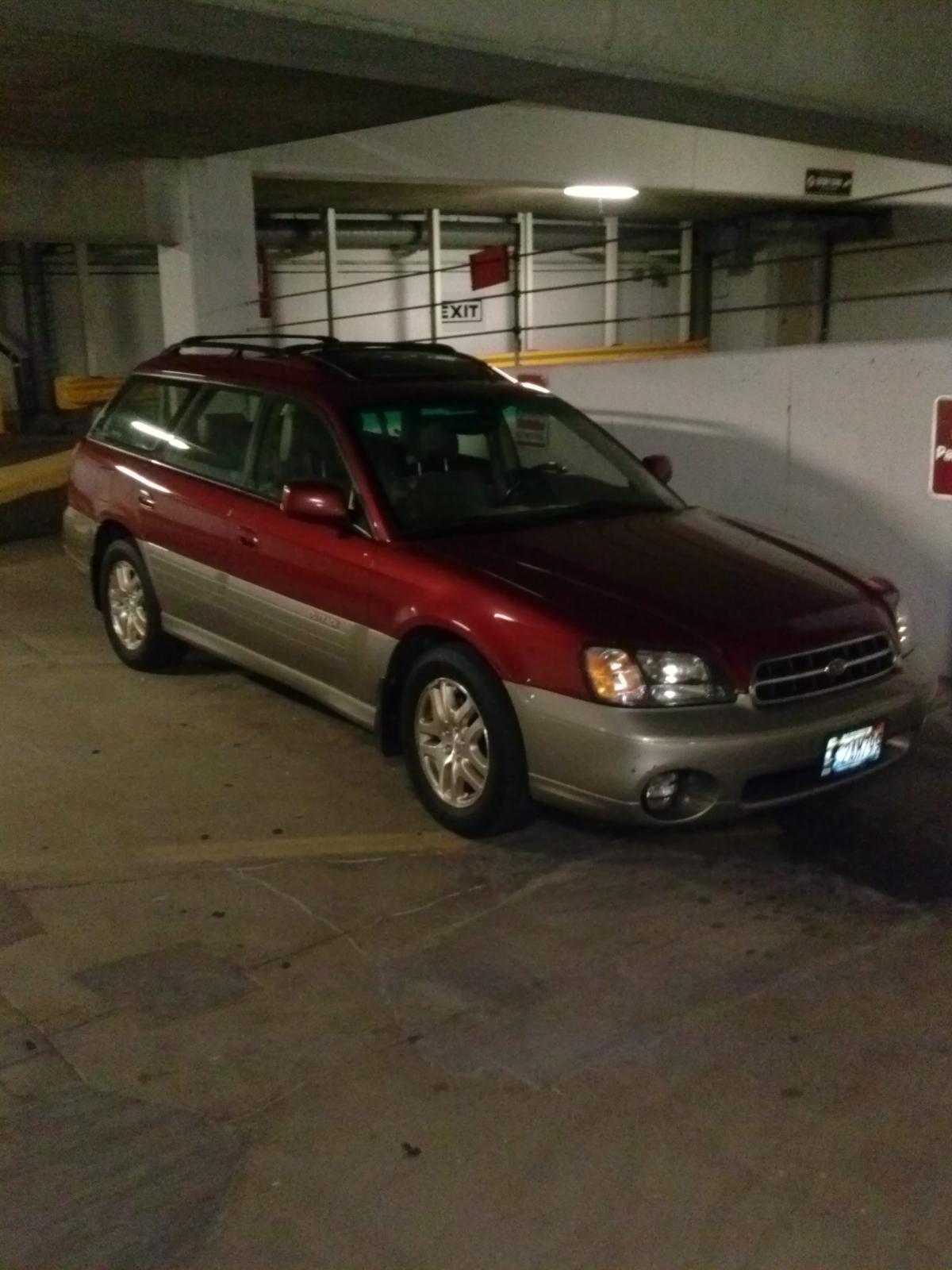

Uber Subaruber Posted July 29, 2013 Share Posted July 29, 2013 Hello all, I am on my third Subaru. I had two others ('85 or '86 GL Wagon and '91 Loyale) which were essentially cheap 4x4 beater I drove into the ground with over 280K on each. The '85 was still running strong when she went to the boneyard- everything else was falling off! I have had my 2002 OBW Limited 5sp for all of two weeks now. Bought it with 137K. I knew it might have some small issues being higher mileage and not knowing its service history 100%. (I did get a clean Carfax that showed some service history at the Subaru dealership) Clutch slips when I give it the beans at say 3-3500rpm, but that is partly why I got it at almost $2K less than Blue Book. In everyday "calm" driving, it works fine. Now that I am used to it, I can drive it without it bucking all over the place. Here are some other issues, in no particular order: It seems to sometimes accelerate not-so-smoothly, and when engine-braking, it bucks/jerks a little bit from time to time. The dealer I bought it from replaced the serpentine belt (not the timing belt ), so I wonder if something isn't just a little bit off, timing-wise. A tune up and timing check might solve that problem. CEL was on when I test drove it. The dealer cleared and said it must have been some emissions thing. It has come on twice since then, but has gone off shortly after, once within a day or two, the second time within 3-4 hours. Any ideas? I has been HOT in Minnesota, and the A/C may have been in use on both occasions. No crazy driving (no high revs/Italian tune-up), the engine temp has been good. The last time it happened I was braking, the engine bogged down like I was braking without depressing the clutch (rpm went way down, almost killing the motor) and the light went on. Gas level was OK, so it wasn't a starvation issue, unless the fuel pump is going out. Burning rubber smell from vents at start up. I am thinking the previous serp belt was fried and this is just residual smell, as it seems to have stopped, and when I had the car running and sniffed around under the hood, I didn't smell any burning rubber. OUT TEMP display not changing: This just started today. It was cool this morning but warmed up to mid-70's. Display said 59-degrees all afternoon, until I drove on the freeway, where it sllowwwwly got up to 66 by the time I got home. The actual temp was 77. It has been pretty accurate up until now, quickly changing to the correct temp when driving from warm underground parking ramps into the cool morning air, dropping 10 degrees in a matter of minutes. Clunking on deceleration: When completely lifting off the gas while driving, with the clutch engaged, it kind of "clunks". This might be the worn clutch, the timing a bit off, or it is just the way AWD Subarus are. I vaguely remember my other Subes doing this, but not sure. Should there be something else to look into, such as motor/tranny mounts, differential, axles? Squeaking in rear corner: This is most likely a shock or spring issue, and it seems more pronounced when I have a passenger or two in the back. The car handles fine though, so I am not too concerned. Burned CDs skip over bumps sometimes, but not regular CDs, so it is the medium, not the car. Rear defrost not working: Just noticed this this morning and haven't had a chance to look into it. If not a fuse, what might it be? The light on the switch goes on, but I know that doesn't mean jack. Any other things I should be looking out for? This is the first "nice" car I have had in quite a few years and want to get the most out of it. I expect I will use this forum quite a bit during my ownership. But as I said, my previous two Subarus were older, basic transportation I didn't want to sink money into. I got my $5-600 out of them and moved on. This Outback is all "new" and "modern" and full of nuances I didn't need to worry about so much on my other cars. I am purchasing an extended service program for peace of mind, and will put up another post looking for opinions on that. Thank you all for any advice/feedback you can give, and I am happy to be a part of your community! Kurt Quote Link to comment Share on other sites More sharing options...

Fairtax4me Posted July 30, 2013 Share Posted July 30, 2013 Welcome to the board! Sounds like you got a decent deal on the car. It looks clean enough in the pictures, hopefully the rust hasn't got to it too bad yet. On to the issues, jerking/stumbling under acceleration often is due to old spark plugs. Have the CEL scanned at the local auto parts store. Most do it for free. You may just have misfire codes, or something else that could be causing issues. Typically misfire codes will clear themselves after one or two starts, most other codes will keep the light on for longer periods. Some jerkiness is normal in these. But there are some bushings in the suspension that can cause issues with ierking around and clunking. The front bushings on the rear trailing arms wear out and can cause the rear end to move around a bit. The mount bushings on the rear differential can wear and allow the case to twist/flop around in the mount. The bushings on the ends of the diff mount outriggers wear and allow the mount to move around. Engine and trans mounts are usually not bad but its worh checking them and the pitch stop mount above the trans. Front control arm rear bushings, aka transverse arm bushings, are fluid filled and when they go bad will allow the arm to flop around some during cornering or hard acceleration or braking. When they go bad the dark grey heavy silicone fluid leaks out. Squeaking from the rear. That model had some issues with the rear subframe and rear trailing arms rusting out bad. Check for rust first. If it looks OK start looking into worn bushings and such. Burning rubber smell from the vents could be a ripped axle boot that has flung axle grease all over the catalytic converters. The passenger side axle is famous for that. Worth it to check tension on the belts anyway, since they did not have automatic adjusters yet on that engine. Clutch slippage. If its original (good chance), then its just worn out. Daikin Exedy makes OE clutches for Subaru and makes very good replacements as well. Funny thing, I just replaced the clutch in my 85 Ranger at 135k miles. Original parts (Ford emblem stamped on them) and right next to the Ford emblem was the Daikin shield emblem. Disc looked great, still had plenty of material on it. The pressure plate had just lost its clamping force after 28 years. Anyway, back on topic, you're overdue for a timing belt change. Unless it has service history that says it was done recently, and even then I would be skeptical. The belts almost never fail, it's the idler pulleys and tensioner that fail and take out the belt with them, then you end up with bent valves. TheRe are a few good sources for timing kits on eBay that include the tensioner, all idlers, water pump, and the belt (some even have cam and crank seals) for around $200. Quote Link to comment Share on other sites More sharing options...

Uber Subaruber Posted July 30, 2013 Author Share Posted July 30, 2013 Thanks for all the feedback. It seems I have some investigating to do. As far as rust goes, some tiny spots from rock chips, and one 2x1 spot bubbling on the right rear quarter. That is it. Underside didn't look too bad, but haven't had it on a lift yet. Overall, it is in really good shape. I hope it wasn't just someone dumping it, whether the dealer or the PO. CarFax did say it was a one-owner trade, but I didn't see anything about the t-belt. That extended service plan I got may pay for itself right from the get-go. Is that a "recommended" service at a certain mileage? Quote Link to comment Share on other sites More sharing options...
