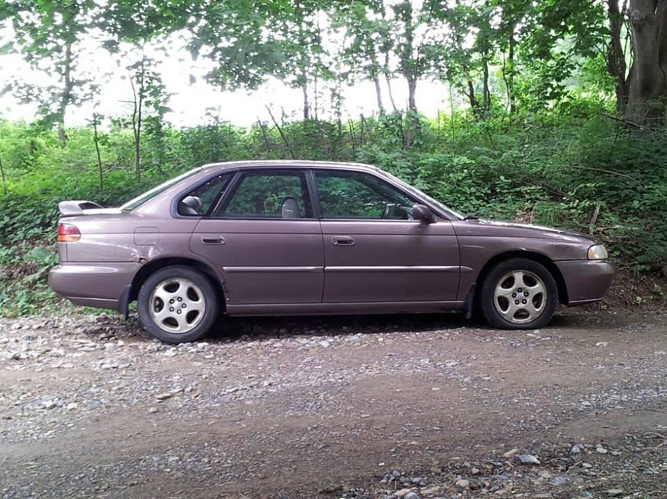

Um, it's not green with a toggle switch (or hole) in the coin compartment, offroad light on the front bumper (or two holes where they were mounted), a front bumper with the lower cross section cut off, and a rust spot poorly painted over by the gas tank, is it?
If it is, it has a cracked block.
nope
