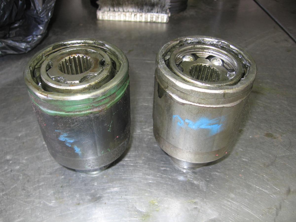

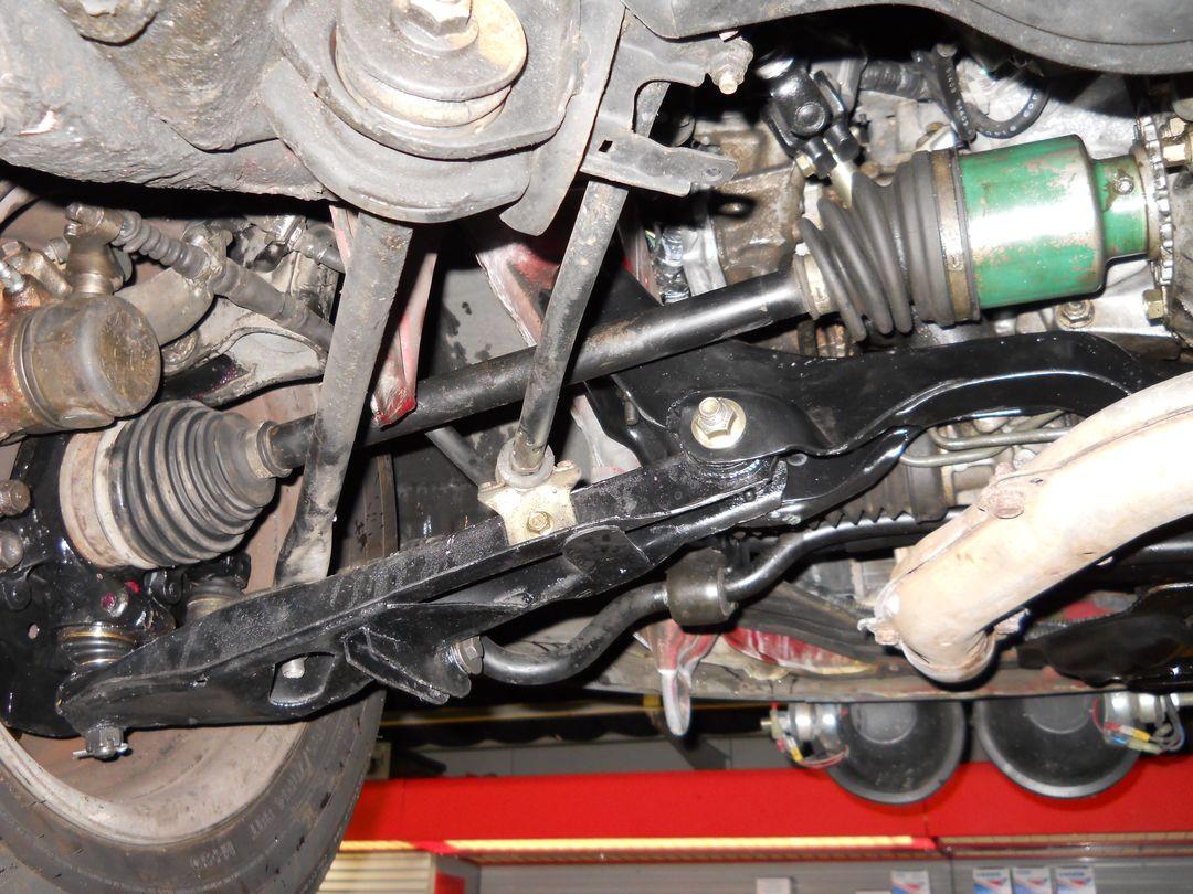

I am having the same issues on a swap I am currently working on. Have you resolved it yet?  I have learned that Subaru OEM axles with the smaller inboard D/O joint are better to work with than some of the aftermarket ones. If you take the inner joint apart and flip the D/O bearing on the in-board side of the axle shaft (requires removing the snap-ring) this will gain you enough length that it will work. There has to be a better solution though?  I have tried all of the early EJ knuckles and there is no difference in axle spacing on an EA82 body. Impreza, Leg, ABS or Non, all the same.
Attached File  IMG_2552.JPG   125.9K   76 downloads
Attached File  5 Lug EA82 .jpg   162.29K   85 downloads
Please reply with any updates if you find out any new info.
