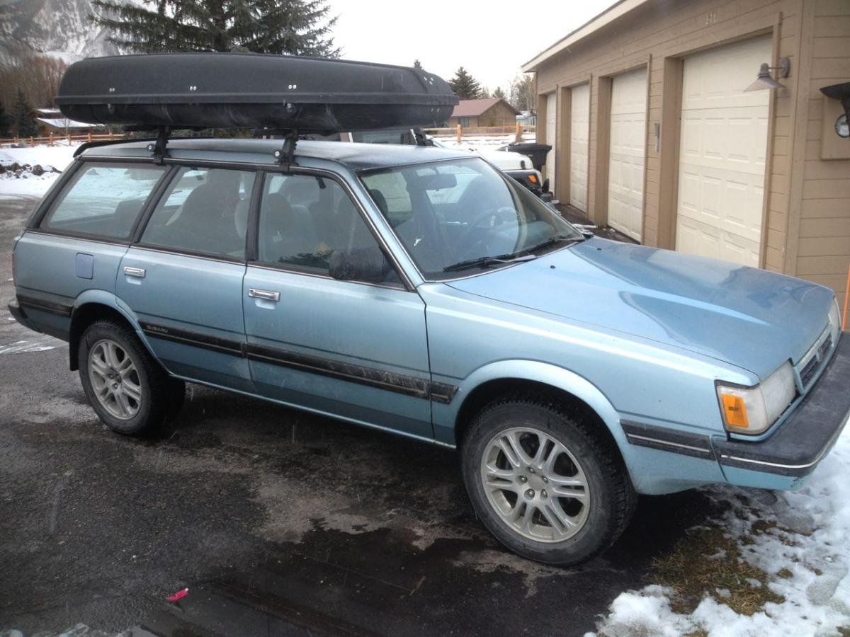

After months of overheating I finally switched out to the stock 89 gl radiator, now it runs fine without the expansion tank. New injectors black ones. Everything seems to be running good with the new radiator and I have heat again! Not sure why the other system didn't work. But if it runs without overheating I will feel better about driving cross country in it. Which is always exciting. Plus i got some new wheels and snow tires!
