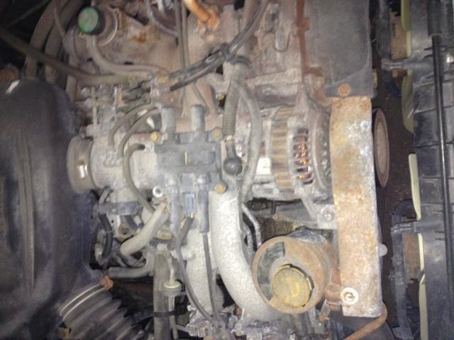

I bought a 98 Legacy Limited Sedan recently.  Car runs great as well as shifts great.  Not totally sure which engine it has but its probably the 2.2L.  I'm not a car buff so I'm trying to get a opinion as to what or if there is a problem.  Sometimes when I go to get on the gas to get up and go it seems to not wanna rev up and just go it will go up like a granny driver.  Car idles smooth and everything so curious what are things Subaru pros might think

Limited more than likely has the 2.5. Easy to find out. Look under the hood, straight down at the top of the block behind the alternator there is a casting that either says EJ22 or EJ25.

engine casting number will be on the block - look down in between and behind the alternator and the power steering resevoir - it may be dirty down in there judging by the picture you posted, so you may need to use a rag & wipe away some crud.
The 2 engines are very similar looking on the exterior, so your picture is pretty much useless for identification purposes.

Every 98 "Limited" model I have ever seen, had the EJ25 larger motor, so I would bet the farm that the car has the EJ25 engine.
there is an ID tag under the hood on the driver side attached to the the strut towr.
you can read it while standing at the driver sdie front tire.
it will have the engine ID code on .
