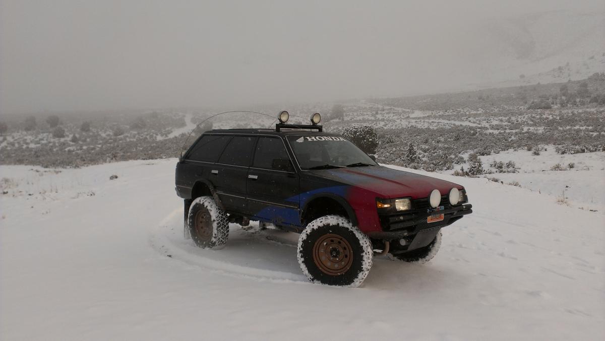

Thanks to SJR for the lift, has been my daily driver for the last 5 years and runnin lift for nearly 2 years now.Attached File  IMAG0500.jpg   64K   233 downloads

Skyrider...nice set up.
Can you give some details about the roof bar and brush bar?
Is the headlight treatment just painted on?
Are both whips connected, and to what type of transceiver?

Yes I ride a CR500, and both whips are connected, one to a cobra cb and the other to my radio which gives me no better maybe even worse reception, but it is hooked up. Headlights are painted

Push bar and roof bar are electrical conduit from lowes, yay galvanized so it won't rust, well kinda won't rust. Didn't die welding it either, it was well ventilated in a 2 car 2 car garage, I only breathed the fumes when the weld was bring layed so I played it safely on the edge. No cancer or death as of today!

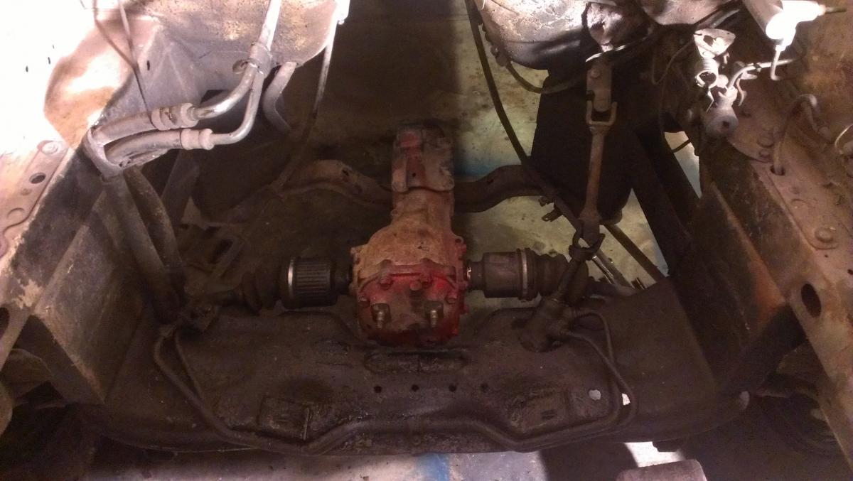

Now onto installed LSD front and rear diffs with a Sammy t-case and the EA82T.
Hopefully to have finished before the first snow here in Utah due to all my money is going into this and not tires for the daily driver which are smooth as a race slick!

Subframe is in and starting on the Tcase

Turbo Motor Dropping in. 9.5:1 bottom end with turbo top end. Custom Torque cams ground by Delta Cams, Heads ported and polished, 300ZX twin turbo injectors, SVO Intercooler, Sami Tcase, and lots of custom welding, bending, and rigging. On the road and runs good. Pulls like a subaru pushing 32's with 150hp or so!
I'll try to take some more photos and post.
