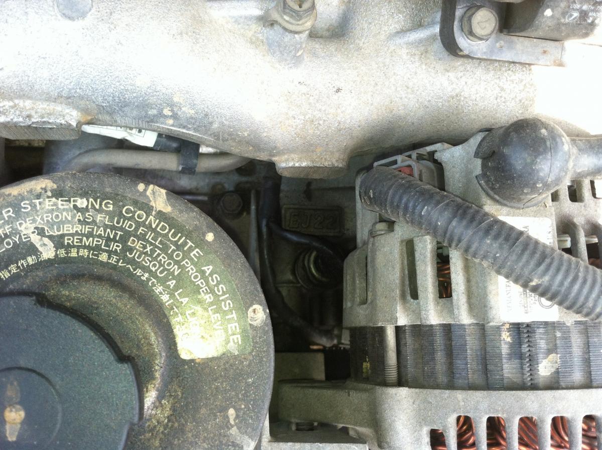

Fairtax4me Posted August 20, 2013 Share Posted August 20, 2013 Just to the left of the plug on the alternator, look straight down at the top of the block. The engine code is cast into the block. Quote Link to comment Share on other sites More sharing options...
