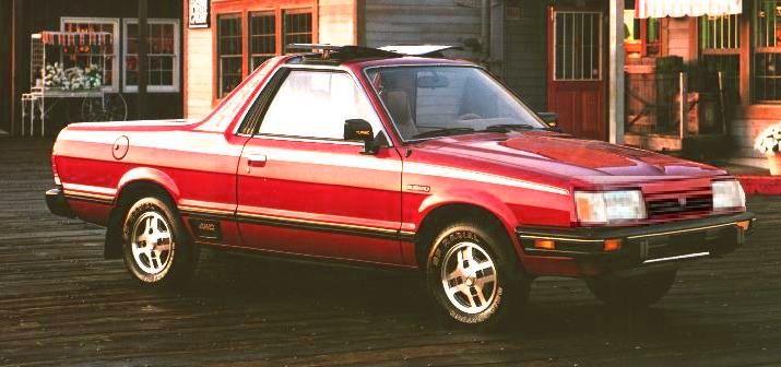

has anyone ever tried to fit a Loyale Front end on a Brat ?
i edited this picture to see what a brat would look like with a Loyale/gl front clip
Doable i'm sure
Loyale + Brat = Loybratle ? :P

From what i know is an ea82 DL quad headlight uses the same bucket as an ea81. so therefore it may be possible to fit ea82 headlamps. I would imagine some sheetmetal work to retrofit marker lamps, andmaybe some mods to the edge of the hood to fit the headlamp profile.

Seems like it will not be too hard to do, but it will be Tricky, on mounting points and the area where the Windshield and the doors meet the fenders; but the Final result will look as Awesome as your Photoshopped image.

well i figured like miles said the healights would mount, using the brats stock fenders and do some tin work for the side marker lights or if possible leave the stock brat sider markers in if they fit with headlights.
BratMan WHY???
becasue i personally like the Loyale Look Better. also its different
