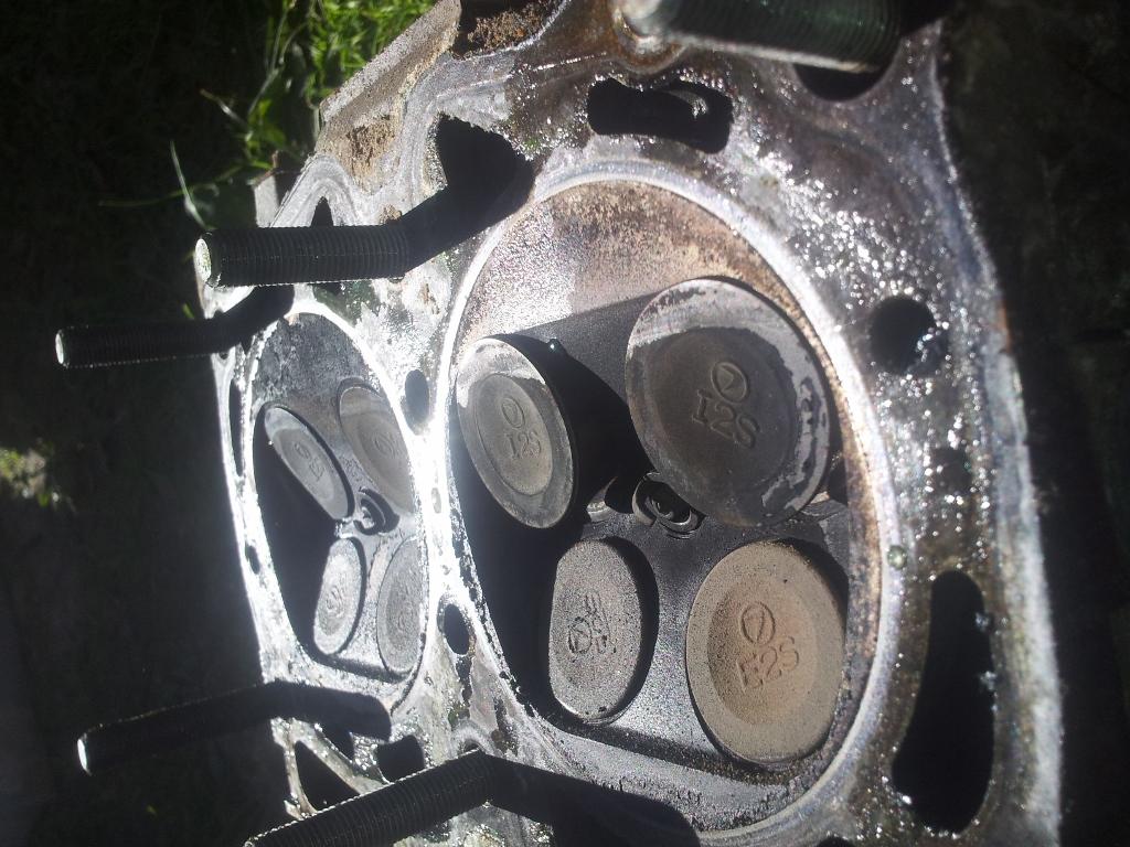

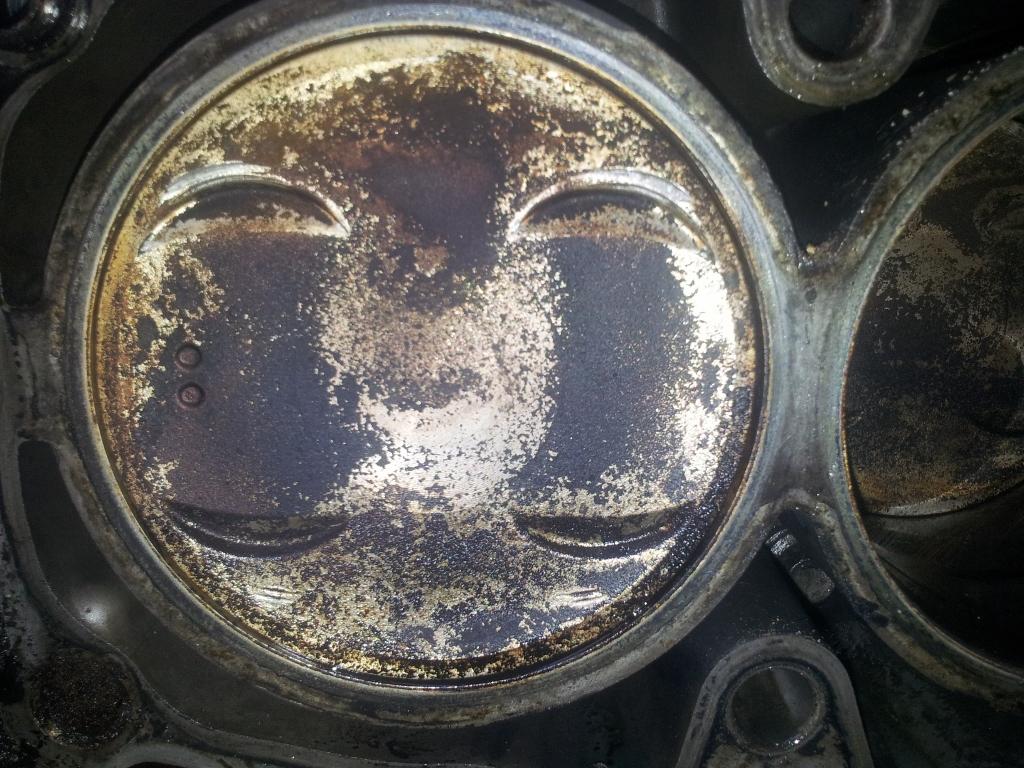

Hello everyone, I picked up a 2000 outback limited with a blown timing belt.
Well... it had a blown belt, and the guy slapped on a new one and tried to start it... so needless to say the motor is in dire straights. pulled heads there's bent valves, damaged pistons, and all that fun stuff. no problem, i have a running motor out of a 2002 TS that I will drop into the car as a temporary fix while I completely rebuild the original motor over the winter. The car is an auto (gross) which I'm going to leave for now until the rebuilt motor goes in and I have rounded up clutch linkage, rear diff etc.
I ordered from subaru today- oil pan, exhaust gaskets, rear main seal, oil separator plate, water pump gasket, t-stat housing gasket.
I ordered from online today- gates timing belt kit tckwp304, t-stat.
The 2000 ecu currently in the car is for an auto tranny tz1a4caba and ej251axawl engine.
The 2002 engine going into the car is for a standard tranny tyl54vc2aa and ej251aw3ab engine.
So, should I swap the ecu with the matching motor and trick into thinking there is an auto, or leave it as is and just plug in the motor?
And, is my parts list complete for this project? Like I say I'm just looking for 6 months of reliability so basically I am going economy class for now, and going all out on the winter build.
Thanks for any advice here, I have done tons of reading it seems either way will work but I figured check with the experienced before I'm turning the key.

the pistons are probably fine.
it is not very often that a busted belt causes piston damage.
a valve job will probably put it back on the road.
but you do what you think is best.
there may be a slight difference in the new vs. old engines.
use the existing intake, cam and crank sprockets and you should be good.
the 00 engine does not have EGR.
and they added it in 03 , i think, so that should not be an issue.
but even if the 02 does have EGR, it will not be an issue.

The pistons did get hit pretty good, more so from when the previous owner tried to start it without fixing valves first. if i didn't have a running block already i would opt for a quicky head job and be done with it, but i figured this is a better route for now.

Make shure you check for cracked or droped guides when doing valves

I'm not splitting this motor the heads are okay, new HG from previous owner.
Building heads up on the blown motor this winter. ALL the guides and seals are getting replaced... she hit pretty bad lol
