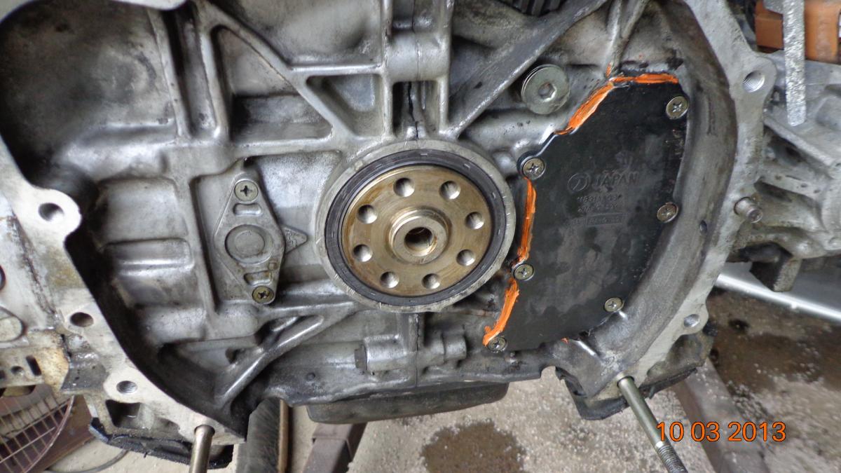

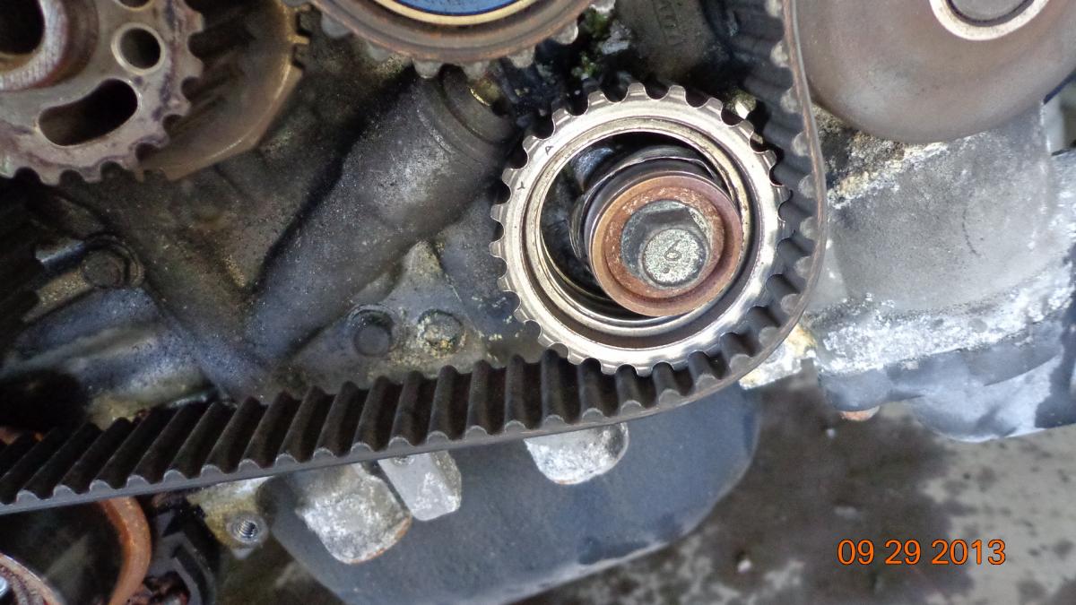

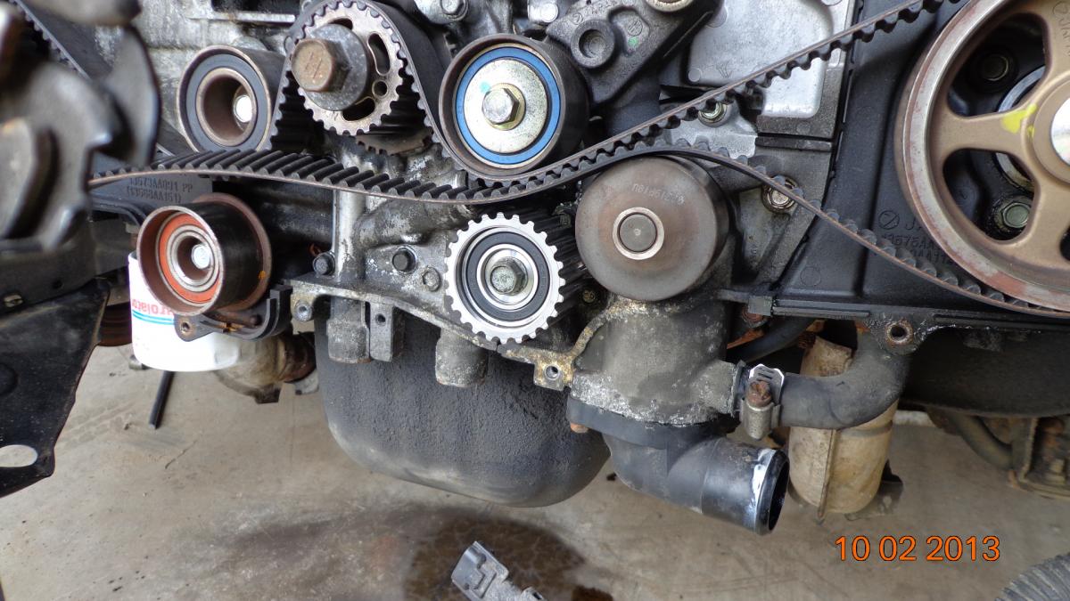

Update: Engine is not blown, it was the bottom left imc pulley comepletley shaved out.
i have replaced it and the engine is running great i however had to remove the engine due to rear main seal leaking something fearce.

glad you got it running.
how long do you think the other 2 idlers are going to last?
no valve damage?
that is really lucky.
timing belt issues usually cause bent valves.
good luck.
Edited by johnceggleston, 09 October 2013 - 04:55 PM.

the top pulleys run like a champ, i am however worried about the lower right pulley, i wish i had the funds to replace it.
