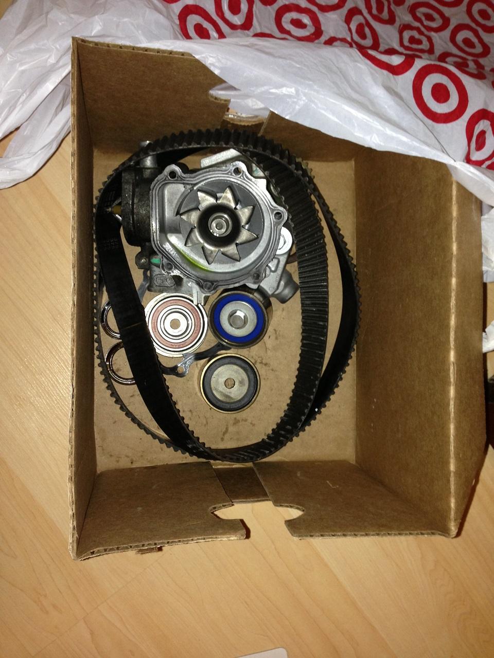

So as you all suggested, I got the timing belt replaced long with the additions you added and everything works perfectly! here's a list and a photo of what's been replaced, cost me a small fortune but i don't have to worry about any of those for another 150000 kms:
-Timing belt,
-Two idlers and gear
-Tensioner
-2 x Camshaft seals
-Crankshaft seal
-water pump
-thermostat & gasket
-throttle plate cleaning
-hose clamps
-Cooling system flush
-Antifreeze
-Subaru Conditioner
Thanks a lot for all the advice!
