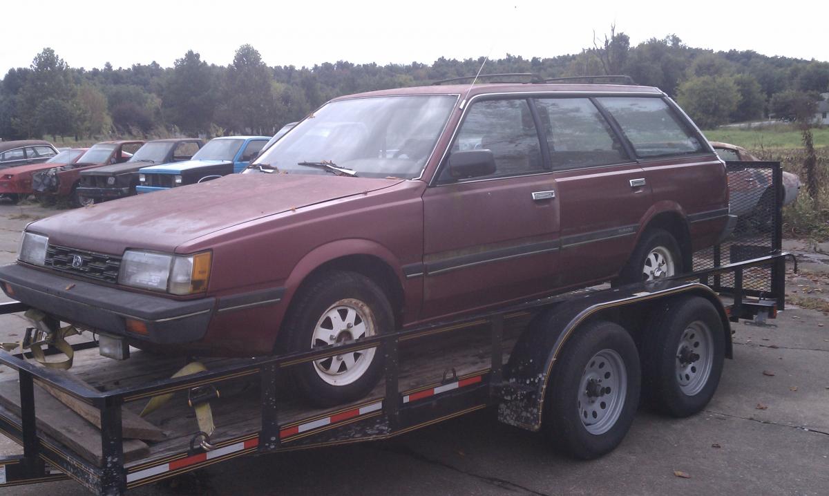

Just purchased my first Soob, an '86 wagon that has been sitting for approx. 7 years. I posted some info in the intro section, but here's a thread on it's (hopeful) resurrection. Years ago, I drove a '71 VW bus cross country so I'm hoping that experience will be handy when it comes to wrenching on this GL.
Purchased for $400 this weekend and towed home.

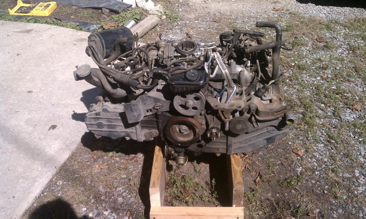

Update: I've got the engine pulled and it's sitting in my shop ready for TLC. Ordered the cam tower o-rings and intake gaskets from the nearest dealer (70 mi. away) and they'll be ready for pickup Wednesday.

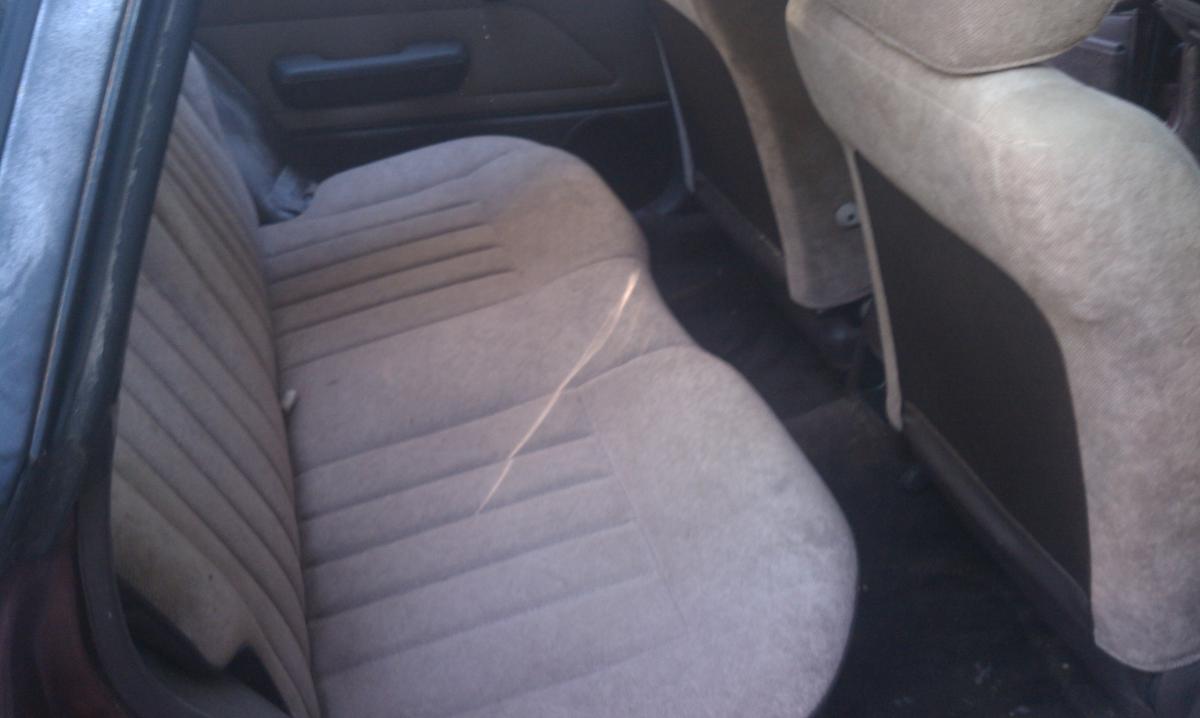

I've attached a few pics below of the engine and the interior. The last pic is what I found when I peeled the A/C comp. & alternator back. Looks like a messy repair was made on the intake previously.

Looks good. I like the use of the quickdraw to lift the engine. Apparently I'm not the only one who mixes climbing gear and Subaru repairs!

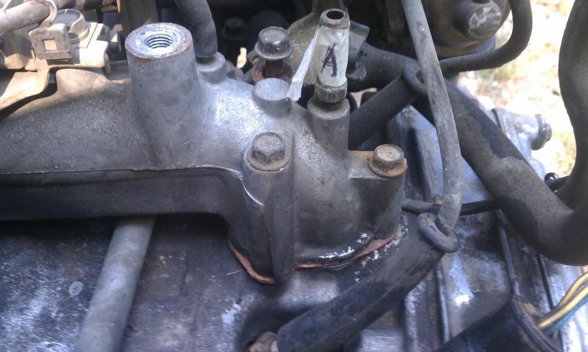

Got the intake off after snapping one of the bolts. Pictures show the condition I found each side in. The driver's side gasket came off with the intake, where the passenger's stayed stuck to the block. That pic also shows the broken bolt. I'm letting PBlaster work it's magic on that currently. If that doesn't work, I'll go the drill bit route.
One last pic, the engine after a small amount of cleaning. I think it'll turn out well.

You're really lucky. You have a lot of bolt sticking out. Do not start by drilling that, you have a gift there. Heat it and use vice grips to wind it out. Or weld a nut to it, or something. But you don't go start drilling when you have a piece of the fastener sticking up. Drilling bolts out of the engine SUCKS. Try to avoid it.

Got the passenger side head off and on the bench. Still no luck with the manifold bolt. I may end up taking it to the machine shop. I found some corrosion on the upper bolts on both the cam tower & head itself. I don't think these head gaskets have been on too long, judging by the condition of the head bolts and gasket itself. I did find unequal torque on the head bolts and the cam tower o-ring in bad shape. No discernible cracks on the head either. Lucky I guess?

A thought on that busted bolt. You have at least one more good try before you have to think about drilling. Soak it in PB Blaster or something similar for a while. If you can weld, or take it to a shop and have them weld a nut right to the bolt. (You can fit a pretty big one on there.) Then put your socket on there and spin away. With the amount of material sticking out, there's a very good chance you can spin it on out. Even if it snaps again, you're no worse off than where you started. I've done this a number of times both successfully and unsuccessfully. (Probably about 50-50 split.) But you've got more material there than most of my attempts so you've got a good shot at getting it out of there.
Heat from a propane torch can also help coax it out.

Broken stud removed & the head has been sanded, ready for re-installation tonight. The stud removal took about a week soaking with PB Blaster and a moderate amount of pencil torch. I purchased a cheap stud extractor but never could get a good bite on the stud.

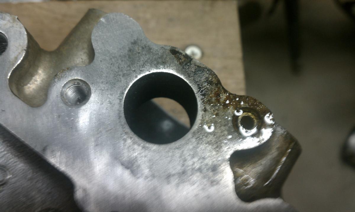

I followed GDs thread on sanding the heads and it worked well. 220>320 grit and the picture below is what I ended up with.
The common cracks between the valves that I thought weren't there of course ARE there, but not letting those worry me.

Sand a little more; can still see a bit of the fire ring there.
