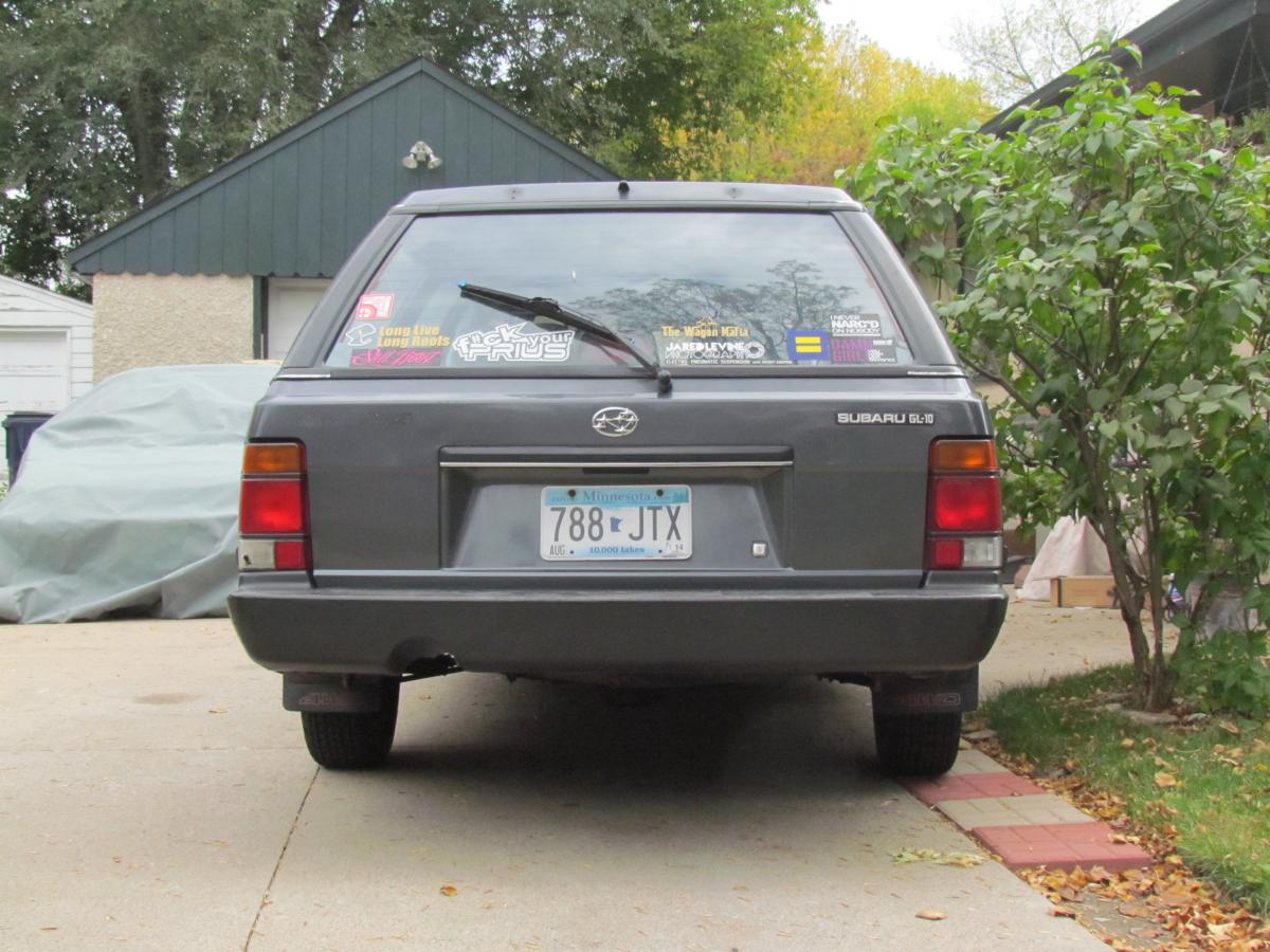

Whats the lowest riding strut that will fit the back of a GL-10/Loyale? I have a 4WD that i am trying to lower, I already have coilover sleeves off a CRX in the back and all the way down they  still have 1 fist of wheel gap.
I have 175/70 tires on it and Monroe 4wd struts, I know i can get them to tuck the tires, ive seen a FWD Loyale personally that low.
I have attached pics of my car as it is now

What measure subaru items do you have - as a starting point would not hurt you giving some measures :) I think I have measured 125mm from spring perch to bottom mount hole centre on a Sube strut/shock for rar of EA82
Flipping the top mount on the rear struts will give you an extra 1" but you will need to do some hammering in the wheel well for clearance. Otherwise just run shorter springs. Circle track universal springs, 8" tall 2.5" diameter, 200-250lb or so will give you good tuck and slip right on your OE shocks with no mods.
