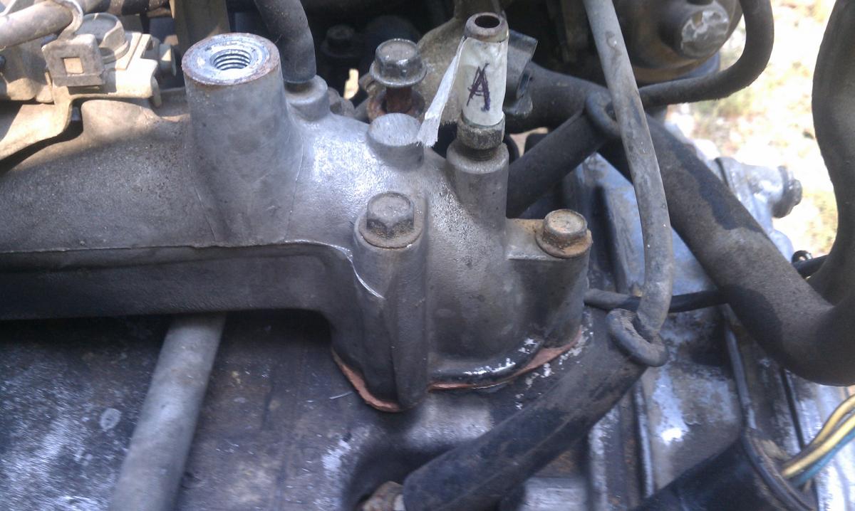

I've pulled my engine for supposed head gaskets problems but in light of what I found in the attached picture I have to ask here. Going by what I've read/seen, that looks to be a halfassed repair job on the intake. Would you replace the intake gaskets and call it good? Maybe even replace them and run the engine out of the vehicle to check. I'd like to save myself the extra work of head gaskets if possible, but thought I'd ask you all. Thanks!

Well, the intake manifold has to be removed in order to remove the heads. So, I would start by pulling the intake and inspecting the gasket and sealing surfaces too.
Bad intake manifold gaskets would only result in burning coolant. not a mix of oil and coolant.

That makes perfect sense. I guess the only way that would result in mixing is if your rings were in really bad shape....ha. I've got new OEM gaskets ordered so they'll be getting replaced soon.

  hi,  the majority of folks here recommend the fel pro perma torque head gaskets on ea82 motors rather than the oem, about the same money basically..   that is my 2cent,  however the oem intake gaskets seem to have more width around the ports  than aftermarket ones, at least for the mpfi ones ,  spfi is not as critical.  if you do the head gaskets,  don't forget to get the little  oem gaskets for between the cam cases and heads, looks like an o ring , but is actually a rubber coated disc so it cant collapse and partially block the oil passage like an o ring will do.

Coolant in the oil is usually from the internal freeze plugs in the heads rusting, or working their way out, not HG's. Pull the valve covers, cam towers and inspect the freeze plugs. Look for clean spots.
