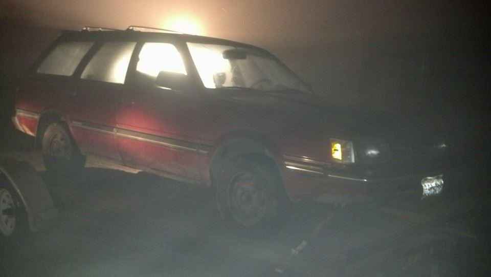

got a new 88 gl wagon 5 speed hi/low wont start thinking timing belt

wont start but has spark and fuel ran out of coolent but i thing head gaskets are ok got shut off as soon as it got hot and now it turns over fine but doesent seem to have compression like its out of time
