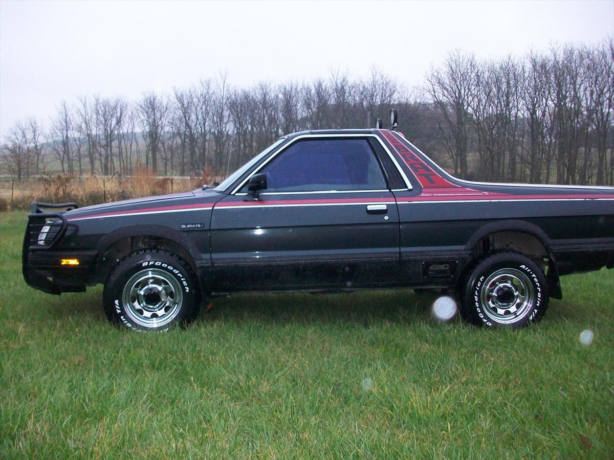

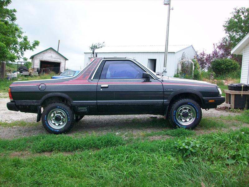

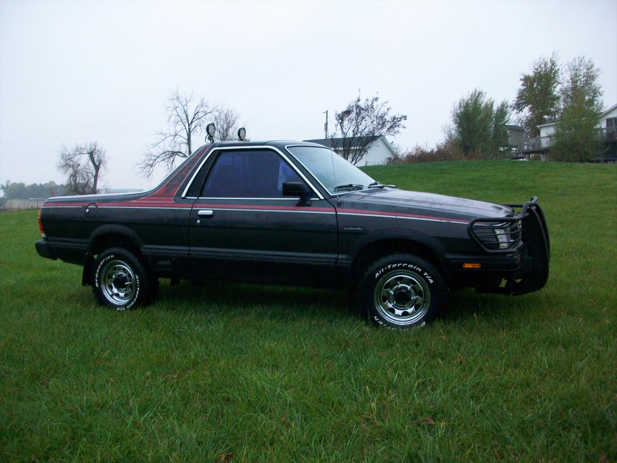

newgen85brat Posted October 29, 2013 Share Posted October 29, 2013 I understand what you want. I have done mine very similar to that. I have weberized it, 2 inch lift, 6 bolt wheels, 14 inch tires, NOS gas tank, 14 inch Nissans and center caps, NOS exhaust and just about everything else. So many things I hate to say. It has been a long journey getting there but it is all easy enough if you want to do it. I used the forum for help but basically just looked at posts and pictures and then took educated guesses. I love my 14 BFG's. They are 10 ply and although stiff, they stand up to bean and corn stubble for hunting or playing around. I made my own 2 inch lift out of 3/16 wall square tubing. It took about 2 feet total. I dropped the pumpkin 2 inches with 3/8 plate steel. I only use CV shafts that are new, the remanufactured ones always clicked. I used a bed liner for the areas in the bed and under the stripe and kept the original paint with a clear coat cover up. Seats are from a u-pull-it. I made the shock towers myself. I looked at vendor photos and then kind of guessed. I simply cut 4 inch heavy walled pipe at a 15 degree angle then cut a hole in the flat plates and welded them together. This stopped any bad toe problems. Next items I want are to completely build a new motor from the ground up. Lots of advice here says to buy one from somebody and swap it. Well, I did it twice with not too promising results. I am going to get a Clegg build kit and do the work myself. One other thing is the front drive angles of my CV shafts. I put a 2 inch block system on it but am going to raise the struts to the highest setting then drop the cross members and engine another inch. This will lessen the angles. Too much and it started to rumble like the shafts were coming apart. The ride is a little rough but that could also be the tires. The rims I got from a mid 90s Nissan truck. BFG's 195-75-14 are a good find and I love the white letters. I have a little rubbing but not when I lift it another inch. In the pics, the one with no grill guard is with the full lift. ( I don't like jack rabbit look- I want it pretty level) Oh yeah, the grill guard was a throw away from a mid 90s Toyota. The lift can seem a little scary. Just take your time and think it through. If I could do it again, I would 5 speed it, lift the front 3 inches with a 4 inch engine drop. I still have to ad more lights and finish the engine and lift. I also need to fabricate a class 1 hitch. I use the LED lights to save on power and they are great for hunting and working in the field. This is my Ranger/Mule/Rhino 1 Quote Link to comment Share on other sites More sharing options...
