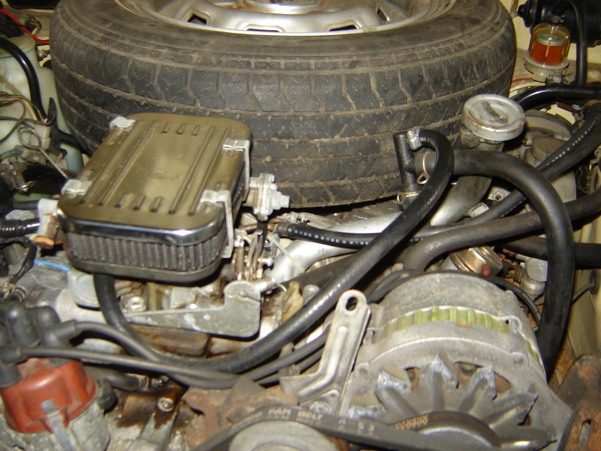

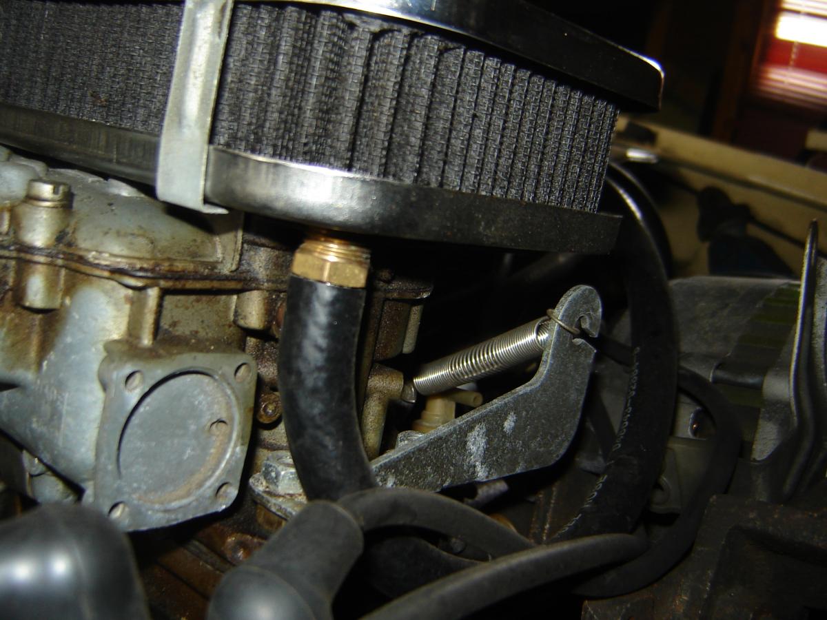

rrgrr Posted November 5, 2013 Share Posted November 5, 2013 Check these -this is an EA81 but the pcv system is so simple...my carb is reversed in direction to accomodate the acc cable, so ideally the airbox fitting would be on the back side. The EA82 has a 'T' connector, where the 81 has that 'F' thingy. Just route the side going to the stock assembly to the Weber box base, add a brass hose fitting, and you're done. I'm thinking mine is 3/8". I've not needed an oil catch, not sure why one is needed on others'. Seems like there would be quite a bit of pressure to blow oil enough to be a problem. Please correct me if I'm wrong. Quote Link to comment Share on other sites More sharing options...
