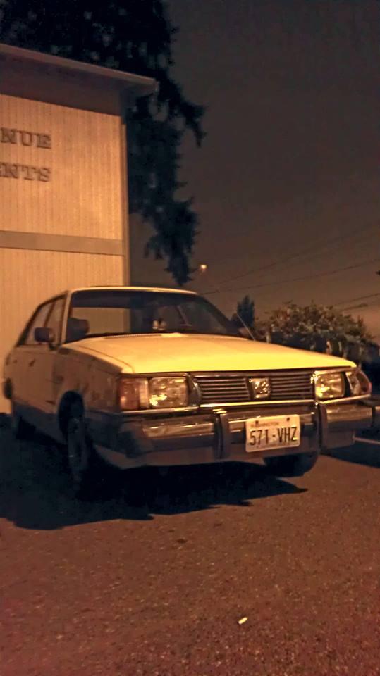

thebr0wn0ne Posted November 5, 2013 Share Posted November 5, 2013 So after replacing the spark plugs, distributor cap and rotor, my 81gl sedan runs a million times better ( who would have thought? ) but now even after its warmed up once i reach 4k it sputters and hesitates like almost as if their is a lack of fuel. Any ideas on what that could be? Also I pretty sure i have a blown headgasket or a cracked head... as a short term remedy would that BlueDevil sealant be a good choice? Thanks for the help! heres a pic just because Quote Link to comment Share on other sites More sharing options...
