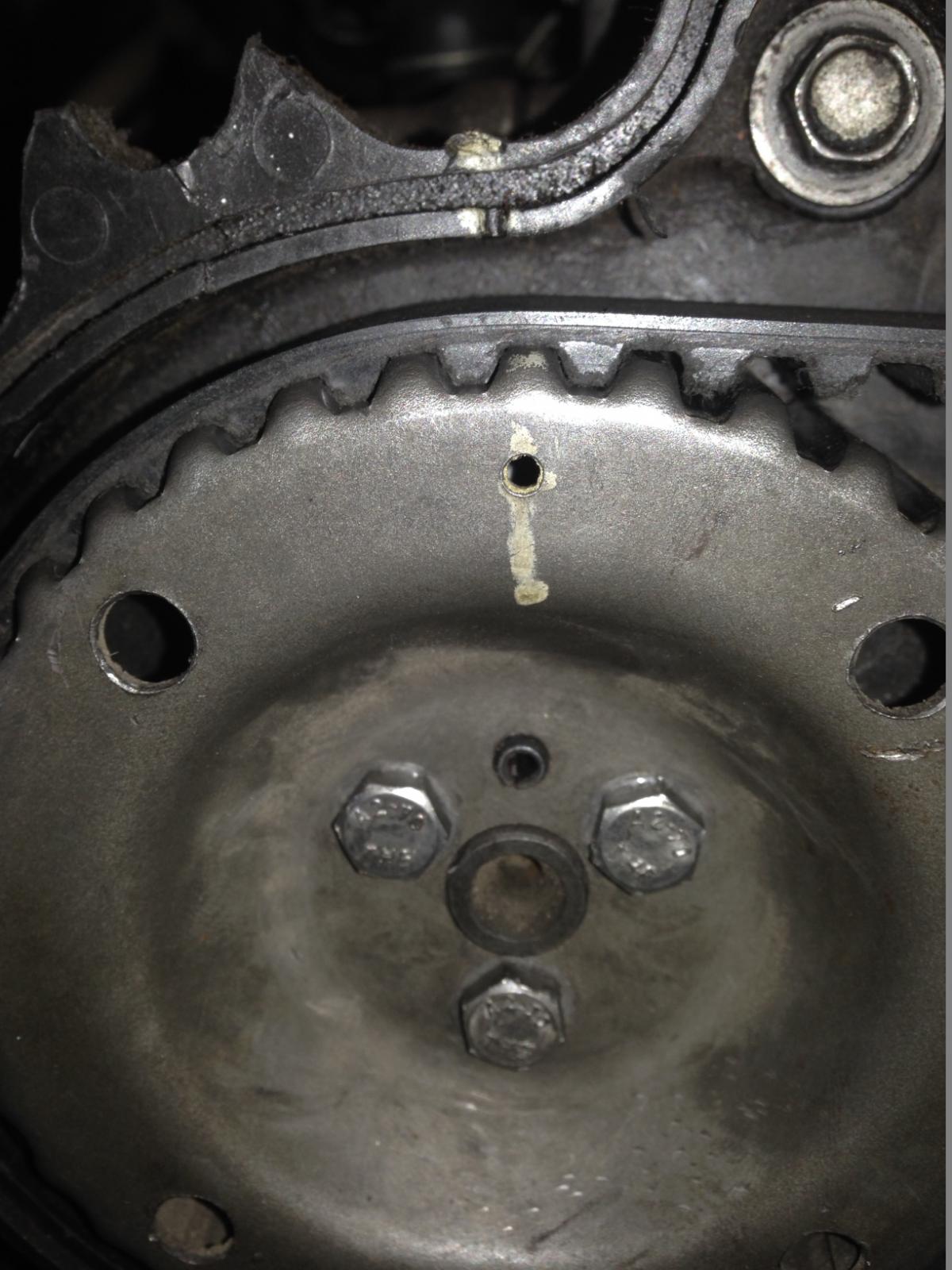

Suba_GL_87 Posted November 6, 2013 Share Posted November 6, 2013 hey northernwestern! i tired to one tooth off but it's seem not right way alignment correctly. it's only half tooth..if it's ok before cover it. thanks. Quote Link to comment Share on other sites More sharing options...
Gloyale Posted November 6, 2013 Share Posted November 6, 2013 Looks right. The plastic notches can be off slightly, it deforms from heat over time. You just want the mark to be straight up. Quote Link to comment Share on other sites More sharing options...
Suba_GL_87 Posted November 7, 2013 Author Share Posted November 7, 2013 everything is good as running after repair seal kits. thump up! ~end of thread~ Quote Link to comment Share on other sites More sharing options...
