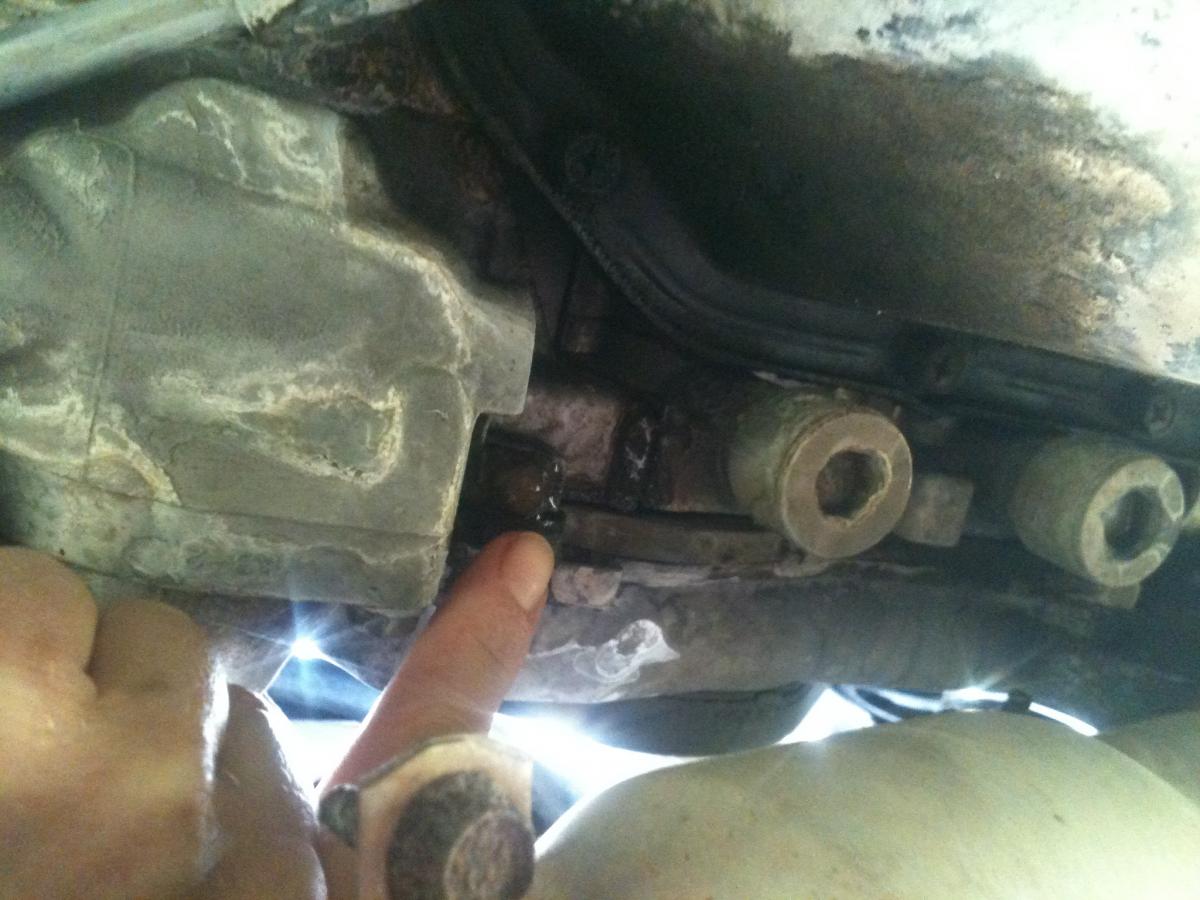

Posted 07 November 2013 - 03:45 AM
Sorry not a very good photo, it looks like its coming out of the rubber seal which looks a bit displaced but I spose it could be running out of anywhere... I was going to try take that plastic timing belt cover off and look in there until I realised what a pain it would be. I read somewhere I need to take the radiator outAttached File  image.jpg   113.92K   82 downloadsAttached File  image.jpg   113.92K   82 downloads

Posted 07 November 2013 - 06:02 AM
that looks to be the timing belt cover.  the rubber on the belt covers are more like dust shields, they are not supposed to have any fluids behind them.
this suggests the water pump or water pump bypass hose is leaking.
if the water pump is replaced a subaru only water pump gasket should be used.  the aftermarket gaskets are cheap cardboard.
generally a complete timing belt kit - with new tensioner and pulleys is advisable. in the US they're $100 - $200 on ebay, amazon, etc for the timing belt, pulleys, and tensioner.

Yes that's the timing belt cover and im pretty sure now it must be pump related, I can hear a kind of rubbing grinding noise from that region so now just to go and visually confirm and order the genuine parts :)...
