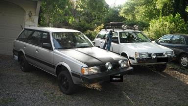

Attached File  2 inch lift on 91.jpg   20.95K   136 downloads
 both of my loyales had 2 inch lifts the silver one has sttock tires on it the white has 195 /75r14 on pugs i think
