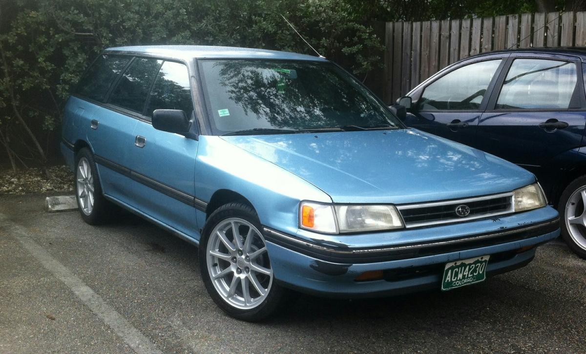

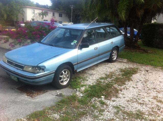

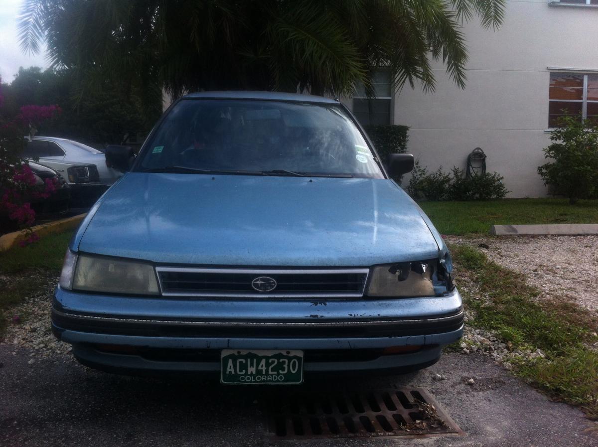

I am a new subaru owner and just want to share my working progress. A friend gave me this car for free and needs some work. Am planning to take it on a 2100 mile trip. I have a few months to get her ready. I replaced one steering boot, 1 CV joint, front break pads, broken head and corner light, polished the taiIights and used rims/tires. Engine runs very very nice and transmission shifts smoothly. The engine was rebuilt around 50k miles ago and the car has about 165000... Any suggestions are welcome!am going to upload more before and now pictures on the gallery...Attached File  image.jpg   137.64K   16 downloads

Posted 25 November 2013 - 06:25 PM
Olnick here are new shots

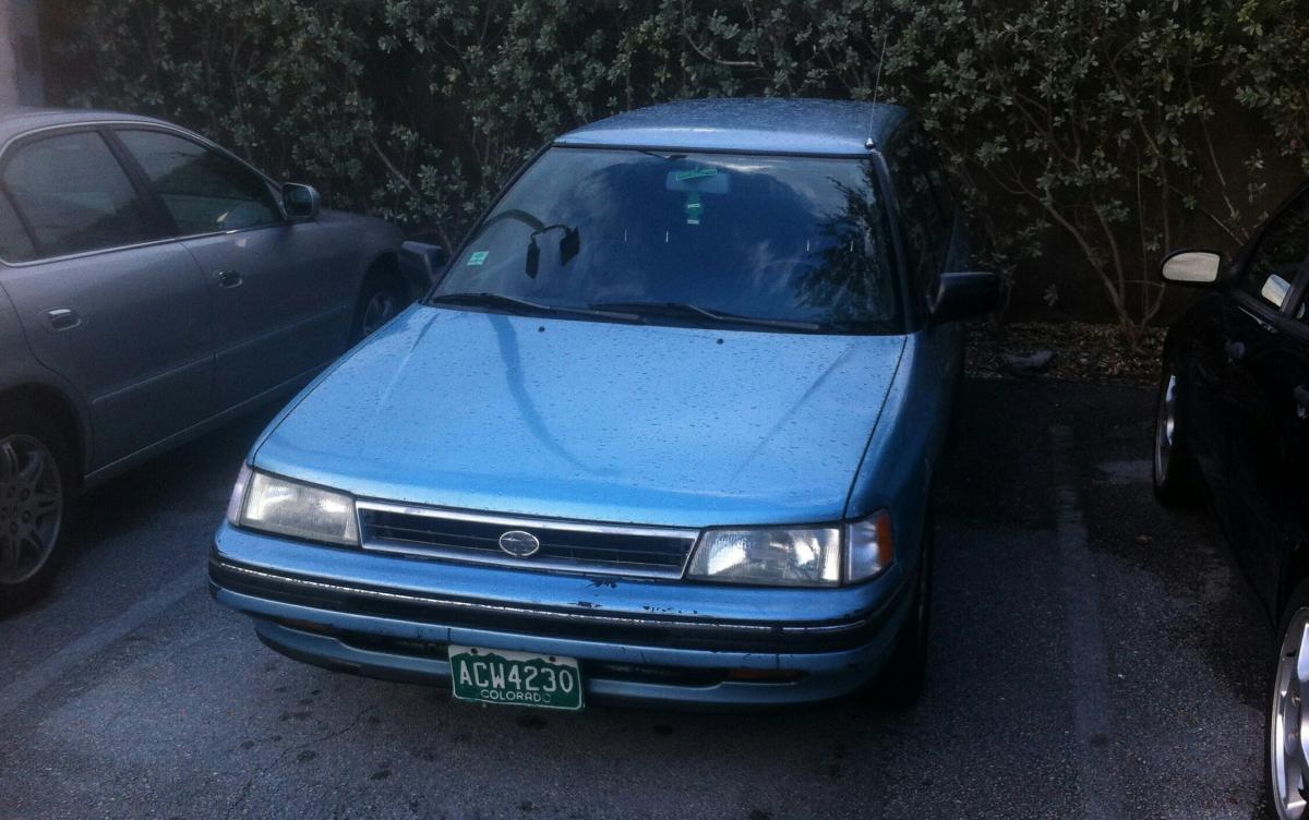

Posted 25 November 2013 - 06:26 PM

Hey, looking gooood!  Nice job on the headlight & fender.

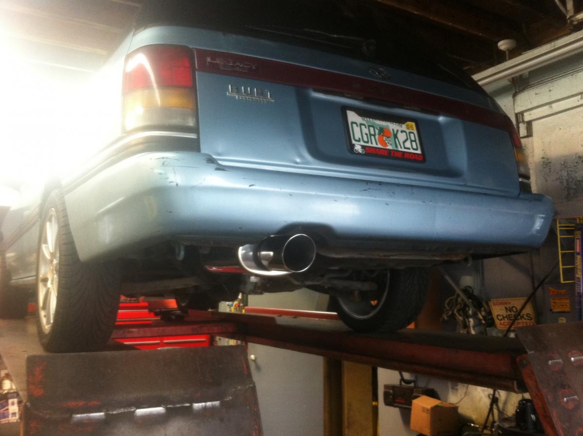

I got all new tires on it the following day! Thanks a lot! I am happy with the car but need to work on some things before my long trip. I took her for a 260 mile trip this week with 4 people in the car and she runs like a swiss watch. I was doing 70-78 mph on 5th gear at 3000rpm depending on the wind. I did mostly highway and when I got home I still had gas in the tank so am probably doing about 280-290 miles per tank. I need to change the suspension in the rear and the muffler. The muffler has some holes that I poked checking the rust and its very loud and it rumbles very deep. I like the sound but I don't want to have that for hours on the road. I am thinking of putting a magna flow oval muffler. Any suggestion on the suspension and muffler? Thanks!

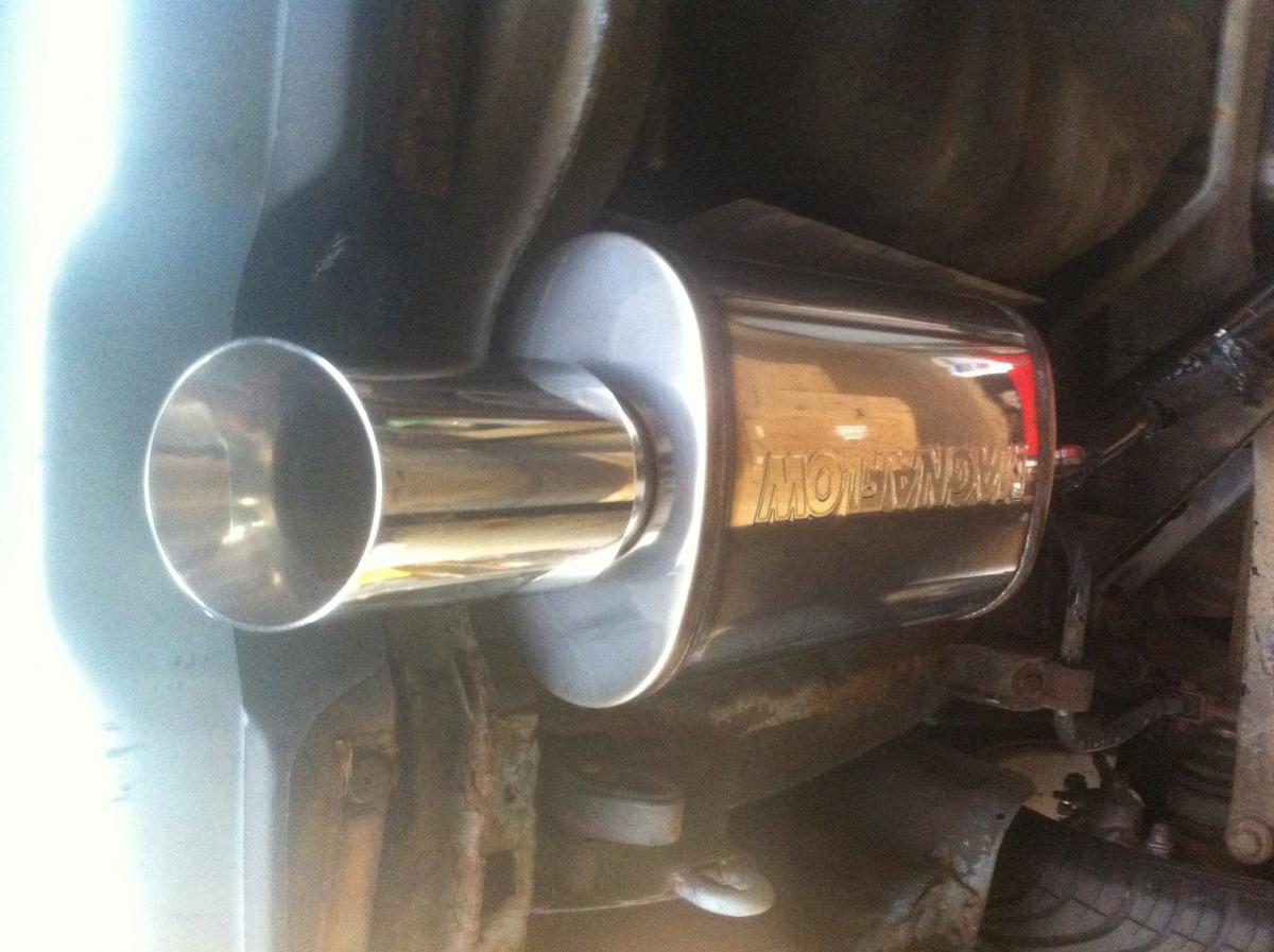

Installed a muffler. Happy with this Magnaflow because it sounds nice and is not loud. Now i need to find a suspension...i dont want to pay 700 for a strutmaster but i dont know what else to do...advice anyone?thanks!!
