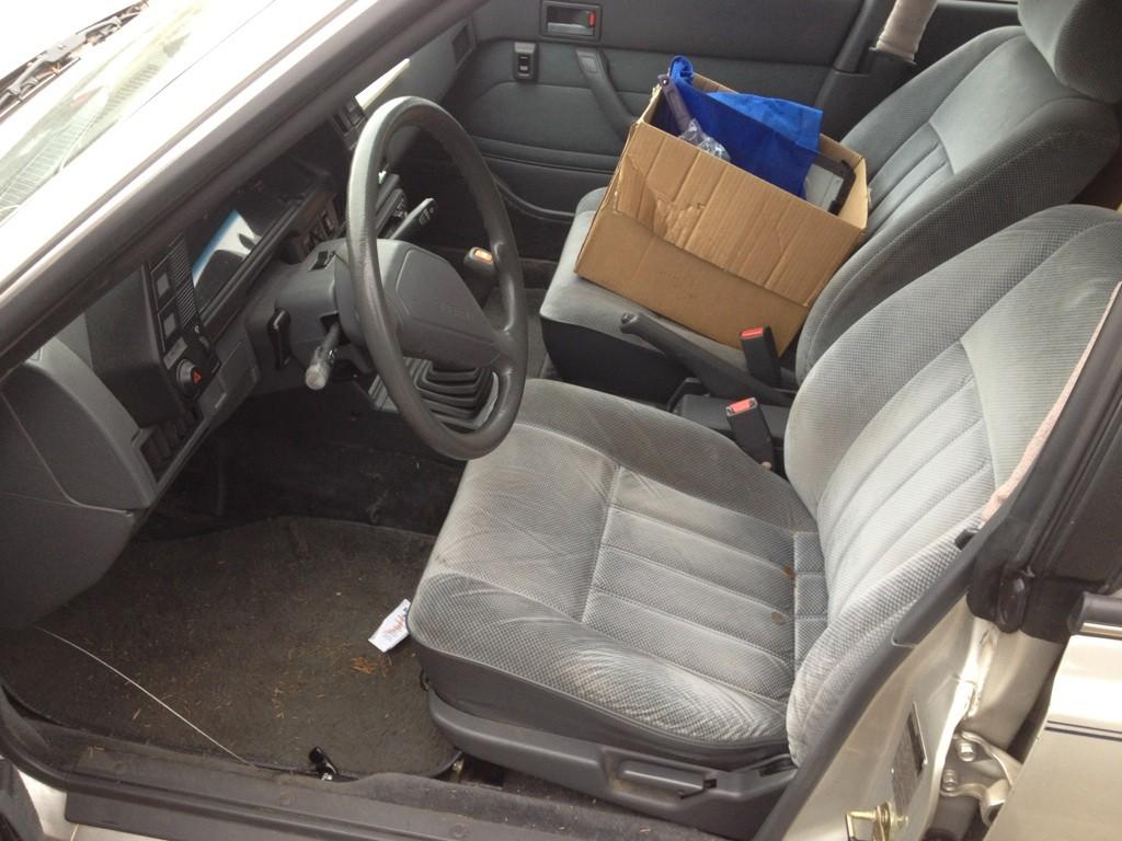

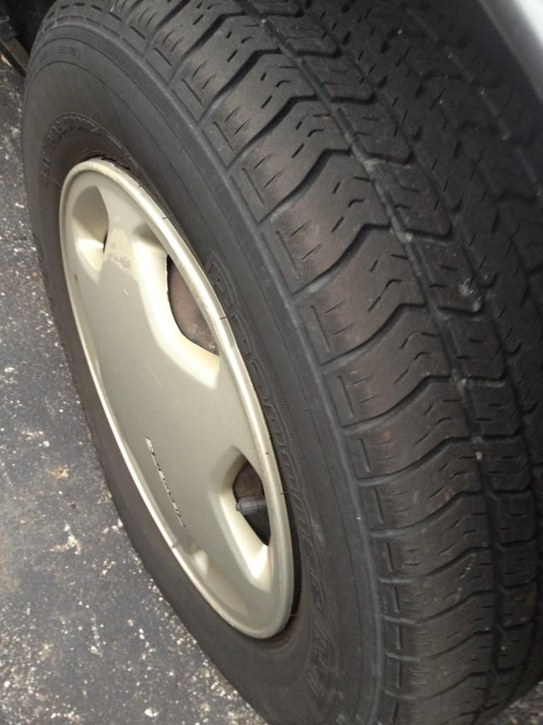

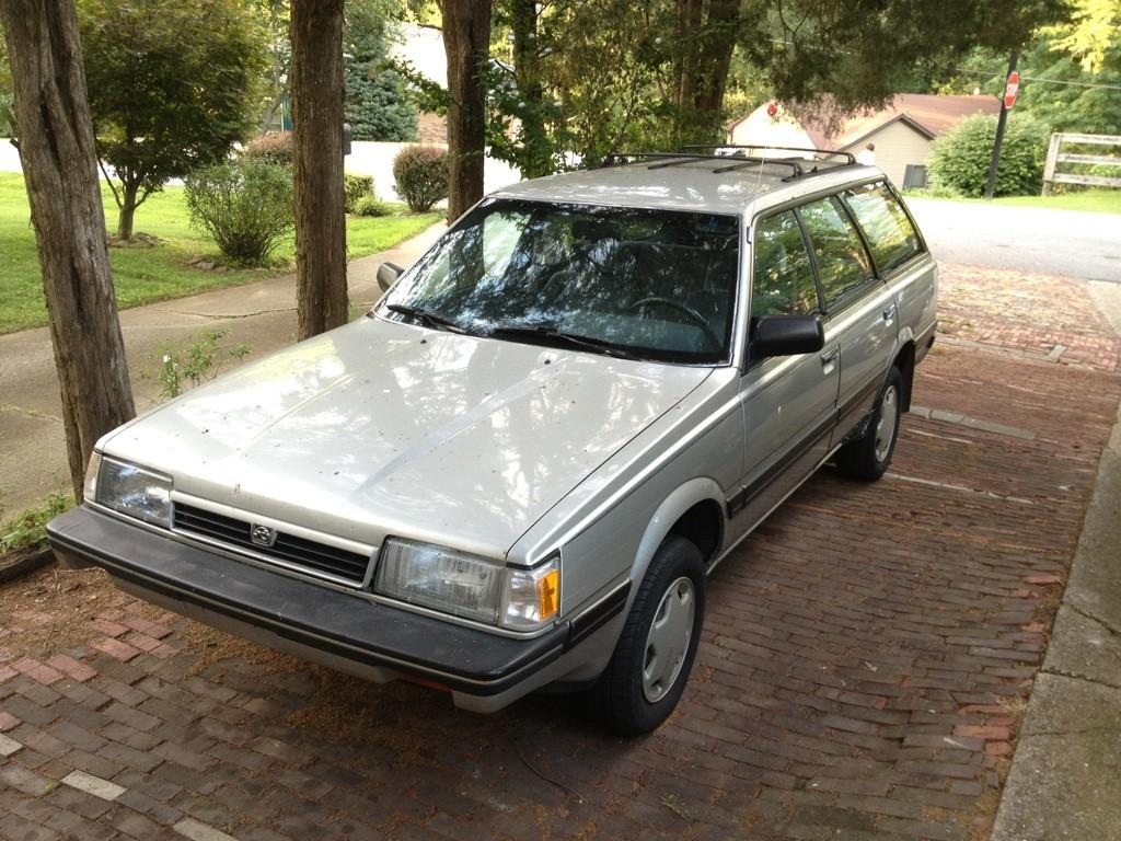

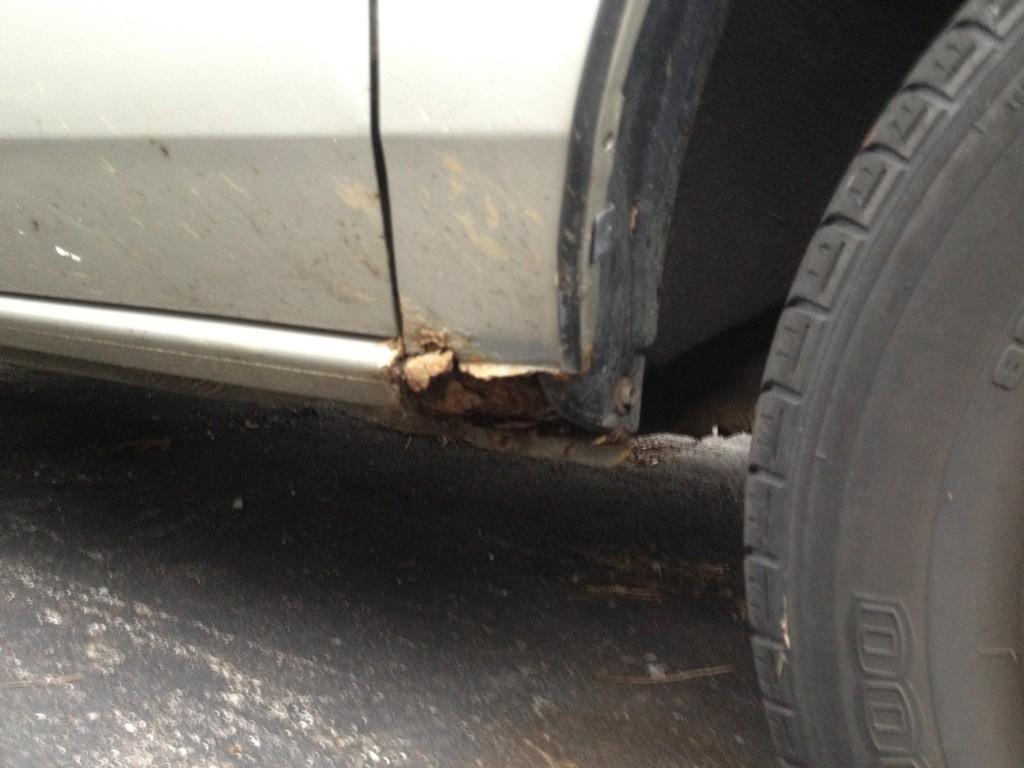

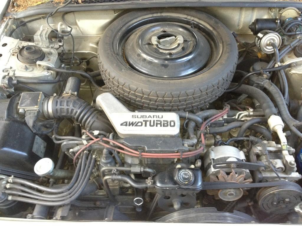

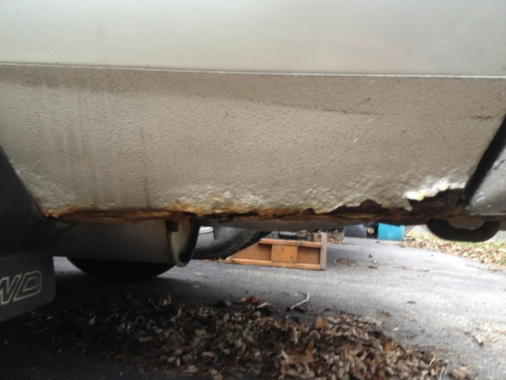

Hi there - soob newb here. New on the forum as well - Nice to meet you all! I am currently driving a Corolla AllTrac Wagon - that is for sale to fund my next project (an 80's Subaru wagon). And this will be my first Subaru. I am currently looking for one - and boy are they hard to come by that aren't rusted to smithereens here in the salt belt. I found one not too far from here - 88 GL-10 with EA82T. 110k miles w/ 5 speed - blown head gaskets per usual. Car was driven by an elderly couple - interior 9/10. Factory roof rack. On factory steel 13s with good tires. Runs as it sits. Body is in pretty good shape - less rust than most in these parts. Rear wheel wells are the most of it. Some rust underneath, nothing that can't be worked with. Rockers are solid - car honestly looks fairly clean for the year (living most of it's life in the midwest) The guy is asking $1000 for it, which seems a bit high to me, but with my minimal knowledge about these cars, i figured i would go to the master resource. Another thing that concerns me is the turbo motor. Historically, are there any added issues to having the EA82T vs the non turbo EA82? Any reason why i should pass and wait for a non turbo? What are the +/- of having the turbo EA82? I am going to check it out in person this weekend (pics and info from current owner) - anything i should look for in particular? What would you guys pay for such a rig? Any input would help - i am stoked to have potentially found a 88 GL wagon in pretty damn good shape. Let me know what you think! Thanks!

when the motor blows swap in an EJ22 for more power and better reliabilty.Dont even think of turning the boost up unless you want to swap the EJ22 sooner.

The turbo version is less neglect-tolerant than the non-turbo.  Cooling system has to be kept in good condition, hoses need to be checked and replaced more often.  The coolant hoses running to the turbo center-section gets exposed to really high heat on shutdown, becoming embrittled and failing spectacularly at times.  HG issues are mainly due to coolant system issues.  When you do the HGs, look at where the HG's fire-rings rub against the head and block: If yo can see where they contacted the surfaces, then you should surface the heads to get rid of the wear/indentations of the fire-ring.

I would see if the owner would accept 6 or 700 dollars for the car since the heads are bad and is a common issue with that model. If you purchase it consider replacing the heads with the latest version and only use genuine Subaru gaskets. You might consider replacing the radiator also when doing the repair.
Other common problems to watch for is the alternator and the ECU fuel pump circuit. A driver transistor can fail in the ECU and the pump won't work. There are past posting about that problem. I have fixed two ECUs with that problem in the past. One of them was on the second car I purchased and the other one I fixed was for a local shop that I went to for help on this problem before I found out what was really wrong. Their replacement ECU had the same problem mine did. They were going to throw it out so I asked them for. After I found out the bad transistor in my unit it was easy to fix their unit and I gave it back to them. This problem occurred in my car after the alternator was replaced. As soon as the engine was started it then died. I assume the higher charging voltage from the replacement alternator killed the weak transistor.

After owning a turbo ea82 I would say buy the car for the body and the interior, not the engine. It's a little too finicky for my taste, and you don't really get any more power with the turbo. For $1000, hell no. You can buy a running legacy for that price with a newer and better motor in it. $500-$700 is all I would pay for that one, in the condition it is in, and only if the exterior where rust free and the interior was in perfect condition. Otherwise, just wait it out man, don't get too excited and buy something that is just going to be a pain, IMHO. I would try to get the car for $500, and then take the other $500 you saved and put it towards an EJ swap and then EJ swap it right away and be done with it. Much better use of you time and $$ then rebuilding the turbo motor that is most likely going to blow again.

Over 10 years ago I would pay $300-400 for one like this RUST FREE (though they are more common in Oregon)  I think $1000 is way too much.  The miles are irrelavant in my opinion as its still an old car and will still need head gaskets and all engine seals / hoses if you decide to rebuild it.  The one hose you don't change when you have the engine out WILL CRACK AND LEAK.
Thats not a GL-10 either... its just a turbo GL
A GL 10 would have the upgraded interior, digidash and sunroof (and maybe surviving air suspension)

id go for 1000 if i had to. 5spd turbo gl-10 is a nice car. but 600-800 would be a good deal on that nice car, head gasket considered. perfect the cooling system while you have it apart doing the gasket
