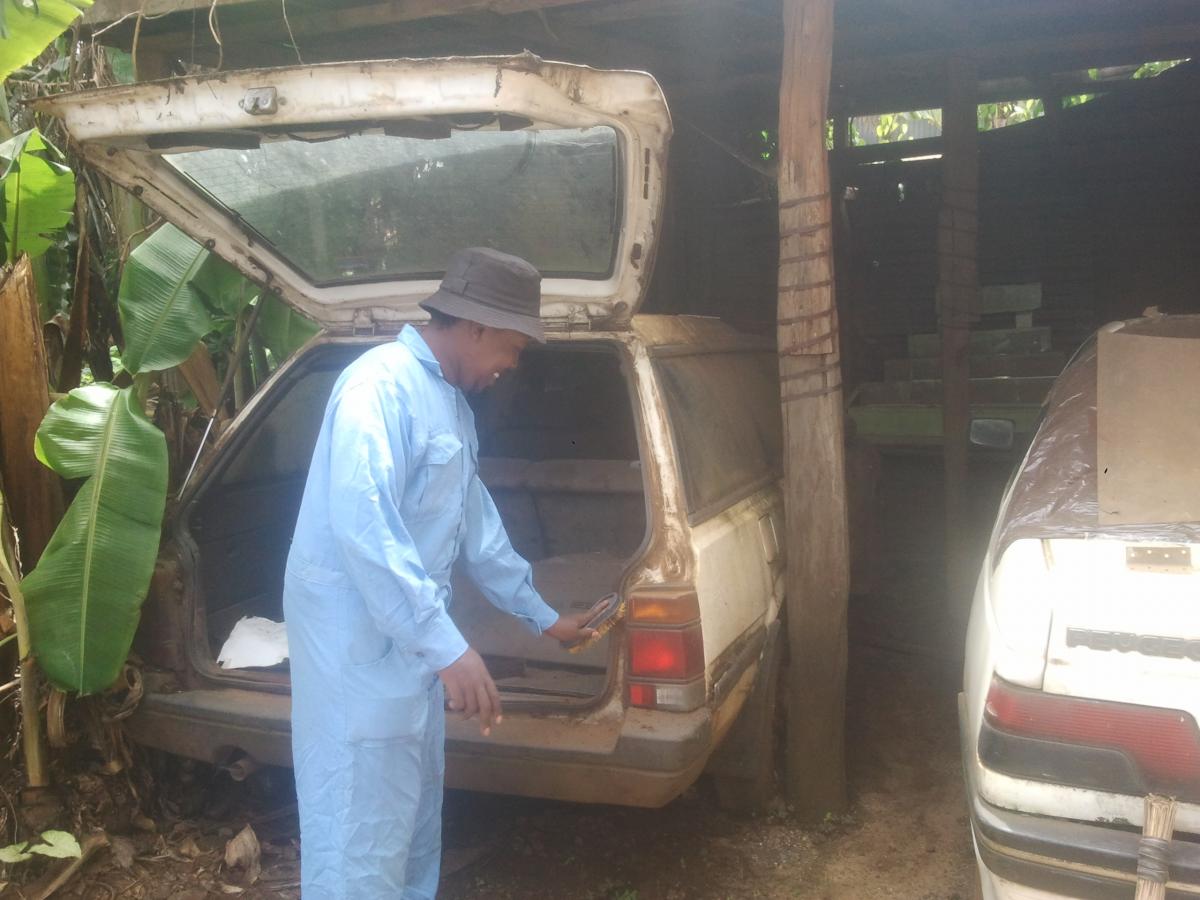

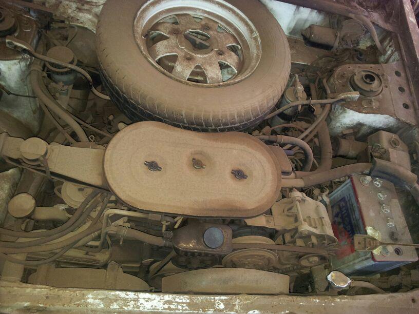

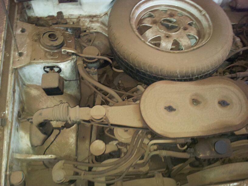

Hello to fellow subaru ehtusiasts, i am writing from Thika in Kenya.
I recently rescued a Subaru Leone forgoten/ abandoned in a friends farm shed.
after consulting my 'Tree shade' mechanic he sugested i replace the old engine with an ej15 engine.
after scouring around i did find one for about 300 $ but with no ecu n harness.
i was planning to visit an accident write-off yard to get the ecu and harness..
or am i better off overhauling the ea82 engine?

Great Find!  It looks like a touring wagon too!  You might like the EJ series engine better, but the old EA82 is a good engine as well. You can't go wrong either way IMO. Could you post some more pictures of it?

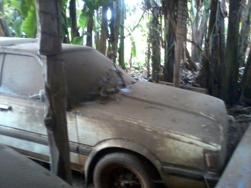

yes its a wagon, i think i will go with the ej15, but the wiring loom is proving tricky to find locally..
i guess its back to the junk yards for the next few days, fingers and toes crossed!
and sure i can put up a few more pictures..
and its coated with like 10 kilos of dust!

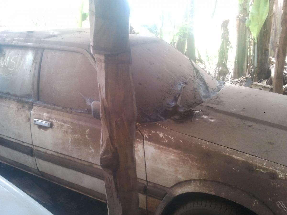

hard at work yesterday trying to scrub off the dust...

Welcome aboard, karuri!  And congratulations on your great find--looks to be in pretty good condition.  What year is it?  How many miles on it?
Personally I'd overhaul the EA82 before jumping into an engine swap (but that's just me!)
All the best on your project--and do keep us up on your progress.  BTW your pictures are great!
