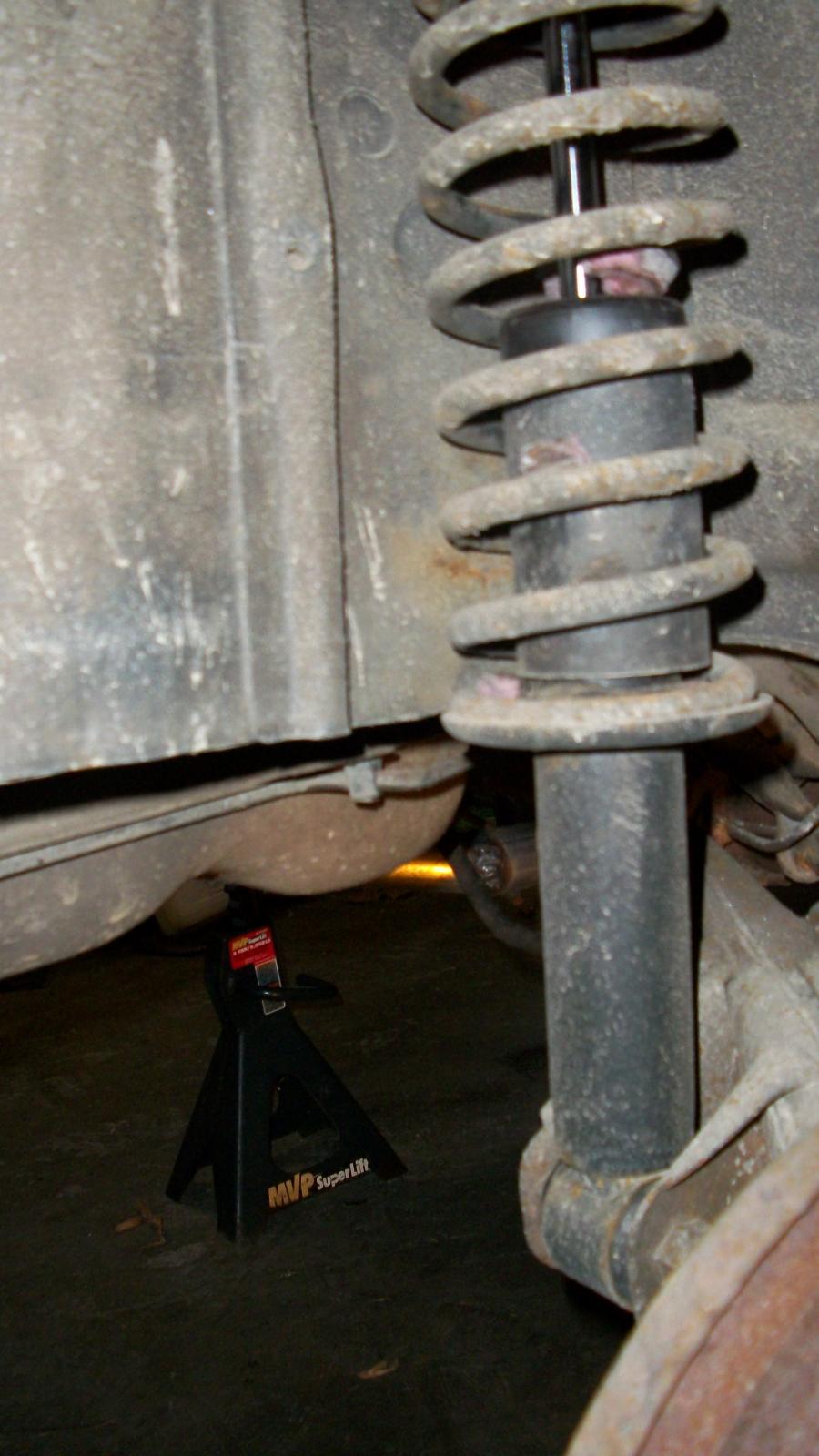

rlpete Posted December 31, 2013 Author Share Posted December 31, 2013 Both sides seem to be pretty even, and the wheels do not seem to be leaning in at the top. The strut seems to be the correct ones from the description. At this point I am thinking the springs are worn out, is this a dealer item or does anyone have any suggestions where to but them? Thanks, Quote Link to comment Share on other sites More sharing options...

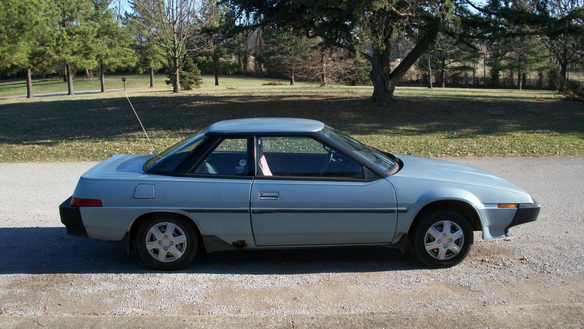

ruparts Posted December 31, 2013 Share Posted December 31, 2013 hi, that looks like 2wd rear shocks you have on there. however just looking at the pic of you car, it looks like the front is a bit high, at least in that pic and my opinion. if it has pass car or wagon front struts on it that raises the front some and would tend to make it appear like the rear is low?? the rear looks right for a 2wd judging from the wheel opening and the amount of tire exposed, the front on the 2wd xt sits pretty low, the pic of your car appears the front is up in my opinion. Quote Link to comment Share on other sites More sharing options...
rlpete Posted January 1, 2014 Author Share Posted January 1, 2014 I have replaced the struts on the front, and I bought the ones that are specified for this, I have new struts for the rear also but wanted to make sure on the ride height before I changed them. The new front struts matched the ones that I removed so I assumed that the front was correct. The rear is so low that it can drag on a larger speed bump but if I could bring the front down that might correct the issue. Every XT that I have seen has sat up high, but to the best of my knowledge this is the only 2WD one I have seen so if they ride lower than the front that would be good to know, does anyone know what the ride height specs are? Quote Link to comment Share on other sites More sharing options...

rpholz Posted February 2, 2014 Share Posted February 2, 2014 Holy crap, you have a DL. Just like my first XT. From the way it's sitting it looks like you have 4wd struts on there 1 Quote Link to comment Share on other sites More sharing options...
jono Posted February 3, 2014 Share Posted February 3, 2014 Only five weeks late with the specs..if anyone needs them for the 2WD XT rear is 203mm ( +10 , -20mm ) The 4WD is 250mm Is measured from the underside of the tubular cross member pipe that the swing arms come off, measured at the outer ends to flat ground Quote Link to comment Share on other sites More sharing options...
rlpete Posted February 4, 2014 Author Share Posted February 4, 2014 Jono, Thanks for the specs, as soon as the snow melts I will get under it and do some measuring. rpholz, I have put new struts on the front, and there were supposed to be for the 2WD. I will see if I can get a number off of them and see if they looked them up correctly. Thanks for the help. Quote Link to comment Share on other sites More sharing options...
Loyale 2.7 Turbo Posted February 4, 2014 Share Posted February 4, 2014 (edited) ...From the way it's sitting it looks like you have 4wd struts on there ...I have put new struts on the front, and there were supposed to be for the 2WD... I Believe that rpholz is Writing about the Rear, not the front. If you look the Photos of the 2WD Vs 4WD rear struts that are on the Link I posted above, you'll understand why... Kind Regards. Edited February 4, 2014 by Loyale 2.7 Turbo Quote Link to comment Share on other sites More sharing options...
rpholz Posted February 5, 2014 Share Posted February 5, 2014 Correct, although I believe 2wd XT struts were the shortest front strut you could buy. But in short I don't trust any aftermarket company to have correct lengths. OEM is the only route I would take in a stock strut/shock setup 1 Quote Link to comment Share on other sites More sharing options...

rlpete Posted February 8, 2014 Author Share Posted February 8, 2014 Got a chance to get under the car and do some measurements, I get 7 1/4 inches or about 184 mm, that seems to be on the low end but with in specs that Jono gave. Can someone tell me where the correct place to measure up front? As for the aftermarket shocks, Over the last 30 years I have not had problems with aftermarket but this is the first Subaru for me. The ones I have purchased are Gabriels. For the front G67739 and for the rear G51173. They match up to what was on the car when I bought it but I did not check to see if they were OEM or not. It did ride like this when I got the XT about 6 months ago. If these are incorrect it is not that big of a loss because I found them on clearance and only paid $14 for each front and $9 for each on the rear. Thanks for all of the info, I am learning alot about this car on this forum. Quote Link to comment Share on other sites More sharing options...

rpholz Posted February 9, 2014 Share Posted February 9, 2014 The Gabriel strut is the problem, pick up some kybs (as they produced the original subaru shock in the first place) and go from there Artrat- I'm not arguing, I am dismissing the incorrect information before the OP goes the wrong path and waste time and money. And the 5 lug swap for the last time WILL NOT MOVE THE MOUNTING POINTS IN THE REAR, the front is a whole other ball game 1 Quote Link to comment Share on other sites More sharing options...
idosubaru Posted February 10, 2014 Share Posted February 10, 2014 may want to replace the springs while you're at it. the springs take more load and get compromised when the struts do no work. i had one like this last year or two years ago. replaced the struts and had sagging/rubbing/handling issues in about a month. the spring was compromised, replacing it solved the issues. it physically looked the same as the replacement spring but with all the driving on tire struts i'm told that probably strained it too much. or at least do the job sooner rather than later to save the existing springs. Quote Link to comment Share on other sites More sharing options...
