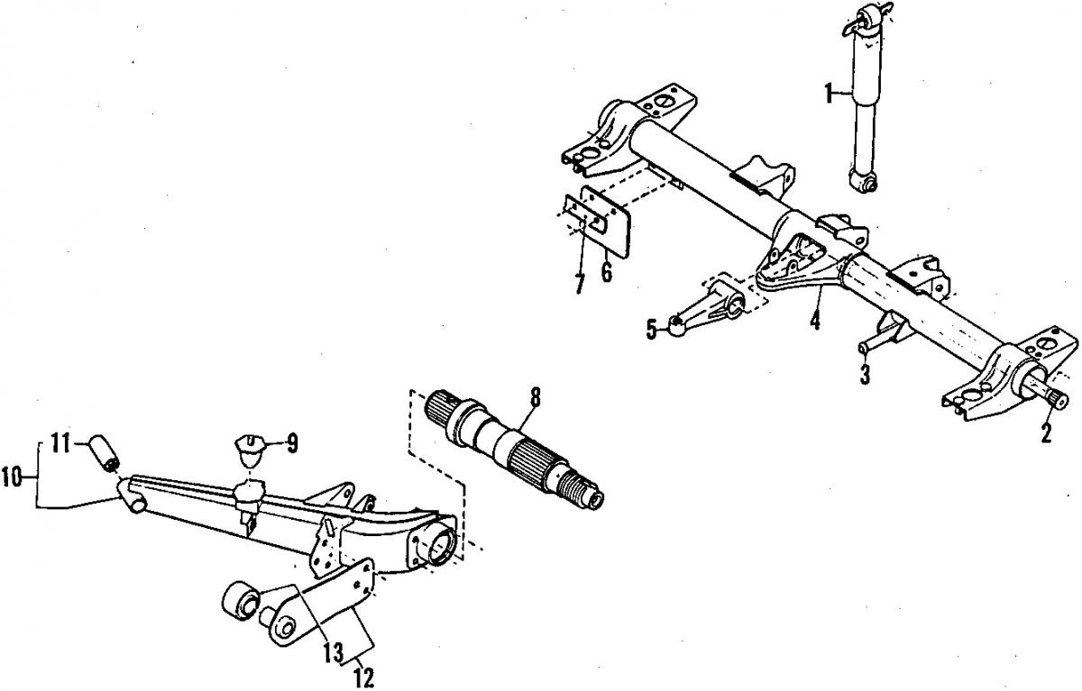

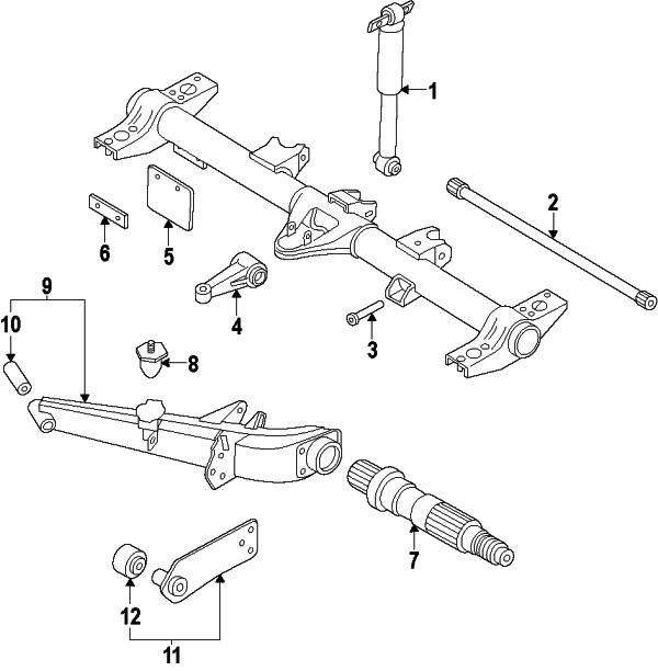

I may have found a right trailing arm, but it's for a justy 2wd, I was reading in the Haynes book that they are similar, their print pictures seems similar as well, any one know if it is compatible with the brat.

The one on the left is a Justy, the one on the right is a brat.

Justy parts will not interchange
