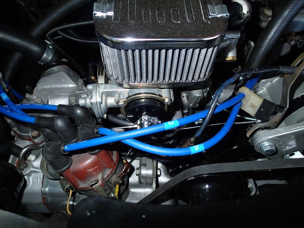

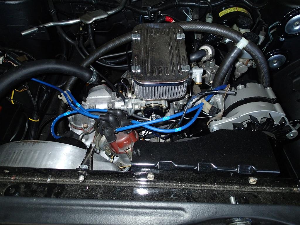

Does anyone have any experience with a Weber offroad carb on the BRATs? Do they typically dump fuel into the primary? Is there an exact way to route the vacuum lines considering the stock carb required more vacuum connections?

It has been a while since I have posted on here. I was having issues with the electric choke on the Weber Carb since I last posted. I ended up replacing the electric choke with a manual choke and now I have control!!! The Weber seems to be operating properly now with the new choke and the placement of the vacuum hoses.

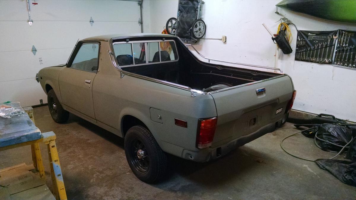

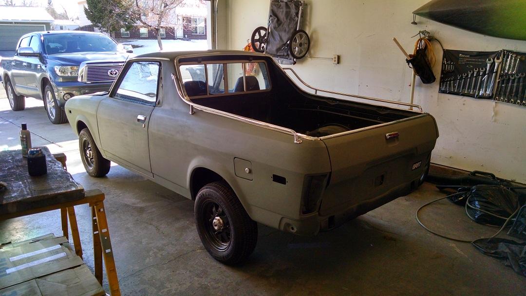

Posted 05 July 2014 - 04:06 PM

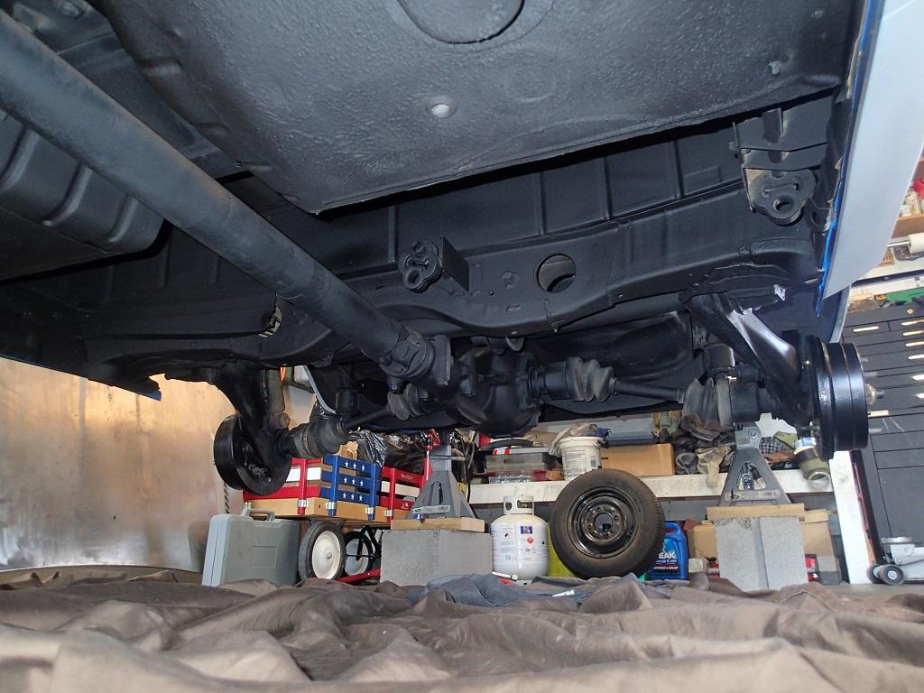

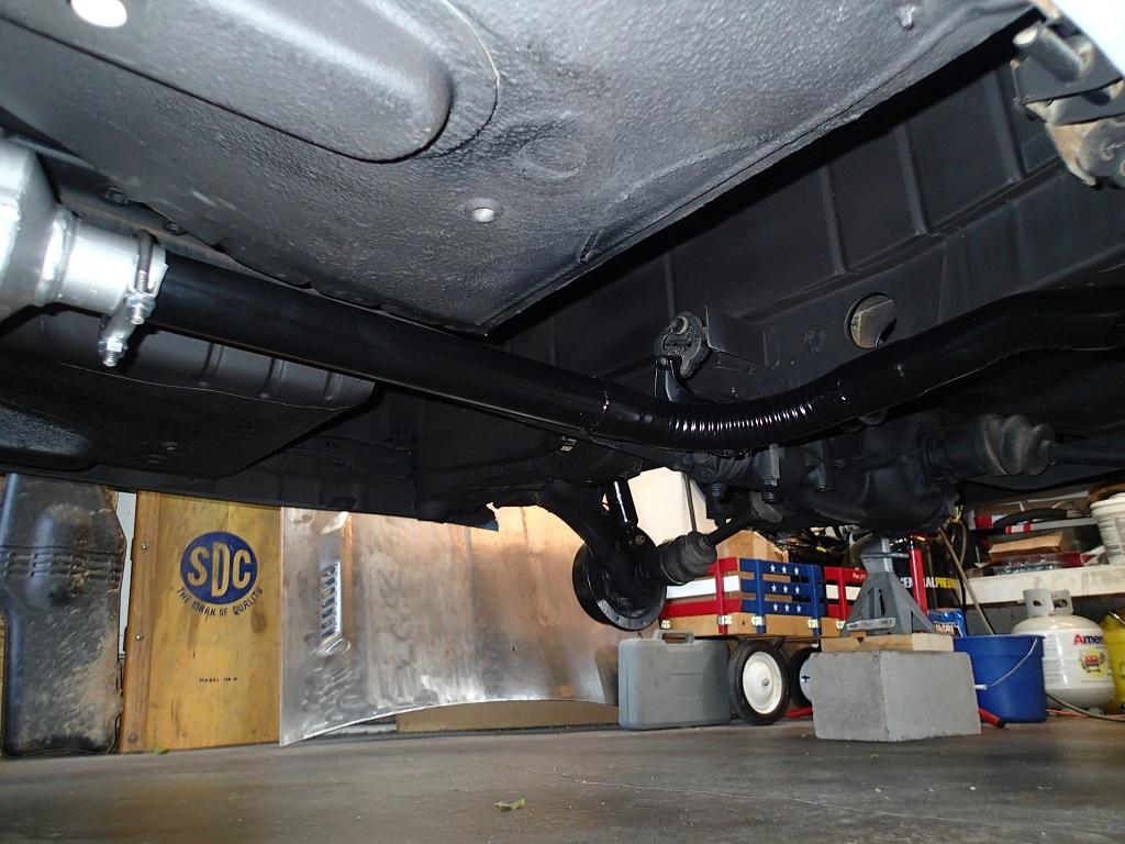

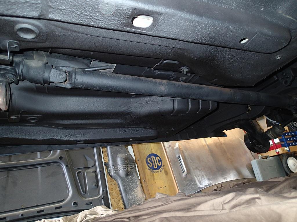

Once the choke was figured out I decided to put the BRAT on ramped and block up the back... I pressure washed the hell outta it and scraped the stuff with edges. I rust-reformed it all and still in the process of undercoating it. I am gonna leave it on the ramps so we can fab an exhaust. Any recommendations on a muffler to replace the pre-muffler under the driveshaft? I think I am gonna run one new age muffler rather than a pre-muffler and a muffler. Ideas?

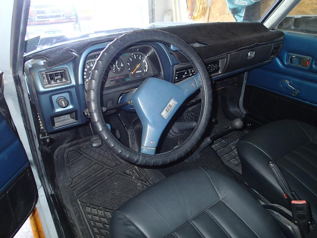

Posted 05 July 2014 - 04:20 PM

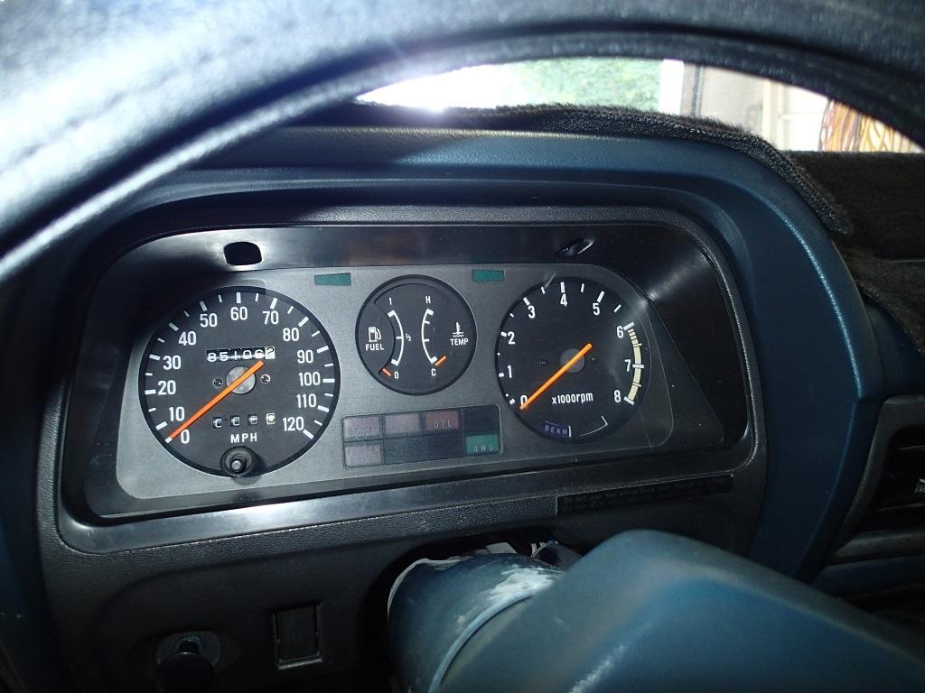

And.........I also replaced the gauges. I went with the BRAT gauges with a tachometer. I had to run a new wire to the coil, but it works flawlessly! Plus, they are way more sexy.

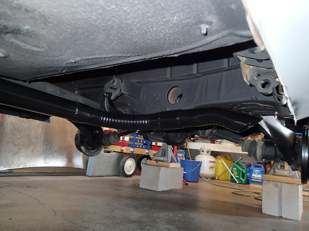

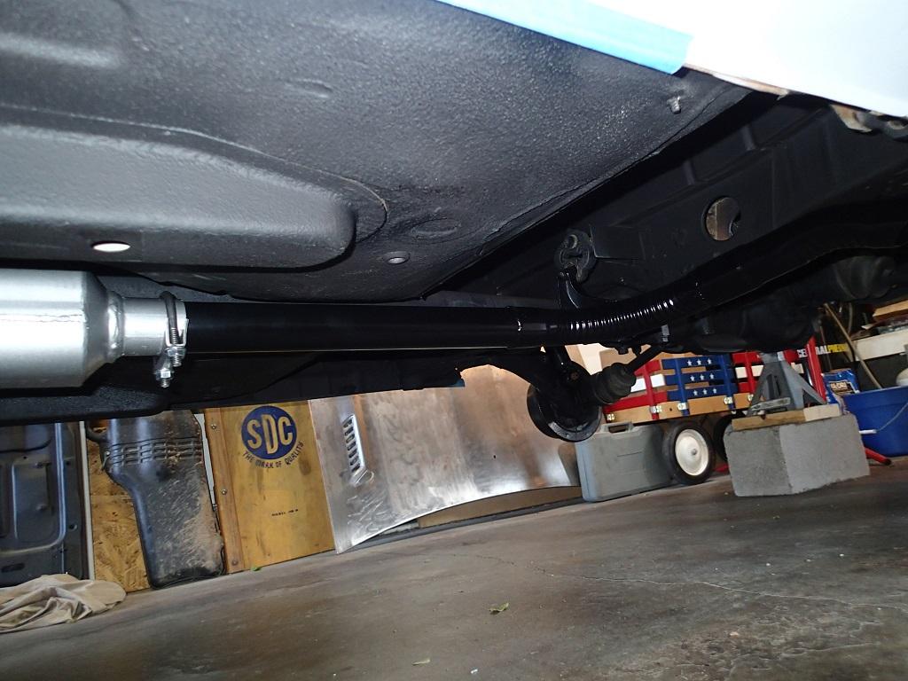

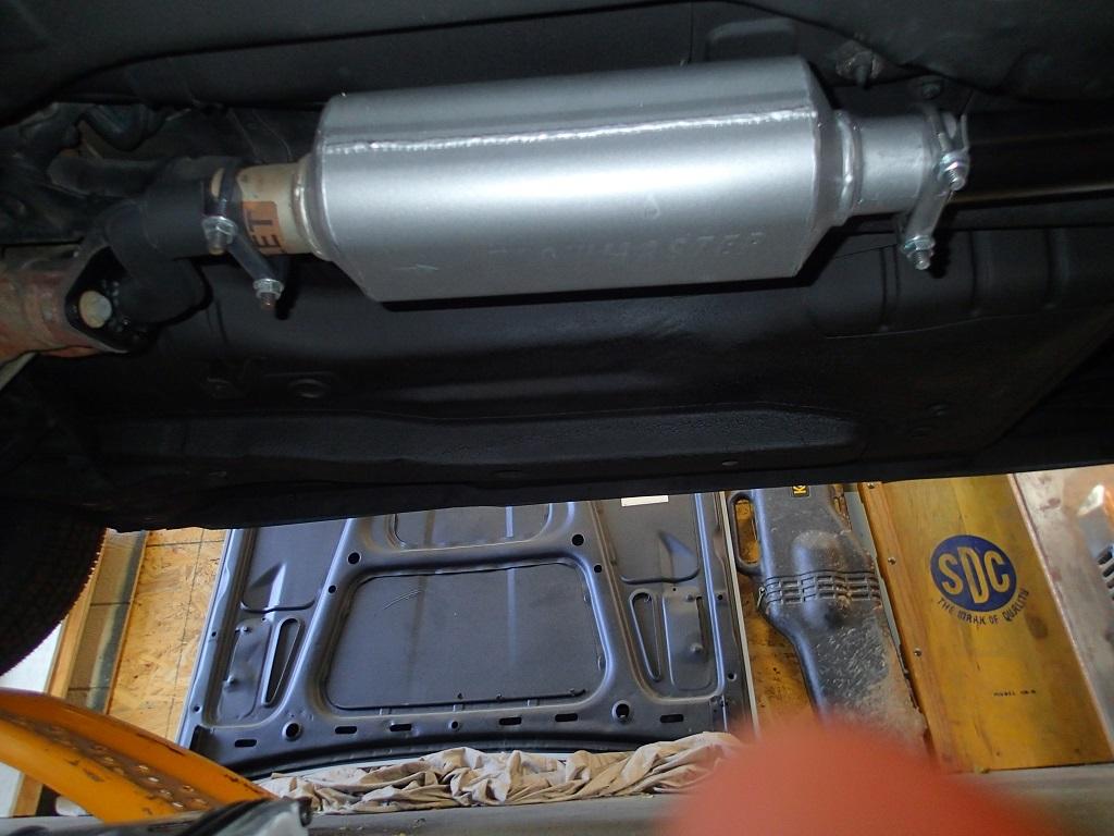

Posted 09 August 2014 - 08:56 AM
I finished the exhaust this weekend! I decided to go with the FlowMaster HP-2 Series muffler. I also decided to take the tailpipe out of the driver side instead of running it under the CV and out the back.

Glad you got it worked out.. Nice build.  The electric choke on mine would do the same thingmy problem was I tapped power from the wrong thing so it never worked. Once I figured that out it ran like a champ.
  I am not sure about the 78s but the pre muffler on the newer cars is a resonator which helps knock down some of the drone at higher rpm.  So how does it sould the flowmaster? got a clip?

Posted 11 August 2014 - 08:32 AM
Thank you! I like having the control with the manual choke more than the electric choke. The Flowmaster definitely sounds more aggressive and a bit louder than stock, but overall it sounds pretty good.  The clip I have is with the BRAT sitting in the garage, so it echoes more. The sound in the clip isn't completely accurate.

Hey guys! I have been away for a while and now that I am back I have something to ponder with yall. I have an issue with my BRAT and if yall have any advice or have experienced the issue I would love to hear it.
It all started shortly after my EGR tube failed and the accelerator pump on my Weber carb failed. I could not get the brat to start unless fuel was poured into the ccarb and it was ran with the choke fully engaged. So.....I will break it down by series of events to follow:
1. Replaced the EGR tube and accelerator pump on the Weber. (problem still persisted)
2. Replaced the original fuel pump with a new one from rockauto. (problem still persisted)
3. Rebuilt the Carb (problem still persisted)
4. Checked/cleaned the sparkplugs which were covered in carbon tar (problem still persisted)
5. Drained the gas tank and replaced fuel with fresh fuel +some stabil for removing moisture (problem still persisted)
6. Replaced all of the fuel hose under the hood with new hose and fuel filter (Problem still persisted)
I think I have pretty much eliminated a fuel issue. Any more thoughts on what might be the issue with my BRAT? Before the initial problems the BRAT was running great. It idled around 900 rpm and had very nice throttle response. It didnt smoke or run rich. I am looking for assistance trapping the gremlin! Any words of wisdom are greatly appreciated!!!!
