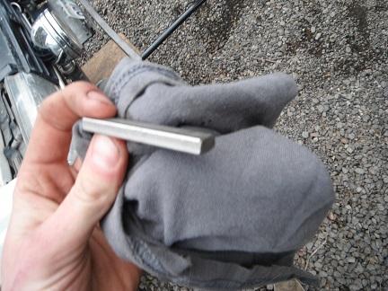

Prwa101 Posted January 5, 2014 Share Posted January 5, 2014 I used a 1/4" piece of rebar on the end that the gap is. Tighten us down good. Can't find a picture though. Good luck. Quote Link to comment Share on other sites More sharing options...

el_freddo Posted January 6, 2014 Share Posted January 6, 2014 I made a set of shims from two shims used in the steering column of old holdens - these still needed to be ground down a fair bit. If you had some flat bar steel 4 or 5mm thick you could grind yourself a set - just takes time. Be sure to drill the hole first, otherwise drilling on an angle after grinding will be fun...I've never had an issue with engine mounts, but I've always run these shims too. I'm currently running the EA82 engine mounts in the front hole of the EJ engine mount plate and have sleeved the gearbox crossmember holes for the gearbox mounts. This effectively pushes my drive train back about 15-20mm; so far that I've found the back of the sump rubs on the engine crossmember (now that I've got the engine out) - no noise there though. I've heard to avoid the round engine mounts like the plague for an EJ into an L series/MY as they don't last long. CheersBennie Quote Link to comment Share on other sites More sharing options...

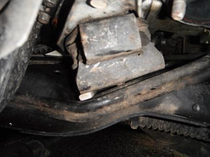

92loyale59 Posted January 7, 2014 Author Share Posted January 7, 2014 so i figured my problem out. when i made the custom length pitch stopper i made it about a 1/4 inch to long and the old wore motor mounts didn't hold the engine where they were suppose to. so when i installed the new mounts with a 1/4 inch shim again the pitch stopped was too lond . so i cut and welded it shorted and now it fits. so i would say make sure your motor mounts aren't so worn that it makes the engine sag forward . ... here is a picture of the shim and the old mounts installed with the shims Quote Link to comment Share on other sites More sharing options...
monstaru Posted January 7, 2014 Share Posted January 7, 2014 (edited) Brand new engine mounts without a transmission will sag forward. Yours were being pushed forward. There is a reason the original pitch stoppers had adjustment. I usually use a 3/4 inch piece of threaded rod, sleeved to the original firewall bushing. cheers Edited January 7, 2014 by monstaru Quote Link to comment Share on other sites More sharing options...
