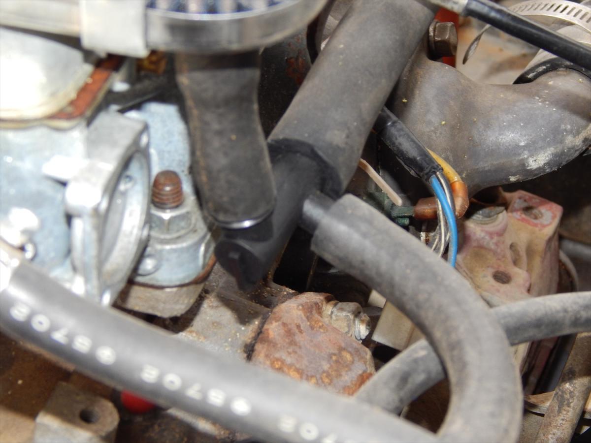

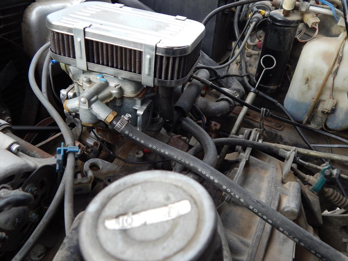

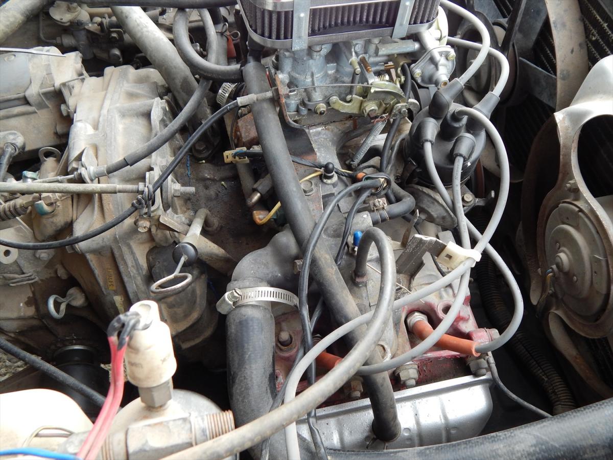

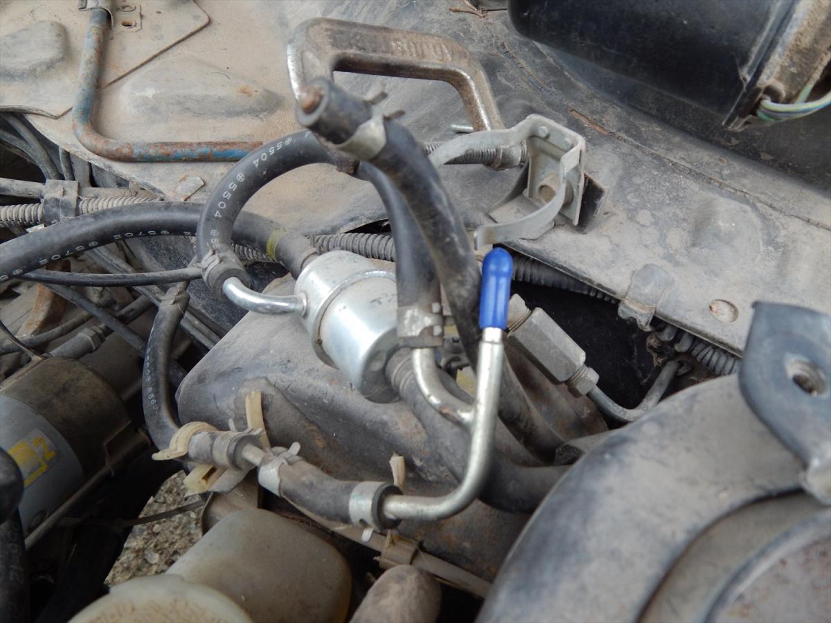

Just went out to look at the Brat.  The disty is hooked correctly to the carb.  The oil cap will not blow off but just floats on the tube.
I am still wondering about the distributor.  The shaft was wobbly but not terrible.  It is not eating caps.  I do remember once that one cylinder dropped out of firing and when I pulled the plug wire, it really showed no difference in the idle.  I think it was the bad compression cylinder.  I put it back together, wiggled wires and the next time I started it, the miss was gone.  I still hear a slight spitting in the exhaust.
Here are some pics from my PCV routing, EGR block and fuel return lines.
Brat Engine 1 shows how I hooked both valve covers, air box and PCV.
Brat Engine 2 shows it again from a little farther back.
Brat Engine 3 shows my current fuel set up (temporary)  Do I need to hook the return line from the filter to the return line from the tank?
Brat Engine 4 shows the plumbing again from the other side.

The PCV breather routing you have is incorrect.
Just hook up all three (PCV, and both Valve cover vents)
to the hole in the base of the Weber filter.
You also have NO fuel return line coming from the carburetor.
Remove the single brass fuel fitting from the weber,
and replace it with the stock Hitachi fitting.
(which has provisions for a return line)
Connect the return line to the main shaft of the
The "Y" with the vacuum cap on it.
The curved side of the "Y" is proper.
Edited by Greenley, 14 January 2014 - 09:58 PM.

On mine, even with the hitachi return line installed, i had too much fuel pressure and had to install a regulator to keep it from constantly flooding at idle.

So on the return line, if I hook back into the main line of the "Y" fitting, where does that go when the ling goes into the firewall?  Should I leave the other line to the tank plugged like it is in the picture?
As far as the valve covers hooked to the filter base.  Right now it comes from the passenger side into the "T" with one small side into the breather, the other side splits off and into another "T" one side going to the PCV and the other to the other valve cover.  Basically it is all connected together but in a convoluted kind of way.  What do you suggest?  A "T" connecting both valve covers, then the third side to another "T" that one side goes to the PCV and the other to the breather?  It is hard to explain in writing but thank you for your help and patience.

you do not want all 3 ports hooked together.  you want clean air to enter on the passenger side valve cover area.  you can plumb it to the air cleaner or just get a breather cap, whichever.  the drivers side should go to the pcv valve.  you do want a small hose T'd in between the drivers side head and the pcv valve, but its only there to allow some fresh air in and reduce the suction on the drivers head.  again plumb i to a filter of some sort.  normally theres a small foam filter in stock air boxes so that these 2 hoses aren't pulling from the same air supply.  if theres no fresh air inlet then you won't clear enough bad gases out and if theres no air inlet between the head and valve then you will drink oil.
you mention replacing the fuel pump, are you sure it was for a carbed car?  fuel injected vehicles have a very different fuel pump stats.  webers are sensitive to fuel pressure, so check what the pump is putting out.  it should be very close to 3 psi.  you have a return line hooked up currently, its the second line coming off of the fuel filter in the engine bay (doesn't matter if its on the carb or filter).  what I don't know is if you have the tank vent hooked up correctly.  the 3 lines in the front are fuel in, fuel out, tank pressure vent.  fuel in is easy to tell, but you may or may not have the other 2 switched.  even if it is hooked up correctly your tank vent may be plugged off.  if so and you haven't changed gas caps to allow for some tank venting it can mess with your fuel delivery.

Thank you so much, it makes sense the way you state it.  I do think that I may be pushing some oil out of the passenger side valve cover.  It is pretty messy and there really should be no reason for that.  I will adjust my hoses accordingly.  I will work on that today.

So should the small 3rd line out of the filter (currently c clamped) should go to the plugged black hose (Not the blue cap, but the one with a bolt in it at the top of the c clamp area) which would be a return line?  What is the line that goes into the firewall?

Looks a little random there around your fuel filter :confused: . Try plumbing it like this: The weber in this pic is reversed, but you can see all the parts. The fuel 'y' fitting is on the d-side, hooked up to the carb on the opposite side. The other side of it goes to the top of the fuel filter. The only thing not visible here is the end of the tank vent line -it is the one sitting on the brake mc and the open end is just tucked in there. Hope this helps.
