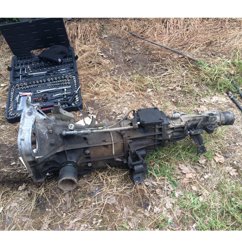

So I found a 5speed to swap out my 4speed what do I need to get to make it work in my car?? Need help ASAP!!!!

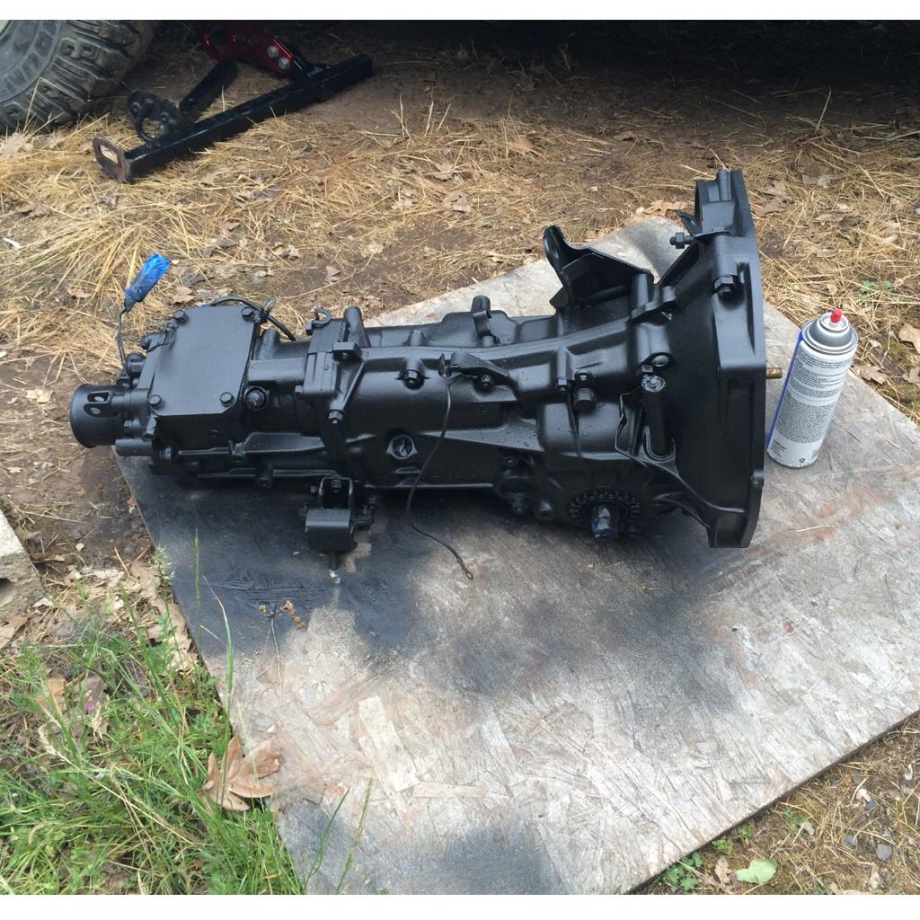

See what I got here! :)

You will need the shifter assembly, it is a plate that is connected to the trans with a rod, and then to the body with a stud/nut (of which the stud is already in your car).  The driveline, mounts and crossmember.
Jerry is the 5spd swap guru, look him up (bratsrus1) I am sure he will be able to tell you what I missed. (it has been a long time since I did my swap, and it was far from a standard install).
One huge recommendation though, while you have the new trans out of the car still, pop off the transfer output assembly, and clean up and weld the output coupling, then you will not have to worry about it going at an inopportune time (I was lucky and was off-road when mine went, and just had my wheeling partner drag me home).

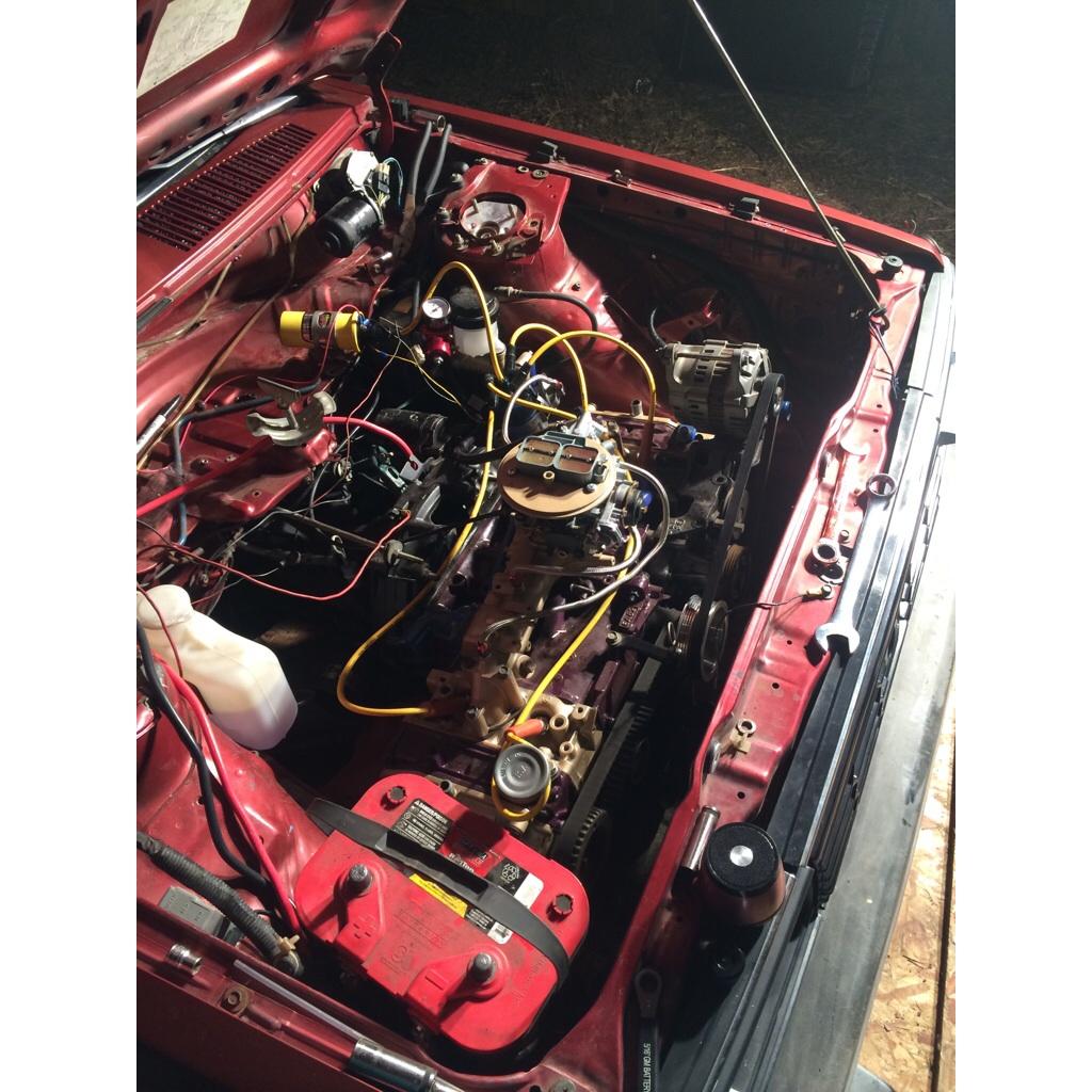

Alright guys I've got the motor swap and trying to get it running and I need help!!!!
I have the piston TDC, 1st cam timed and second cam timed.
Dizzy pointed at number 1.
Getting spark.
Won't start???
I don't know what to do am I missing something??
Coil hooked up, new plugs, wires, carb, gas, timing belts, oil pump, rings, pistons. New everything it's a fresh rebuild.

Looks like your #1 and #3 plug wires are wrong.    Disty firing order is 1-3-2-4      Starting with the #1 at disty being closest to the firewall.... then #3 is counter clockwise from #1.
#1 cylinder is front passenger side.    #3 cyl is rear passenger side.

I got that figured out and I have everything set on TDC, dizzy is on #1 all the plug wires are set, still won't fire.
I don't understand at all, starting to bag my head against the wall.
