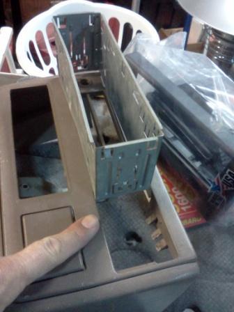

Dude. You just threw me into a mild stationary panic, wondering if my new JVC tuner would fit the dash of my '89 DL.
I ran and grabbed the DIN chassis and stereo receptacle out of the dash. It fits.

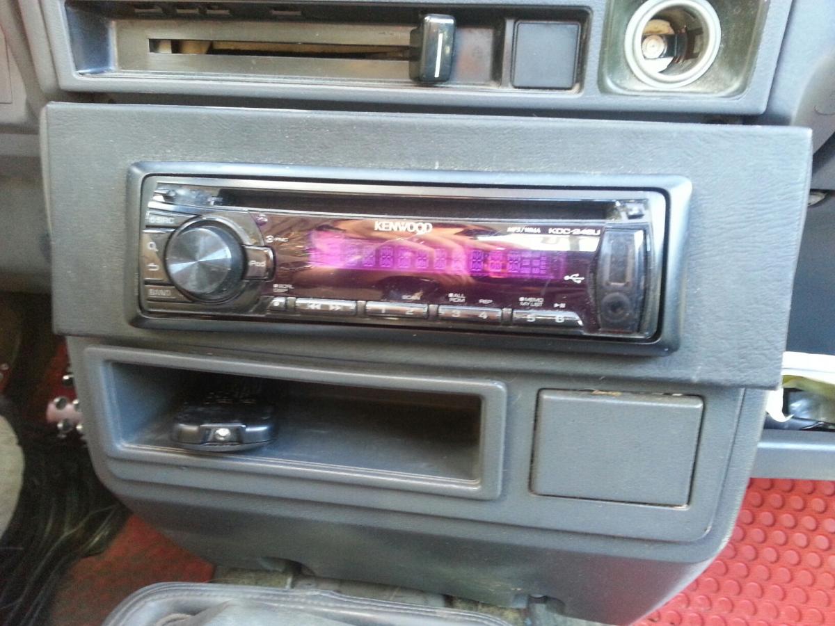

Posted 29 January 2014 - 02:41 PM
This is what mine is set up with.

I'm gonna have to do something like that...make a plate to cover the top of the console and cut a DIN hole. any issues with the depth?

#15 Dinky26
Dinky26
    ALWAYS LOOKING!
  • Gold Subscribers
  • 720 posts
  • Wichita KS
Posted 07 February 2014 - 10:07 PM
I'm thinking there would be more depth available if one was to put it at the bottom vs the top like mine is.
However mine is probably only on a 1/4" spacer behind the front plate.
