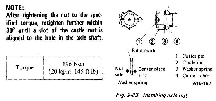

81EA81 Posted February 16, 2014 Share Posted February 16, 2014 (edited) To me it sounds like your cone washer is likely grooved or damaged in one way or another causing a loose fit against the hub allowing the axle nut to work loose. The cone washer is a type of lock washer that needs good clean surfaces to lock correctly. Similar to the bevel on a lug nut. You should also make sure the "Spring" washer has the convex side facing out. This could also cause the nut to work loose. Please view the attached info below. Good luck! Edited February 16, 2014 by 81EA81 1 Quote Link to comment Share on other sites More sharing options...

ARJ Posted February 18, 2014 Author Share Posted February 18, 2014 CONE WASHER IS IN THE RIGHT WAY ONE SIDE IS MARKED OUTER . DIDN"T PUT THAT MUCH PRESSURE ON BEARINGS WHEEL NUT AS TOONGA STATED I HAVE A TENSION WRENCH BUT CAN NOT FIND ANYWHERE THAT GIVES TENSION FOR WHEEL HUB NUTS . SHALL USE THE AHH F--K TIGHT METHOD ON THE NUT THANKS FOR HELP Quote Link to comment Share on other sites More sharing options...
