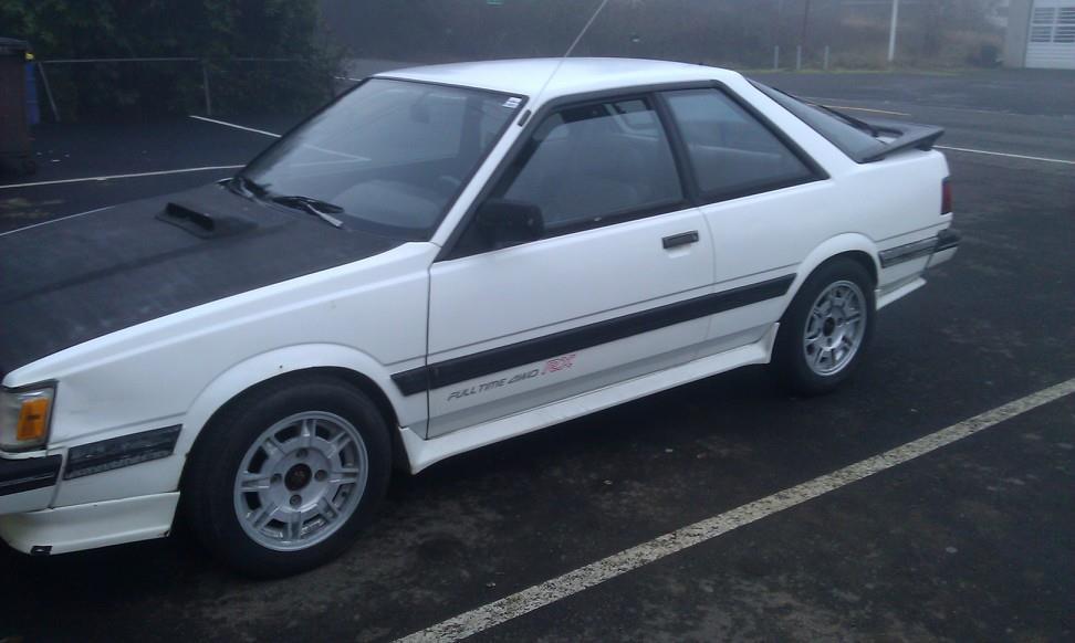

81EA81 Posted February 19, 2014 Share Posted February 19, 2014 Is this your car by any chance? I think it was recently impounded. Quote Link to comment Share on other sites More sharing options...
daddydongo Posted February 19, 2014 Author Share Posted February 19, 2014 yeah man that actually is my car. how do you know it? Quote Link to comment Share on other sites More sharing options...
81EA81 Posted February 19, 2014 Share Posted February 19, 2014 I just put 2 and 2 together from what has been posted here in the past. The car was owned by a fellow member johnw. He is from the Portland area and had an add up needing to sell it to pay lot fees. I wouldn't have guessed it If you didnt say you bought it off an impound lot,Its not the most common car to be hanging out in an impound Good luck Quote Link to comment Share on other sites More sharing options...
daddydongo Posted February 19, 2014 Author Share Posted February 19, 2014 thanks man i appreciate it. weird how small this large community can sometimes be. Quote Link to comment Share on other sites More sharing options...
turbosubarubrat Posted February 19, 2014 Share Posted February 19, 2014 The guy who owned this lives in Sandy and traded his 86 rx sedan for it from a teen not knowing how to get it running. So a long story short on how it got impounded he got pulled over for a loud exhaust and he didn't have insurance on it. Hopefully he pays me back when he has a chance for the rear part of the drive line on this and a grill but that's another story. Hope you get this going again it ran really good and strong when it was at my house about a month and a half ago. This does have the LSD under it along with the dual range awd trans. Quote Link to comment Share on other sites More sharing options...
