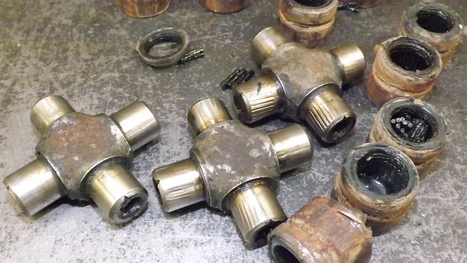

pontoontodd Posted August 11, 2016 Author Share Posted August 11, 2016 Did a bunch of things over the weekend. I'd noticed some backlash in the driveline after our UP trip, just a few times when downshifting and not matching the revs closely. Crawled under the car a while ago and noticed that the front u-joint was a little sloppy, middle one slightly, rear one felt fine. So I replaced the u-joints again, it's been about a year and a half. The front one was quite beat, I don't think it was going to break any time soon, but I'm glad I replaced it. They all had grease and I could have left the rear one in, but while it was out of the car I figured I'd do them all. I should probably grease those at least at every oil change. My friend brought over his headlight polishing kit. That was surprisingly fast and effective. He also put in an HID conversion kit I got for the main headlights. If these seem to be annoying to other drivers I'll switch back to halogen after the race. He replaced the MAF sensor with a new one, we're keeping the old one for a spare. I also got a new TPS but we were unable to get the screws loose on the old one so it's staying in for now. He also put our race radio in place of the CB. I didn't take any pictures but I ran the wiring for the tracker we need for the race so that should just clamp on and plug in. Again, no pictures, but we put new tires on the car and shipped the old ones to the pit service so they can have them at a few of the pits for us during the race. We'll be carrying the best spare in the car. Quote Link to comment Share on other sites More sharing options...
