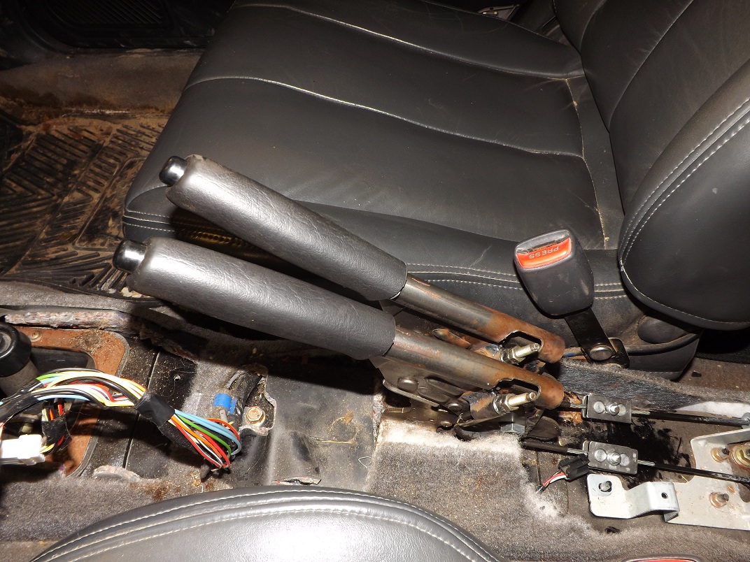

I tried the dual parking brake handle setup with disappointing results.  I think the rear parking drums are just too small to work as turning brakes.  Still considering hydraulic turning brakes.
Also tied the front bumper into lower radiator support, boxed in the tow bar points, and painted it.
Now that I've taken it off road a few more times, I'm really happy with the 1.5" lift.  It makes far more difference than I expected it would.  I would do it rather than getting mud tires if I had to choose.  It does well off road with the bumper covers on and all season tires now.
They don't work as turning brakes......But do work very well if you get a rear tire stuck in the air spinning like crazy.  Stop first.......set the handle then PUNCH IT.

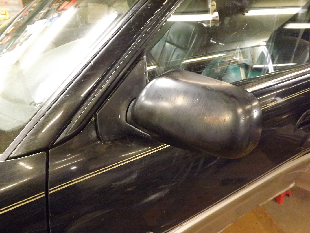

After breaking a few mirrors I finally found some folding Legacy mirrors, not exciting to most I'm sure:

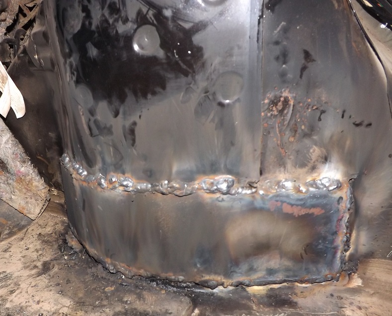

Also did some corrosion repair on the driver's side strut tower.  Should have checked that when I did the passenger side.

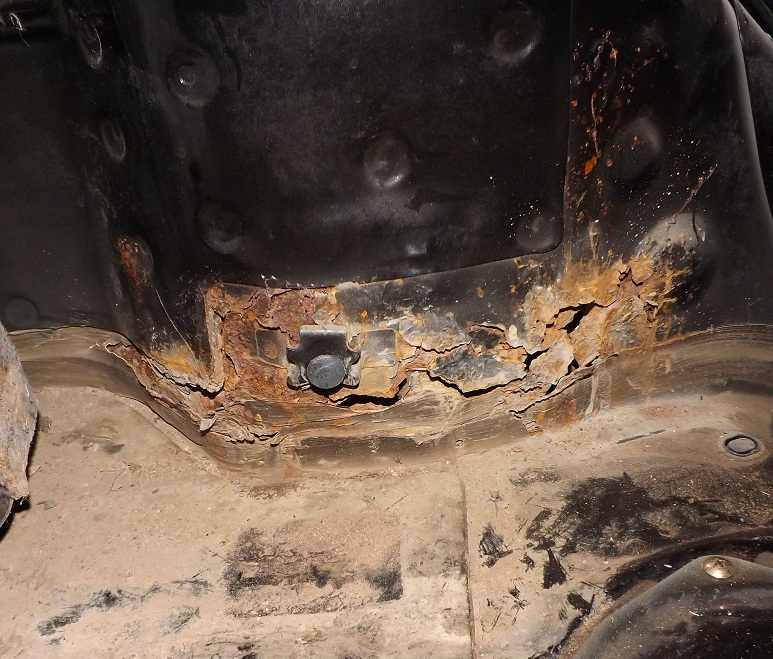

I recently noticed one of the rear subframe mounts was bent back and the captured nut was starting to pull out of the body.
I pulled the mount forward relatively straight with a come along, then removed it.
So I welded/bolted some tabs on the body to make a better mount.  The one towards the front of the car welds to a double seam in the body so it should be fairly secure.
New mount:
Did the same thing to the other side of the car to be safe, even though that side looked fine.
