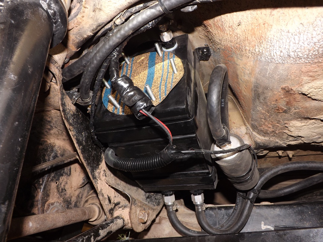

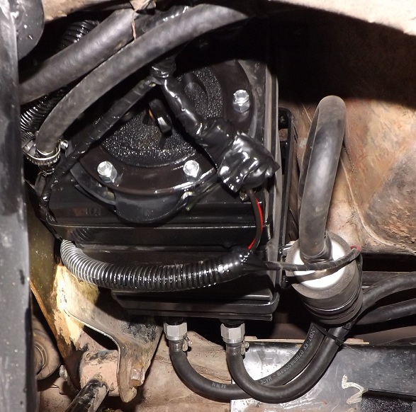

pontoontodd Posted July 27, 2015 Author Share Posted July 27, 2015 The main issue I've had since getting the Outback back together is that I can only put a few gallons at a time in it at the gas pump. I think it's mainly a matter of moving the vent fitting location on the fuel cell. I would still like to find a good diagram of all the vent hoses, carbon canister, etc. I drove it to a couple of our local testing grounds on Friday. Our local shock tuning expert thinks the front struts look much better than the a-arms. The biggest issue now is that it seems like the struts are sticky. He seemed to think we can overcome this at least partially through some shock valving changes, so we're going to try that and look into different greases and bushings. The next place I went to didn't do any damage to the car mechanically but at one point I was barely able to start the engine. The alternator was only putting out 11.5V. Fortunately my friend had a good used Subaru alternator there that we put on the car, bumping it up to almost 14V. He sort of owes it to another guy though so I'll have to figure out something there. On Sunday we went to the Badlands off road park. It was about 90F, humid, and no wind, so we were happy we had AC. Charged up the AC in the Forester in the parking lot before we hit the trails as a matter of fact. We drove the trails pretty hard for a few hours in our own cars, and then started switching around. The Outback definitely rode much better than the Forester and could go up obstacles we would not try in the Forester. In fact, we did a few things we would never have even looked at a couple years ago. The Outback's suspension might be a bit on the stiff side, we rarely felt it bottom out, but overall the ride quality was amazing.The Forester had much more wheelspin with its less aggressive tires and less articulation, which was entertaining sometimes and a hindrance at other times. It is really fun to drive and does great considering it's almost completely stock. The Outback kept running hot when we were not moving enough and had the AC on, but the Forester had no problems with the AC on all the time. Sometimes the Outback would be OK on temp, but a bunch of times it got pretty hot. We're thinking maybe the thermostat is sticking. The new guy we brought with who had never been to an off road park commented on the way home that he couldn’t imagine doing that without AC and couldn’t think of any other car that could drive 80mph for 250 miles, beat the crap out of it offroad for seven hours, and then drive it back home without ever wrenching on it. It's going to be a while before I can edit all the video we've gotten but it will be good. So here are my latest questions: What is the best grease for inverted struts for minimum friction? Should I get a reman alternator or get my old one rebuilt? Is there a new option? What is the best thermostat to get? I've noticed some are advertised as fail open, I thought they have all been made that way for decades. Quote Link to comment Share on other sites More sharing options...

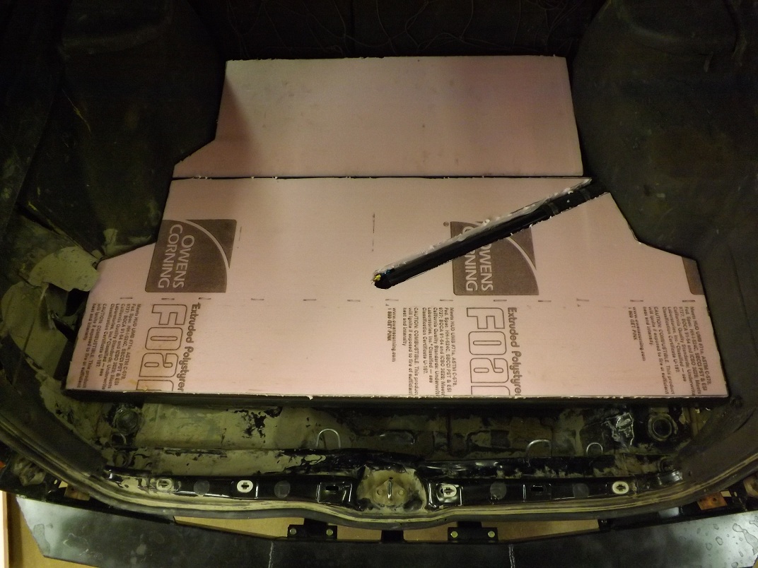

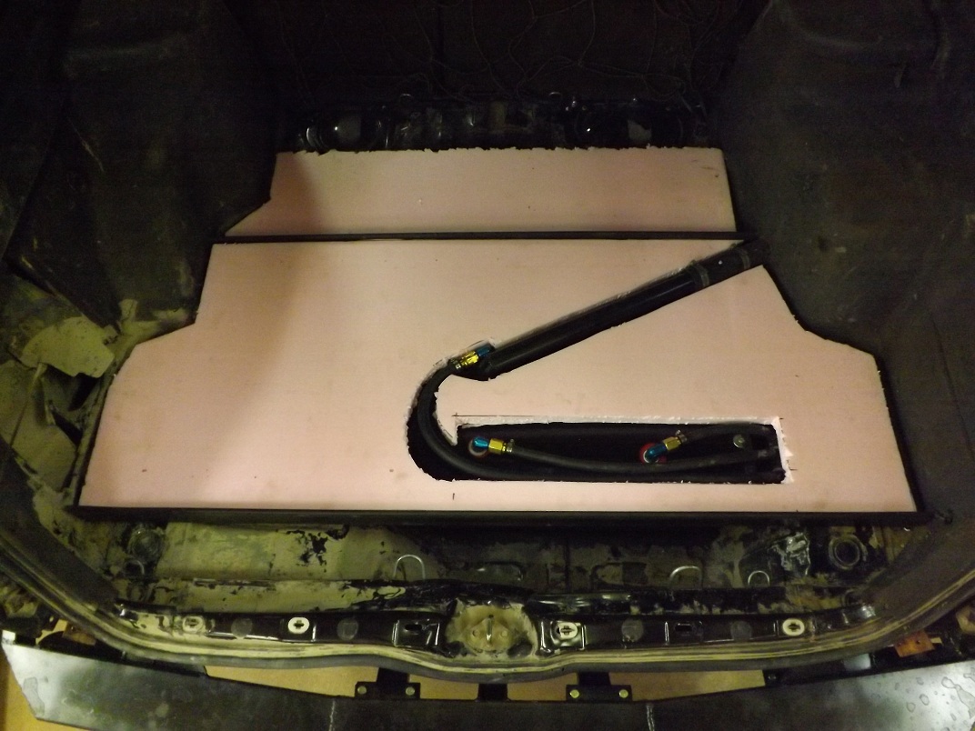

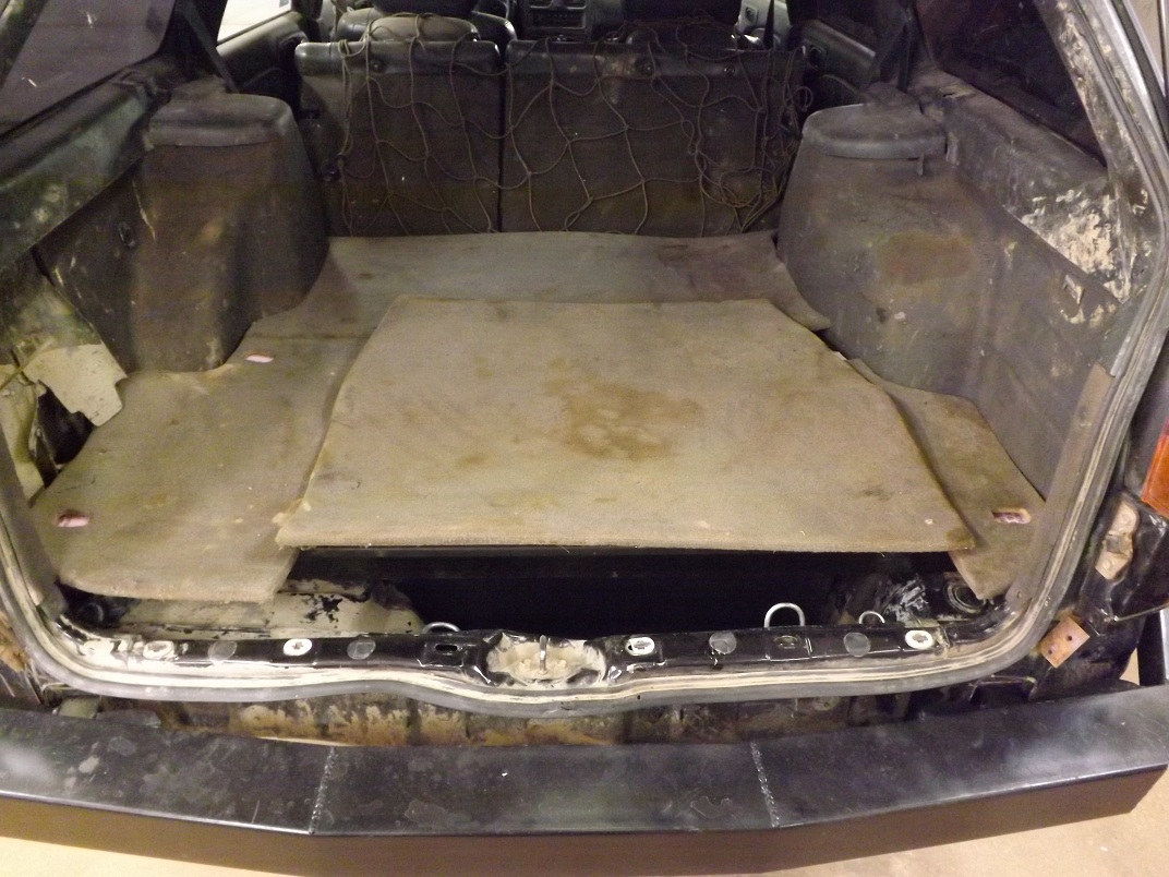

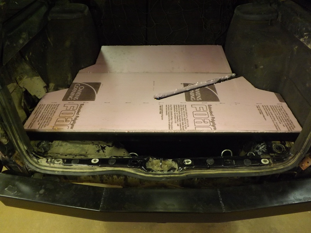

pontoontodd Posted August 11, 2015 Author Share Posted August 11, 2015 Here is how I did the fuel lines and the floor. Cut a few pieces of 1" foam to support the floor panels. With the stock floor panels set over the top. Eventually I'll make a piece of sheet metal to cover this with carpet glued to it. The stock floor panel that covers the spare tire is heavy. After I drove the car for a day, this happened. The gasket under the cap of the fuel cell is sagging out and falling apart. There were two gaskets stacked, not sure if that was normal or relevant to the problem. I'm sure this thing is normally mounted with the cap at the top but I'm disappointed the gaskets couldn't take pump gas for a day. Cut a piece of cork gasket to cover the entire hole. I have no use for a cap on the side. Made a steel plate to bolt over the top, welded three bolts to a split ring on the inside for easy assembly and disassembly. I'd really like to fit a bigger surge tank but I haven't found anything larger than these 1 gallon tanks that would fit. There are some wedge shaped four, five, and six gallon cells I've seen but I think they're too wide, not to mention expensive. Quote Link to comment Share on other sites More sharing options...

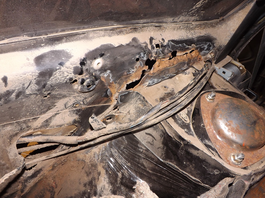

pontoontodd Posted August 18, 2015 Author Share Posted August 18, 2015 A little rust/fatigue re-repair on the LR strut tower after we got home. I had just welded this back together without adding material the first time. The other side had a larger gap so I'd added a strip of sheet metal and that seems to be staying together, so I did it on this side. Not very pretty or exciting, but it needed to be done. Still looking for longer tie rods and a bigger airbox if anyone has any ideas. Quote Link to comment Share on other sites More sharing options...

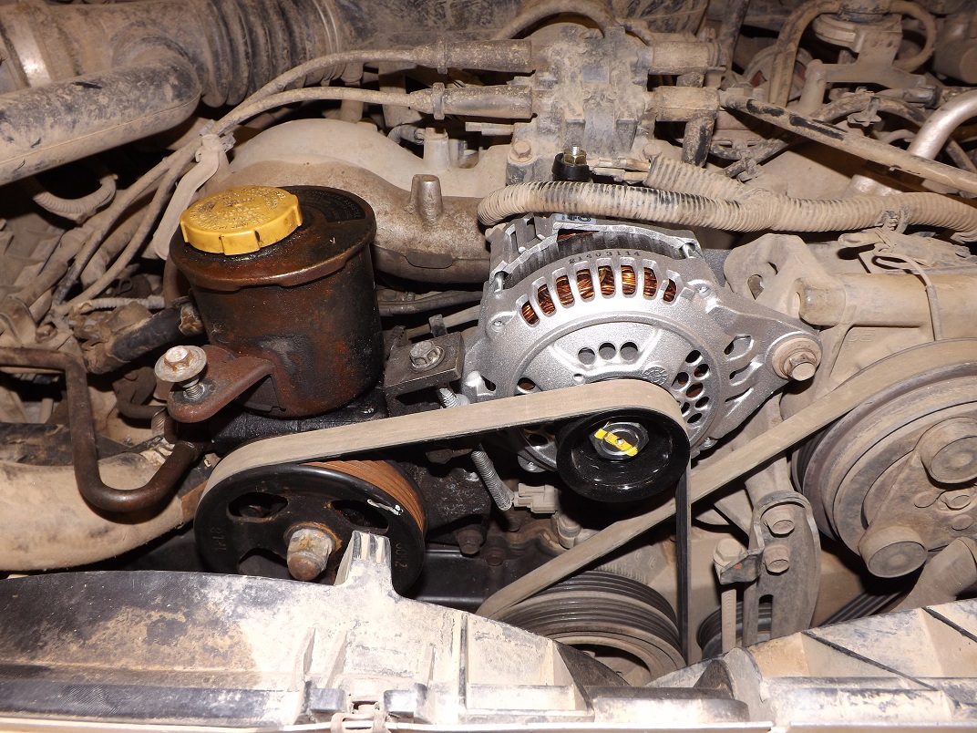

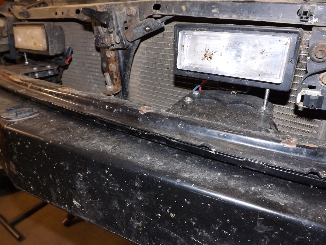

pontoontodd Posted August 25, 2015 Author Share Posted August 25, 2015 As mentioned earlier, replaced the alternator with a Subaru reman. Also swapped a different power steering pump on. The one that's been on the car offers very little assist at idle. This one is much better. I've had these KC lights on for a while now. They're a spot pattern and I put a set of cheap HID conversions in them. They have amazing range, probably 1/4 mile, but very focused. I have them aimed slightly to each side of center. One issue I had at first was that they would slowly drop down while off roading. I think after I cranked down the adjustment bolts they stayed put, but just in case I added these long bolts underneath so I can fine tune the vertical aiming and they won't drop down. These are wired into the fog lights since those died the first time we took this thing off road, but the switch and wiring were all conveniently in place. The HIDs even plugged right into the stock fog light plugs, although the polarity was reversed. The downside of that is that the fog lights only come on with the low beams, the opposite of what I want. I have seen how tos on making the fog lights work regardless of hi/lo beam switching, but I'd rather have them switch on and off with the high beams for highway driving. So I figured that out, fortunately the Haynes manual has fairly accurate color coded wiring diagrams of these circuits. Basically had to cut the yellow/blue wire from the fog light switch and splice a wire into the plug end of it. This is the pin looking at the wiring harness plug: - - - - - X Ran that to the plug for the hi/lo switch under the dash. Spliced into the red/yellow wire on that end. These pictures aren't very good but hopefully you get the idea. Now you can turn the HIDs on and off with the fog light switch and they only come on when the high beams are on. So, more questions: Anybody know where I can get longer tie rods? The ignition coil has been humming for a long time, I'm thinking I should replace it, and then I'd have a spare. Any brand better than any other? The biggest problem with the long travel struts is still that they are sticking. I think at least part of the problem is that the springs are inline with the strut rather than angled toward the contact patch. So I'm looking for some springs about 3.5 or 4" ID, 14" long, and 200#/in spring rate. Anyone know of a good spring size chart or a place that winds good springs for $50-$100 each? Quote Link to comment Share on other sites More sharing options...

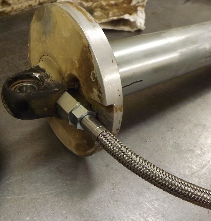

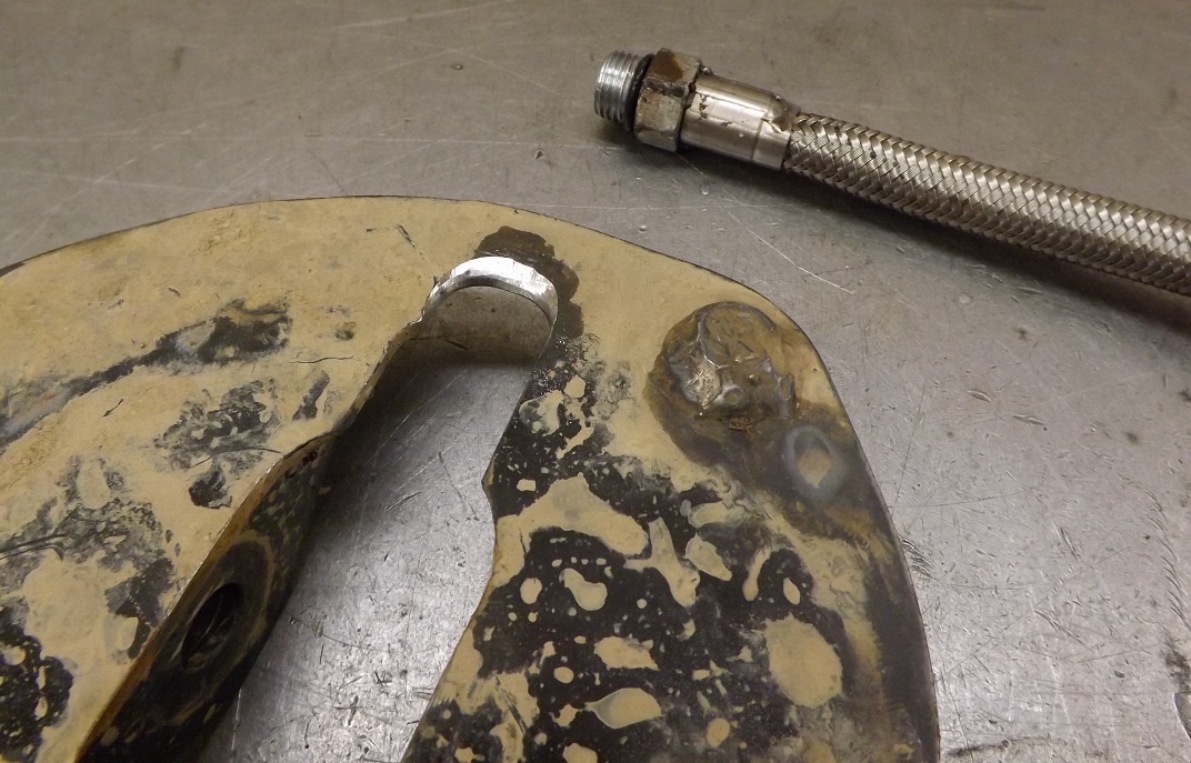

pontoontodd Posted September 2, 2015 Author Share Posted September 2, 2015 One of the issues we had the last time out with the long travel was that the hoses were getting crimped in the mounts in the front and leaking. Since the strut swings forward and back quite a bit when you steer, it was pinching the hoses. Slotted the mounting plates, got smaller hoses and adapter fittings, hopefully this solves the problem. Reinstalled with the smaller hose. You can see it is still a very close fit. Quote Link to comment Share on other sites More sharing options...

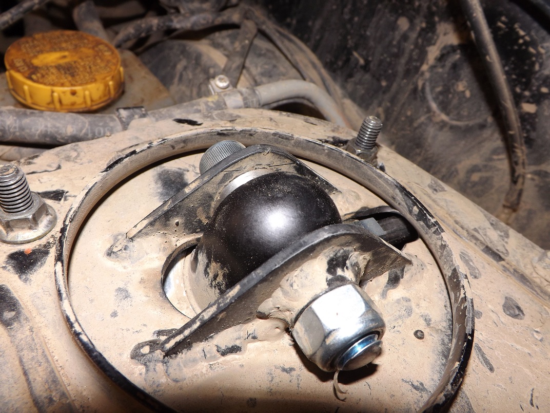

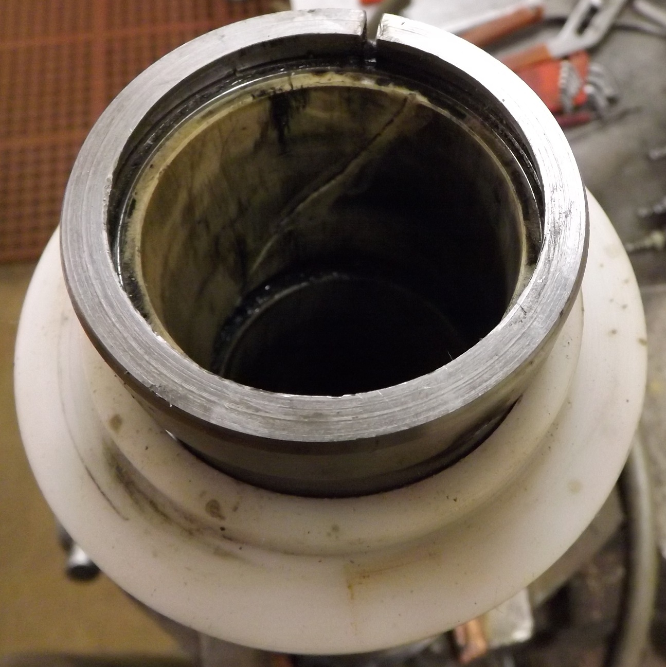

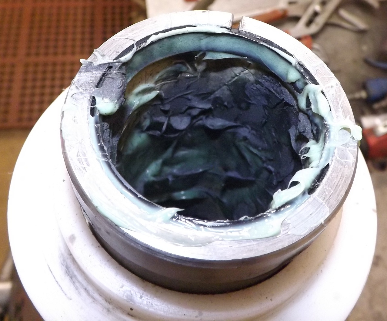

pontoontodd Posted September 9, 2015 Author Share Posted September 9, 2015 Tried this to solve the sticking problem. First cut spiral grooves in the bushings. Then installed the seals, packed with grease, and sprayed on some graphite: That didn't seem to make any difference. I have some larger OD springs I'm working on spring perches for that I can mount at an angle, hopefully that will reduce the binding. Quote Link to comment Share on other sites More sharing options...
