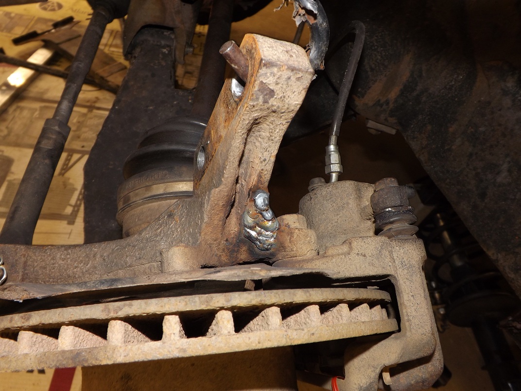

Scott in Bellingham Posted November 24, 2015 Share Posted November 24, 2015 What have you done to strengthen the front a-control arms? Quote Link to comment Share on other sites More sharing options...
pontoontodd Posted November 24, 2015 Author Share Posted November 24, 2015 What have you done to strengthen the front a-control arms? First I just added some square tubing to the stock ones. http://www.ultimatesubaru.org/forum/topic/144953-99-outback-build-advice-wanted/page-2?do=findComment&comment=1231150 That seemed to work but when we made the long travel I built new control arms to make them stronger and shift the wheels forward and out a little. http://www.ultimatesubaru.org/forum/topic/144953-99-outback-build-advice-wanted/page-4?do=findComment&comment=1270481 http://www.ultimatesubaru.org/forum/topic/144953-99-outback-build-advice-wanted/page-4?do=findComment&comment=1272393 Really we've only bent a couple of stock arms and every time it was when we clipped a big rock while going 10-20mph. Quote Link to comment Share on other sites More sharing options...

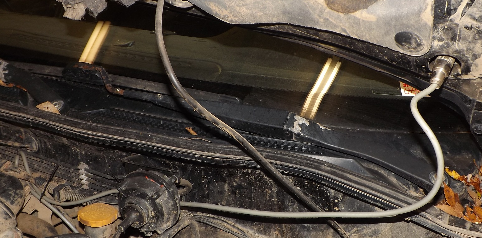

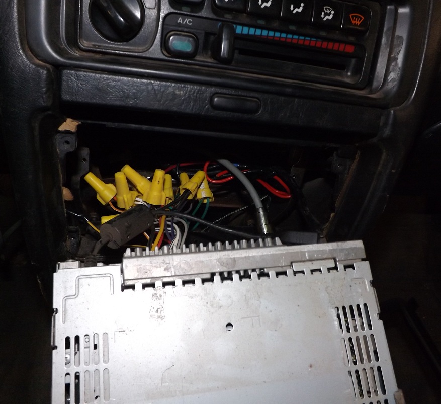

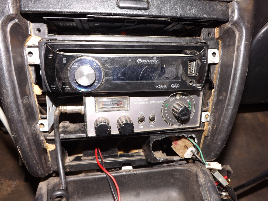

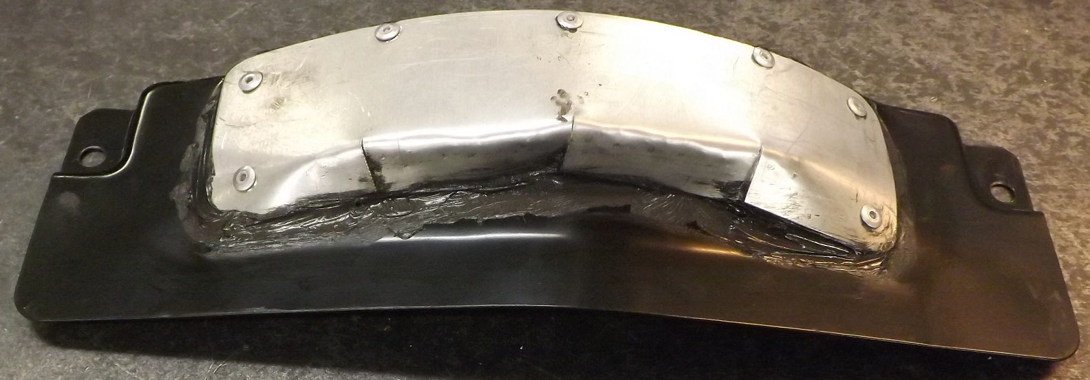

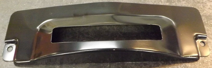

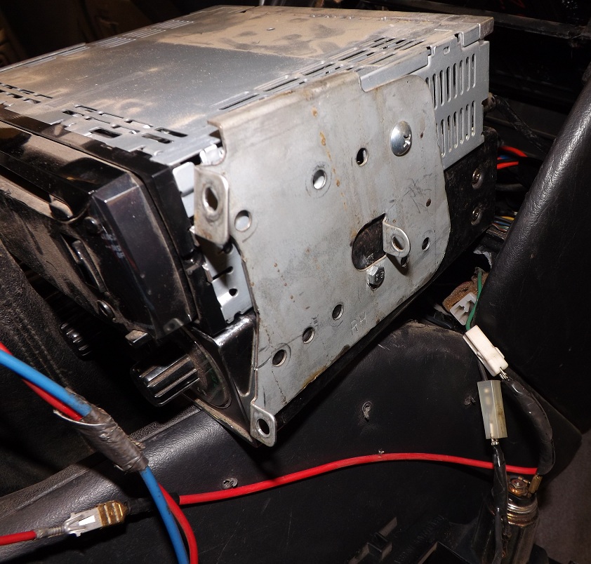

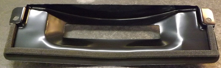

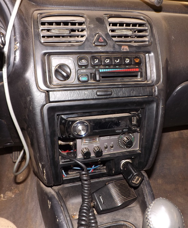

pontoontodd Posted December 2, 2015 Author Share Posted December 2, 2015 Had our old CBs checked out at a local CB shop. They were both OK but the antennas we had were both bad, which explains why they didn't work very well. Installed one of them in the dash of the Outback. I was happy with how well it fit below the radio. Here you can see the hack job the PO did on the radio wiring. Screwed in place perfectly. Just enough room for the mic cable to come out the side and towards the front. Don't have a picture of it but we screwed a mic hook just to the right of the radio so it's not just bouncing around the car. Antenna is mounted on the rear corner of the hood with a big washer underneath. So far it seems to be working great now, we had the other CB and a magnetic mount antenna I got on CL in the Impreza on our last trip. Very nice being able to instantly communicate with each other. Quote Link to comment Share on other sites More sharing options...

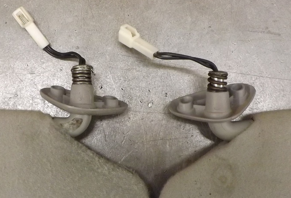

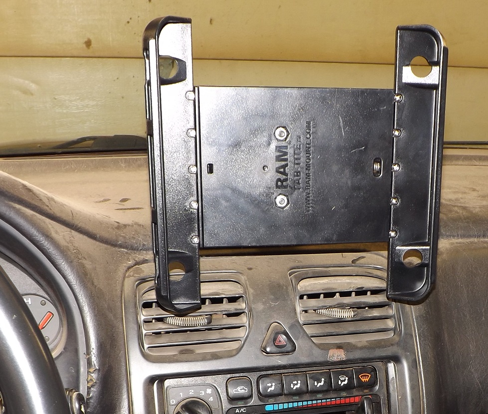

pontoontodd Posted December 8, 2015 Author Share Posted December 8, 2015 Got a different mount for the tablet (GPS) which is much more stable than the X mount I had. Mounted the visors to the cage since I had them and haven't found anything better. Tried adding friction to them by preloading the springs. This turned out to be pretty easy but didn't do much. I also mounted the brackets at an angle that had more friction than how they were mounted stock, but they still swing around when cornering. Quote Link to comment Share on other sites More sharing options...

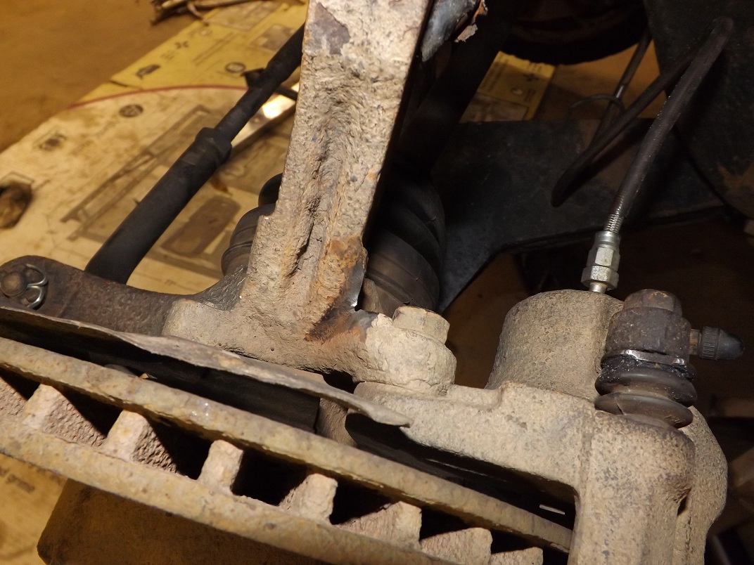

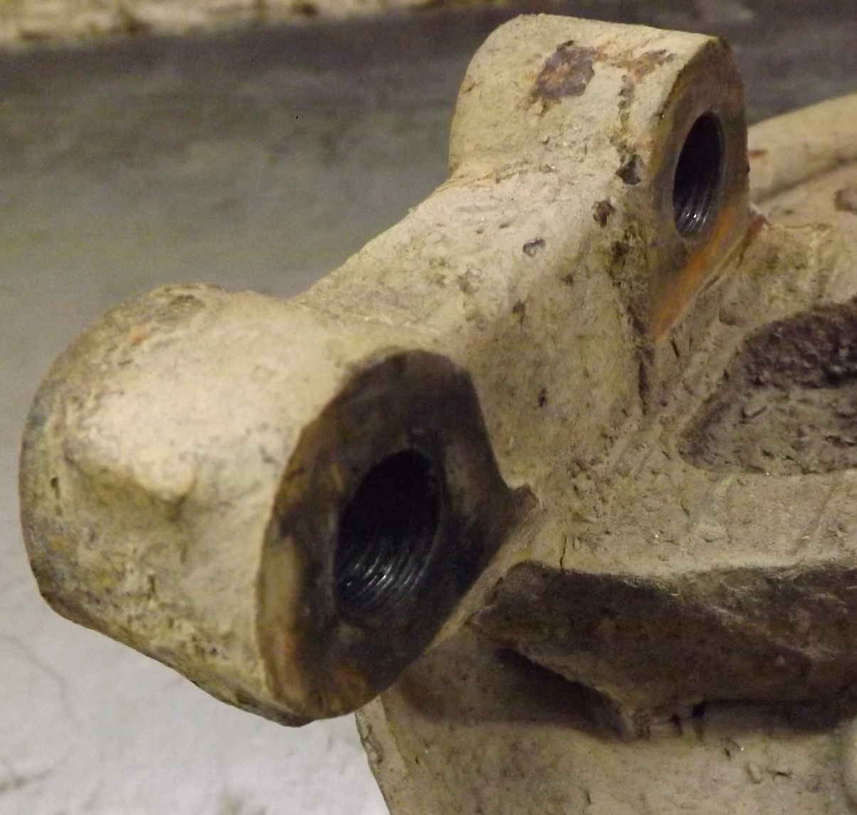

pontoontodd Posted January 6, 2016 Author Share Posted January 6, 2016 Replaced the rear diff recently, it was whining badly again. The one I'd put in a couple years ago was ancient though. I should probably change the oil in that occasionally. I've done some brake work and replaced a rear wheel bearing. Found a crack on one of the front knuckles months ago. It's near the caliper bolt head. Before I did anything else I test welded a plate on an old knuckle and couldn't hammer it off, so the weld seemed to hold. Ground out the crack: Welded it up and created a fillet: Couple months later I noticed that the other three spindles were cracked in a similar spot. So I did the same thing to them. Grind out crack, preheat, weld. So far I haven't seen any more cracks but we haven't done much offroading since then. Planning on heading to Texas next week to see how it holds up to a desert race. Quote Link to comment Share on other sites More sharing options...

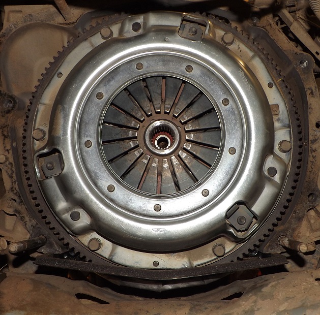

pontoontodd Posted January 19, 2016 Author Share Posted January 19, 2016 Found out a couple days before we left that the course in Texas would be five laps on a 50 mile loop (instead of a 20 mile loop). Still decided to go. We left town Wednesday morning flat towing the Outback with our truck. Somewhere north of Joplin MO we saw a giant shower of sparks and smoke in the mirrors. We pulled over and the Outback was missing the RR wheel. Three of the wheel studs were broken and one of the other two was bent. I assume the lug nuts all came loose somehow, at least two fell off, and the rest were loose enough to eventually snap. The pavement had ground at least a half inch off the bottom of the knuckle. It was cold and dark and we clearly couldn’t move the car until we did something about this problem. At that point I thought we’d have to get the OB towed somewhere and either go home or continue without it. Fortunately I had brought a new rear hub so we knocked the studs out of that and got them in the old hub after taking the brake disc off. We strapped the trailing arm to the knuckle so the bushing wouldn’t fall out the bottom, put a wheel and tire on and continued our trip. For the rest of the trip every time we torqued the lug nuts on that corner they turned some before being tight. We were torquing to 80 ft-lbs and later one of our friends said we should be going to 95 ft-lbs. The next morning we picked up more lug nuts and wheel studs at two parts stores. When we got to the pits at the top of the hill, we could look out and see flat desert for miles. It was clear why the closest town is called Notrees. Fired up the generator and cut a few pieces of steel to weld to the bottom of the knuckle on the OB, pressed the bushing back in, and put a different trailing arm on it. Everyone crapped their pants when they realized we were planning on racing the OB. They thought it was great. They also had no idea what class it would be in. I had figured class 10 (four cylinder water cooled) or heavy metal (stock frame rail truck) but they thought air cooled might be more appropriate speed wise. Before 2PM people started pre running so we got suited up and went out on course. I drove and one of the guys we've raced with navigated for me. With his help I was able to follow the course. About ten miles in the coolant temp started creeping up and eventually got to about halfway between the middle and the top. We pulled over and found out one of the cooling fans wasn’t working. We stuck the windshield washer pump hose in front of the radiator. Then every time it started climbing I would hit the washer pump and it would go back down. They had the course laid out so you went by the pits at mile 17 so we stopped. We figured out one of the pins on the connector for the fan was bad so I spliced a wire around it and then they both seemed to stay on. We went back out and continued the course. The temperature was much more stable but would occasionally rise a bit above the middle of the gauge. Our friend who works on rally cars says when they lose the front bumper cover they will overheat, so he thinks that's our main problem. Around mile 40 something was slipping in the OB drivetrain but we didn’t see or smell any clutch smoke. I pulled over for about five minutes to let it cool but the problem persisted. Had to limp the rest of the course at about ¼ throttle to keep the clutch from slipping. It took us about 2.5 hours in the OB with all the stops and taking it easy at the end. I think it was about 1hr 40 minutes of driving time. The fastest trophy trucks and buggies run about an hour, the slower baja bugs and 1600 cars run about 1 hour thirty minutes. With a non slipping clutch and a little practice we should be able to run 1 hour 30 minute laps. We had no good way to fix the clutch or trans so we just checked over the suspension and focused on our buggy the rest of the weekend. Everything on the suspension looked good, knuckles aren't cracked, no loose bolts, etc, so I was happy with that. We burned about five gallons of gas running 50 miles. The guy who rode with me told me it was similar to his 1600 buggy. He was surprised a few times with how well it soaked up the rough terrain. The course was a lot of fun. There were a lot of rough sections and tight sections but also many straight sections that were miles long. Some of those were super smooth, others rough enough that we only went 30 or 40mph in the OB. On the first wide, smooth, long straight there were berms roughly perpendicular to thedirection of the road but they were about the size of speed humps, fairly short and rounded. We were hitting those at 40-50mph in the OB and getting a little air off some. We were coming up on another one and realized at the last second it was a ditch, maybe two feet deep and twenty feet wide. I think I mostly cleared it but it sent the OB flying and we were both amazed it didn’t seem to do any damage. There was one section, I think along a powerline, with ruts that must have been at least 18” deep. We were able to straddle them in the OB or we probably would have gotten stuck. There was one steep rock face with a sharp transition at the bottom thatI hit a little too fast in the OB. Yesterday morning we pulled the trans out of the Subaru and discovered the pressure plate was packed with grass. The fingers were almost flat and the bolts didn’t have to unthread very far before they had no tension on them and the fingers didn’t move up much. We clamped the fingers down using a big toggle clamp and socket and blew/picked all the grass out. Then the fingers sat up at an angle. Disc looks good. Definitely have to get/make a cover for the bottom of the bellhousing. We got some good video so eventually I'll edit that and post it. We are considering going back to their next race in April. Any thoughts on bellhousing cover or our overheating issue? It sounds stupid but I would like to be able to run the AC, it gets hot in suits and helmets in an enclosed car. 1 Quote Link to comment Share on other sites More sharing options...
Cyfun Posted January 20, 2016 Share Posted January 20, 2016 (edited) That's a pretty sweet story, especially with you losing a goddamn wheel, fuxing up your hub, and happening to have the spare parts to get back on the road. I would have thought that your brake disc would be fucked for sure. Pretty ballsy not using a full car-hauler for any offroad activity in general. Next time, might be worth at least getting a u-haul, but I would think you could find a friend who would let you borrow one. Otherwise, might be worth investing in a trailer yourself. If you keep an eye out, can pick up a 16 footer for as low as $1500. At that price, you can always sell it for what you put into it. In fact, I have one I'd sell you for $1500, as it's kind of light weight and not good for hauling anything beyond snow mobiles or Japanese cars. I'm surprised you don't have some sort of skid plate that extends past your bellhousing. Perhaps that would be the best solution. As for your overheating, are you 100% positive it's a cooling system issue and not a headgasket issue? In any case, sounds like a badass course. I'm honestly curious how many people ran out of fuel halfway through. Edited January 20, 2016 by Cyfun Quote Link to comment Share on other sites More sharing options...
ferp420 Posted January 20, 2016 Share Posted January 20, 2016 If you get a small bolt and drill a hole next to the rod on your visor you can use 2 washers or something to clamp the visors down just don't over tighten them or you will bend the inside of the visor I've even gone as far as using wood panalung mounted to the factory brackets with them clamped like that they work great for off road or any older rigs Quote Link to comment Share on other sites More sharing options...

pontoontodd Posted January 22, 2016 Author Share Posted January 22, 2016 If you get a small bolt and drill a hole next to the rod on your visor you can use 2 washers or something to clamp the visors down just don't over tighten them or you will bend the inside of the visor I've even gone as far as using wood panalung mounted to the factory brackets with them clamped like that they work great for off road or any older rigs Sounds like a simple solution, might even just be able to use one of the three bolts already holding it in. Wasn't a problem last weekend. Quote Link to comment Share on other sites More sharing options...

Uberoo Posted January 28, 2016 Share Posted January 28, 2016 We've never had to tow any of our Subarus home after years of beating on them offroad. Again, not saying it won't happen, just doesn't seem to happen often to us. I will see if I can borrow the tester that goes on the radiator from a parts store. I have compression and leakdown testers but they would be a PITA with this engine. I do keep thinking about the H6 swap but I think if the engine came out I'd just do rings, bearings, head gaskets, and get a low end profile ground on the cams. At this point I'm just waiting and saving for a third gen OB so I could get the H6 and bolt on wheel bearings. Each lap is about 47 miles long. The race is five laps, so almost 250 miles. There are certain failures offroad that can't be planned for, that require vehicles to be towed home.The very same day that the pic in my sig was taken I blew up the engine in my hatch,and while towing it home the rear diff grenaded on a steep/narrow mountain road. Ive also had lug nuts come loose and shear off all the lugs.Ive blown 2 tires when I only had a spare,etc.Its alot less fun to hike 30 miles back home than it is to hike 3 miles to your tow rig. Quote Link to comment Share on other sites More sharing options...
Cyfun Posted January 28, 2016 Share Posted January 28, 2016 There are certain failures offroad that can't be planned for, that require vehicles to be towed home.The very same day that the pic in my sig was taken I blew up the engine in my hatch,and while towing it home the rear diff grenaded on a steep/narrow mountain road. Ive also had lug nuts come loose and shear off all the lugs.Ive blown 2 tires when I only had a spare,etc.Its alot less fun to hike 30 miles back home than it is to hike 3 miles to your tow rig. Exactly this. Hell, doesn't even have to be anything serious. Two flat tires will do the trick nicely. Or more common with our cars, CVs will esplode, or radius rods will get bent. Not to mention that if you drive or flat-tow your offroad rig somewhere, you're putting that much more wear and tear on your tires, wheel bearings, axles, diff, and so forth. And it's not so bad with our cars, but a set of tires on a lifted offroad rig can cost more than a whole trailer, which is why many folks who own such vehicles avoid driving them on pavement more than necessary. Plus, trailering makes it easier to get away with welding your diff. Quote Link to comment Share on other sites More sharing options...

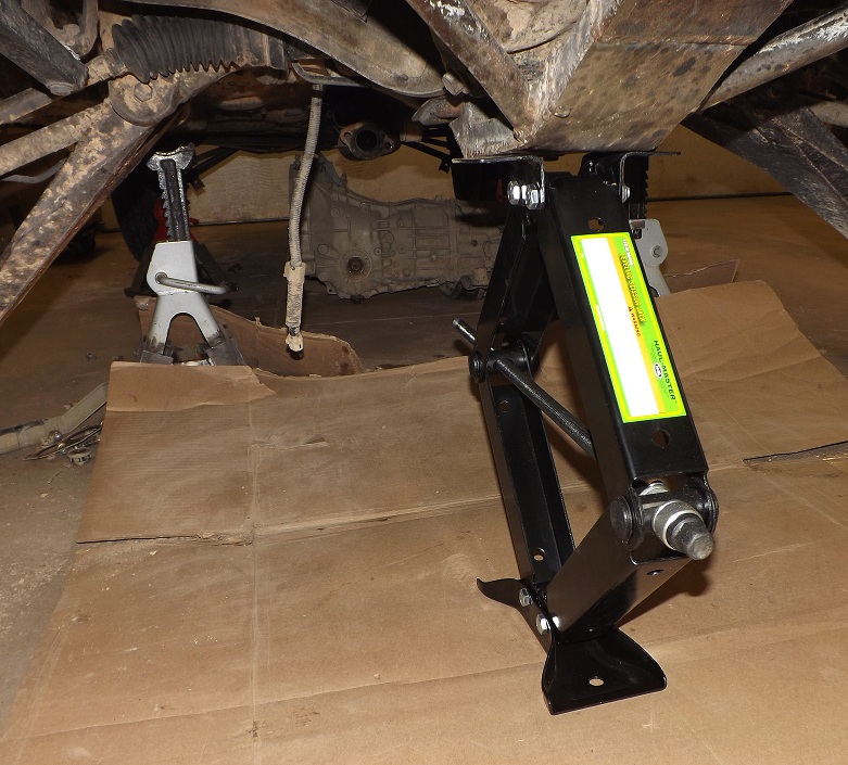

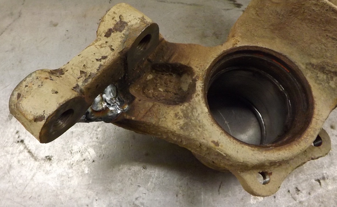

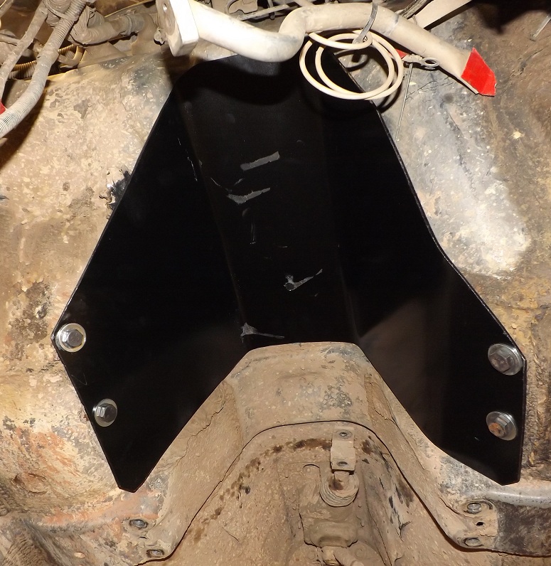

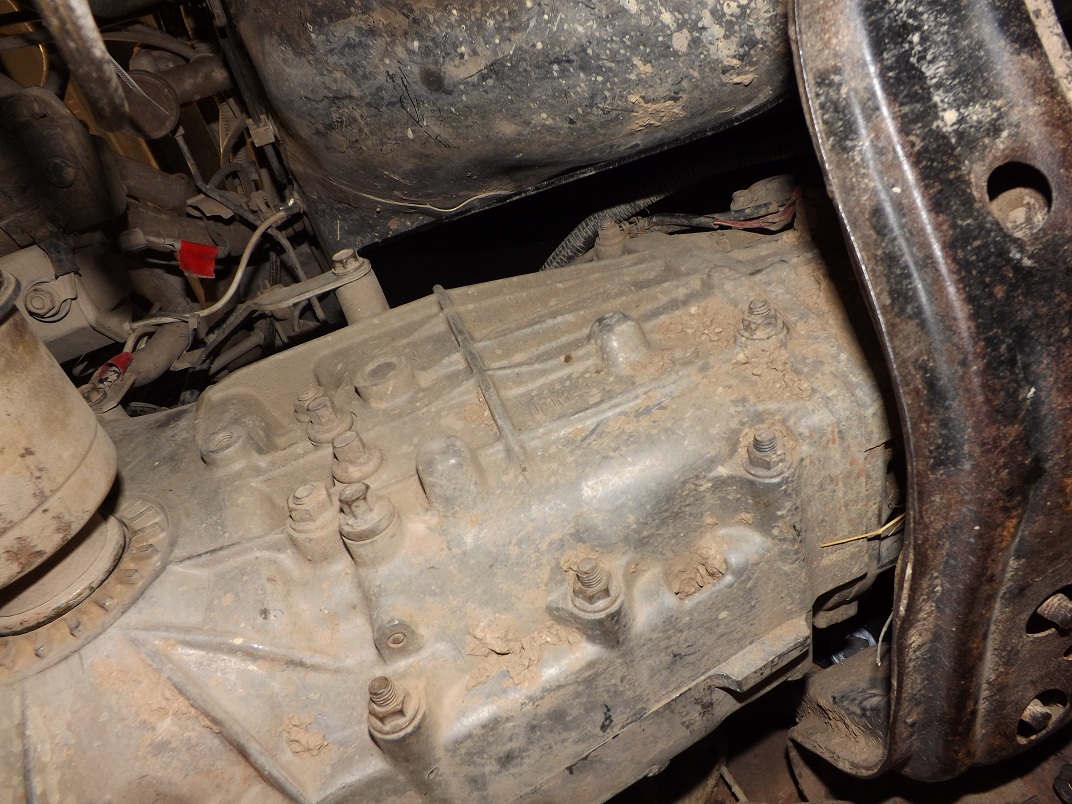

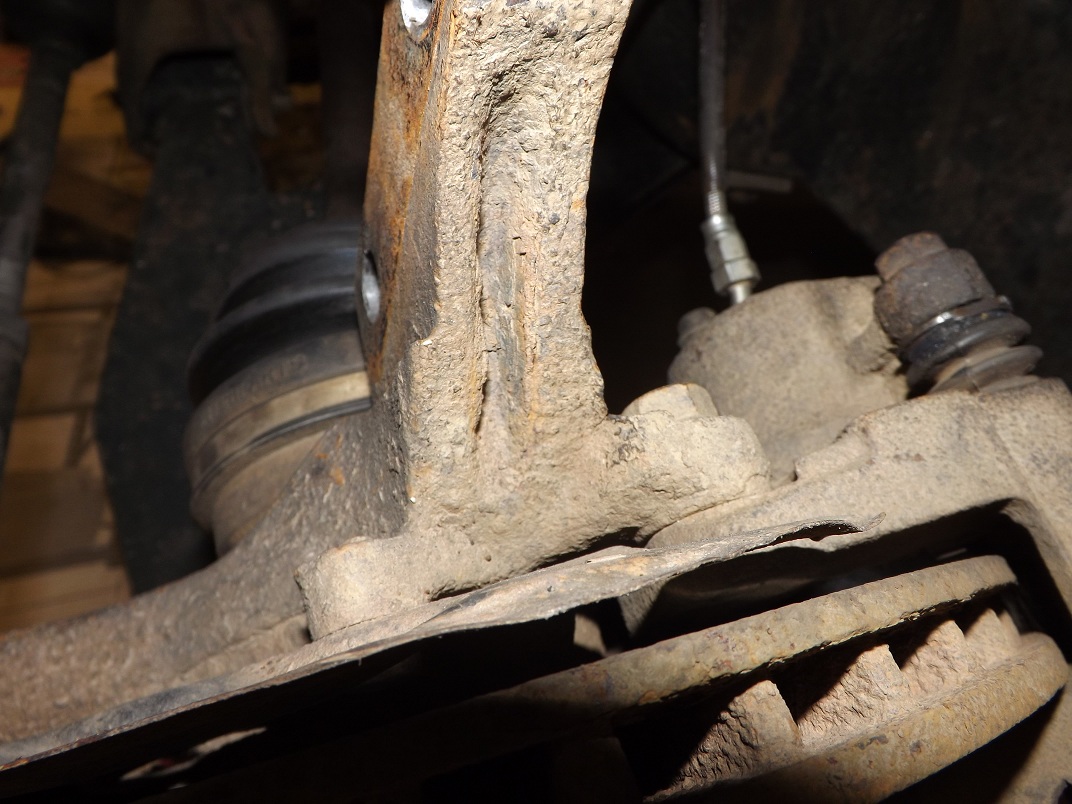

pontoontodd Posted February 2, 2016 Author Share Posted February 2, 2016 Working on replacing the RR knuckle we had to repair in TX. I had another one from a parts car that to my knowledge was not abused at all. It had a small crack in it at the base of the strut mount just like all of mine did. Ground it out and welded it up. Got the old one off the car which was a PITA since the long bolt had rusted into the front bushing. I know I've had it out before and anti seized it but I still wound up wrecking the bolt getting it out. So I'm waiting for one of those. Anyone know of a stainless and/or high strength replacement for those? Or some other solution, such as RTVing that central pocket so it won't rust as quickly? Got this scissor jack from Harbor. It's 2.5 ton and meant for leveling trailers. Relatively light, fast and low effort and lifts about 24", more than enough even with the long travel. Can use a cordless impact for more speed, it's even 19mm hex like the lug nuts. Just have to find a good place to put it in the car and do something with the top and bottom pads. I got a dust cover for the bottom of the bellhousing from the dealer for $7. Unfortunately there is a giant window in the bottom of it??? So I cut, bent, riveted, and RTVed a piece of aluminum sheet metal on the bottom of it. Not pretty but it should keep the grass out. It also doesn't cover the notches in the engine block on either side of the flywheel. So I RTVed those too after I bolted it in. Here is a bad picture of it installed. While we had the trans out we made a scattershield for the trans from 1/8" 4130. They don't care in TX but we'll need it for BITD (Vegas to Reno). Quote Link to comment Share on other sites More sharing options...

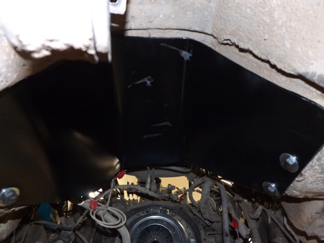

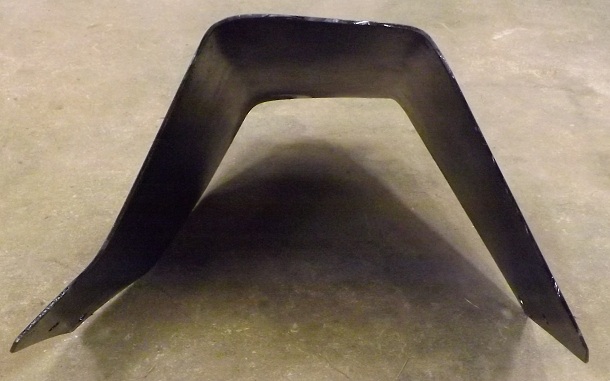

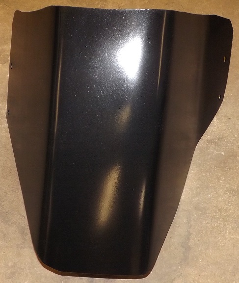

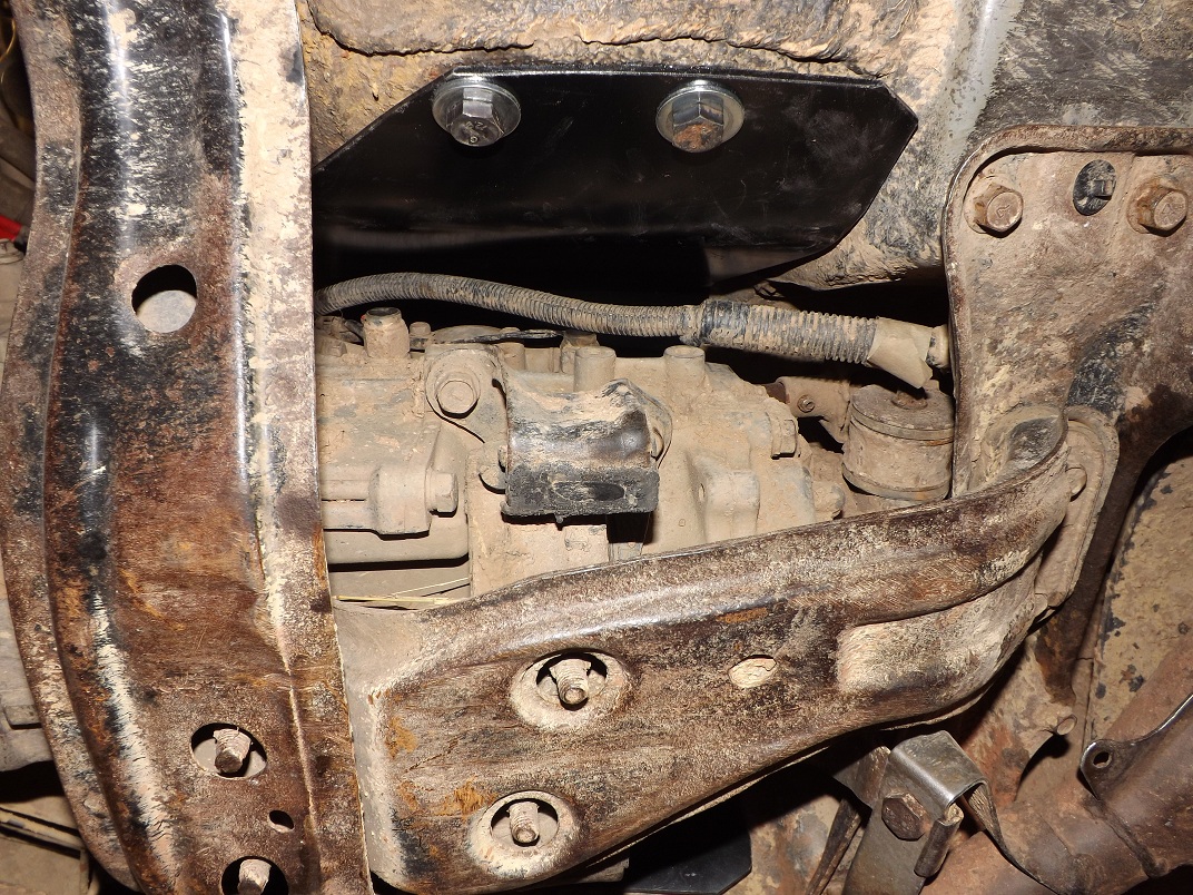

Uberoo Posted February 2, 2016 Share Posted February 2, 2016 Shouldn't the scatter shield be covering the parts most likely to blow up?Namely the flywheel and the clutch. Your scatter shield needs to curve up the firewall, and or, angle toward the engine to be effective. Or do tailshafts have a habit of blowing up and no one has bothered to tell me yet?Cool looking just seems like useless added weight without covering the parts most likely to blow up. Quote Link to comment Share on other sites More sharing options...
pontoontodd Posted February 2, 2016 Author Share Posted February 2, 2016 Shouldn't the scatter shield be covering the parts most likely to blow up?Namely the flywheel and the clutch. Your scatter shield needs to curve up the firewall, and or, angle toward the engine to be effective. Or do tailshafts have a habit of blowing up and no one has bothered to tell me yet?Cool looking just seems like useless added weight without covering the parts most likely to blow up. Yes, it would make more sense to me to cover the flywheel and clutch. They want it covering the part of the trans with gears. I have never heard of the gears in a Subaru trans exploding but those are the rules. Also, it's hard to tell from those pictures but it does go forward to the firewall. Quote Link to comment Share on other sites More sharing options...
